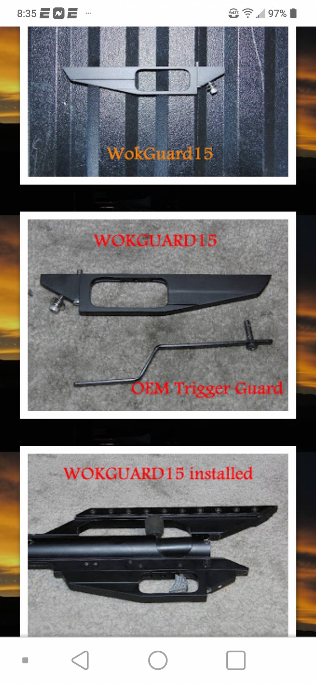

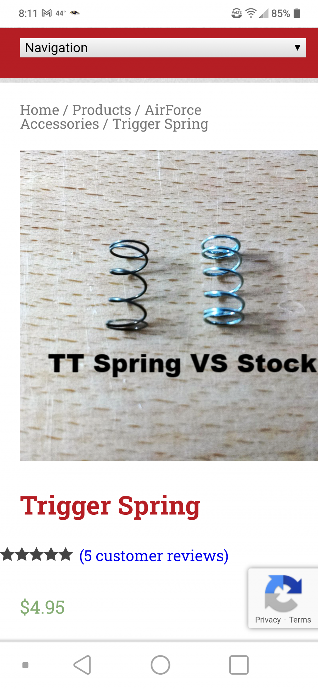

Before you get to deep in the rabbit hole with modding you condor, a few things to consider. The gun has 2 areas that need attention. First the frame need more support. The most reasonable way is with a wor guard trigger guard from Tony. Next the trigger need work. Lighter trigger springs from Tony. For the top hat, again Tony or air force has nice unit. You can spend tons of money modding but you will be fine with your intended use with what i suggested. A good supply of pellets/slugs and have at it. You will be fine.

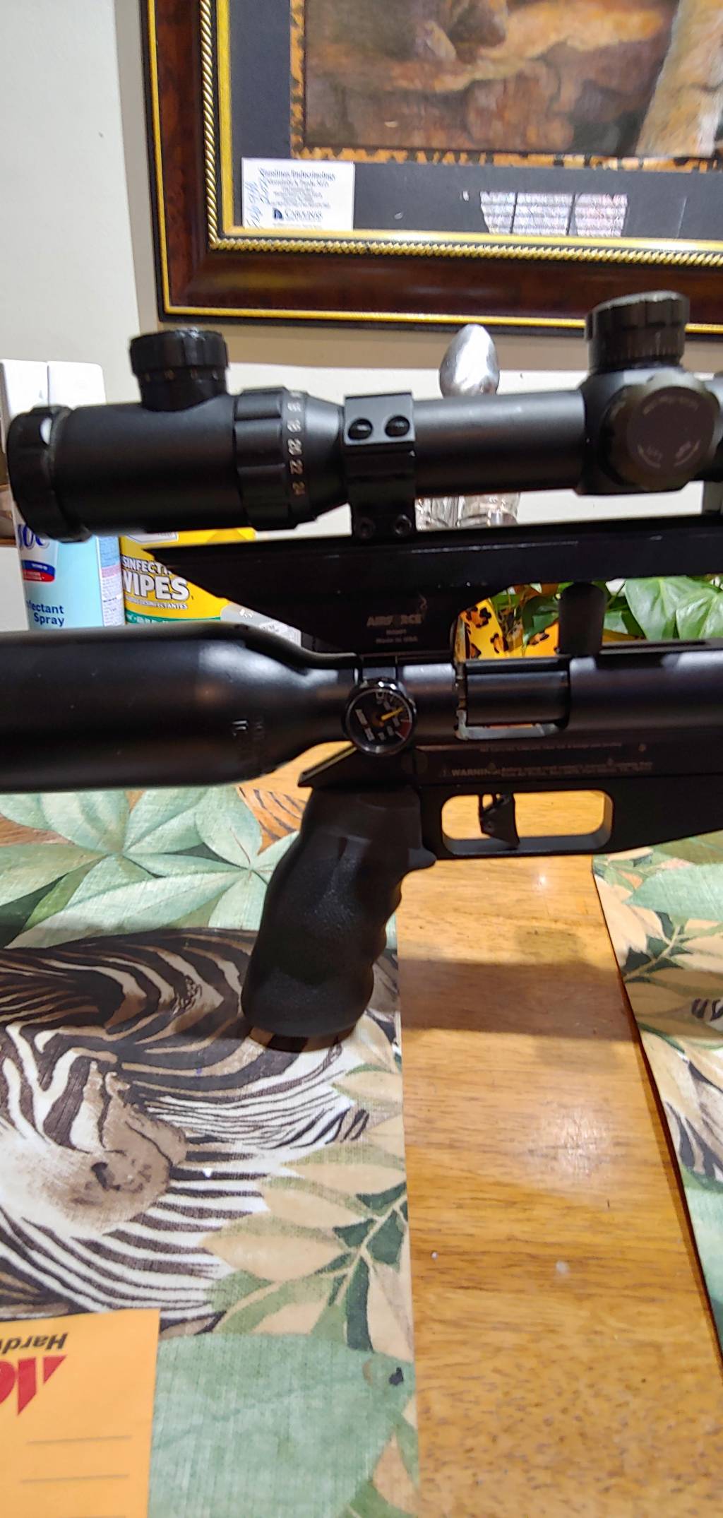

what grips work on Condor
as far as i know only the OEM airforce grips.
the wok guard that shambozzle and others have recommended allows you to install a standard ar-15 grip, while also stiffening the frame.
i would recommend tony/talon tunes products over the ebay, or similar custom airforce shops. shipping time has been sporadic, but i am assuming its due to him being pretty busy with holidays/new releases.
i've got an assortment of talon tunes / other products / ebay frankensteined into my airforce, and the talon tunes stuff stands out IMO quality wise
