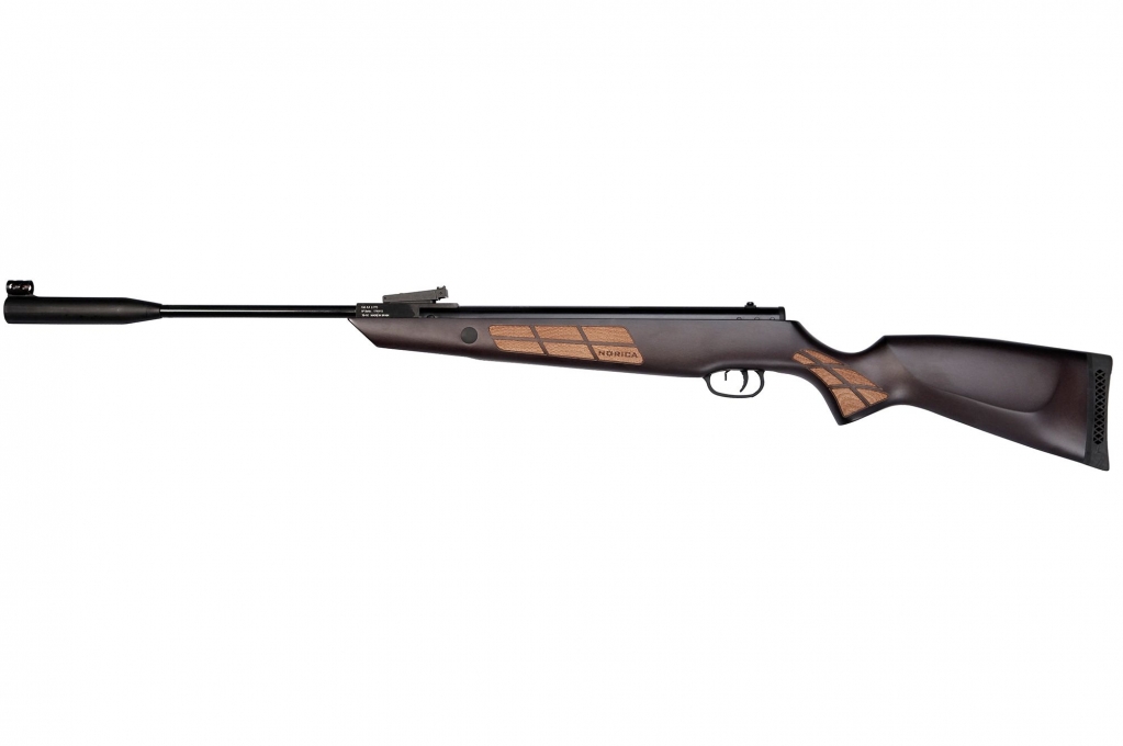

Norica Black Eagle Air Rifle
For $91 imho this is the best deal out right now,Norica's build quality is above all the other low to mid price rifles out now. I can't recommend Hatsan, the last couple 95's I have here have QC issues, check the turkish forum at airgun gate
https://www.amazon.com/gp/product/B0142BHT6A/ref=ppx_yo_dt_b_asin_title_o01_s00?ie=UTF8&psc=1
https://noricaairguns.com/product/norica-black-eagle/
