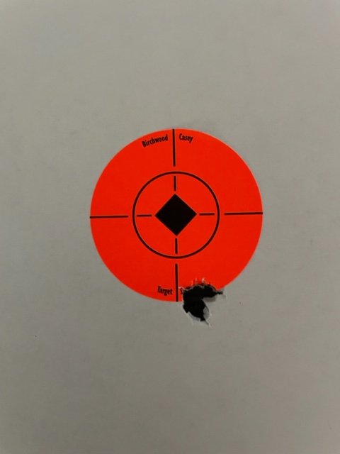

It may shoot good down to 1900 or 1850 I don't know yet. Didn't want to go too far down I have to fill up with a hand pump. And my setup sucks not a stable bench it's a little 3 foot diameter round table off the porch, but I did get one good 10 shot one holer with the Benjamin 14.3s at 20 yards.

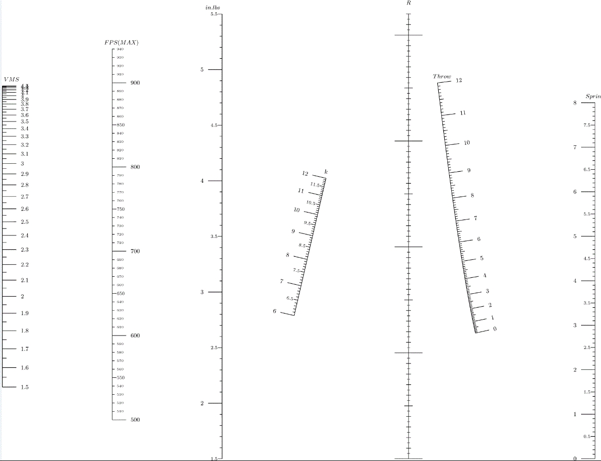

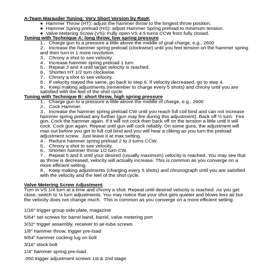

I would first get back to factory settings, see pic, but i bet you have way more shots in there and its not up to speed at that pressure point and tune. Then record a string from like 2900 down to about 1800, paying attention to the pressure at the apex of that curve. From there, follow the A-team tuning link below, prob the best way to describe tuning an mrod. The Nomograph is a solid reference for power levels but not efficiency. The o-ring mod is an air saver too, but clips power some. I find the factory tune is hardly the best but is the best place to start.

Thanks for the info. I'm assuming the numbers where it says 1.25 for the "hammer tension" is one and a quarter turns in from backed out all the way? And is the "transfer screw" what the manual refers to as the metering screw?
Correct on both accounts. The metering screw is actually two screws, one is a cover for the other, the internal one is the adjustment. Unless the gun has been messed with and tuned already, its prob is still at factory setting. One thing i found is the hammer spring is best adjusted when cocked.
Also, the nomograph is for .25, not .22, forgot to mention that. but it shows the relationships of the adjustments.
