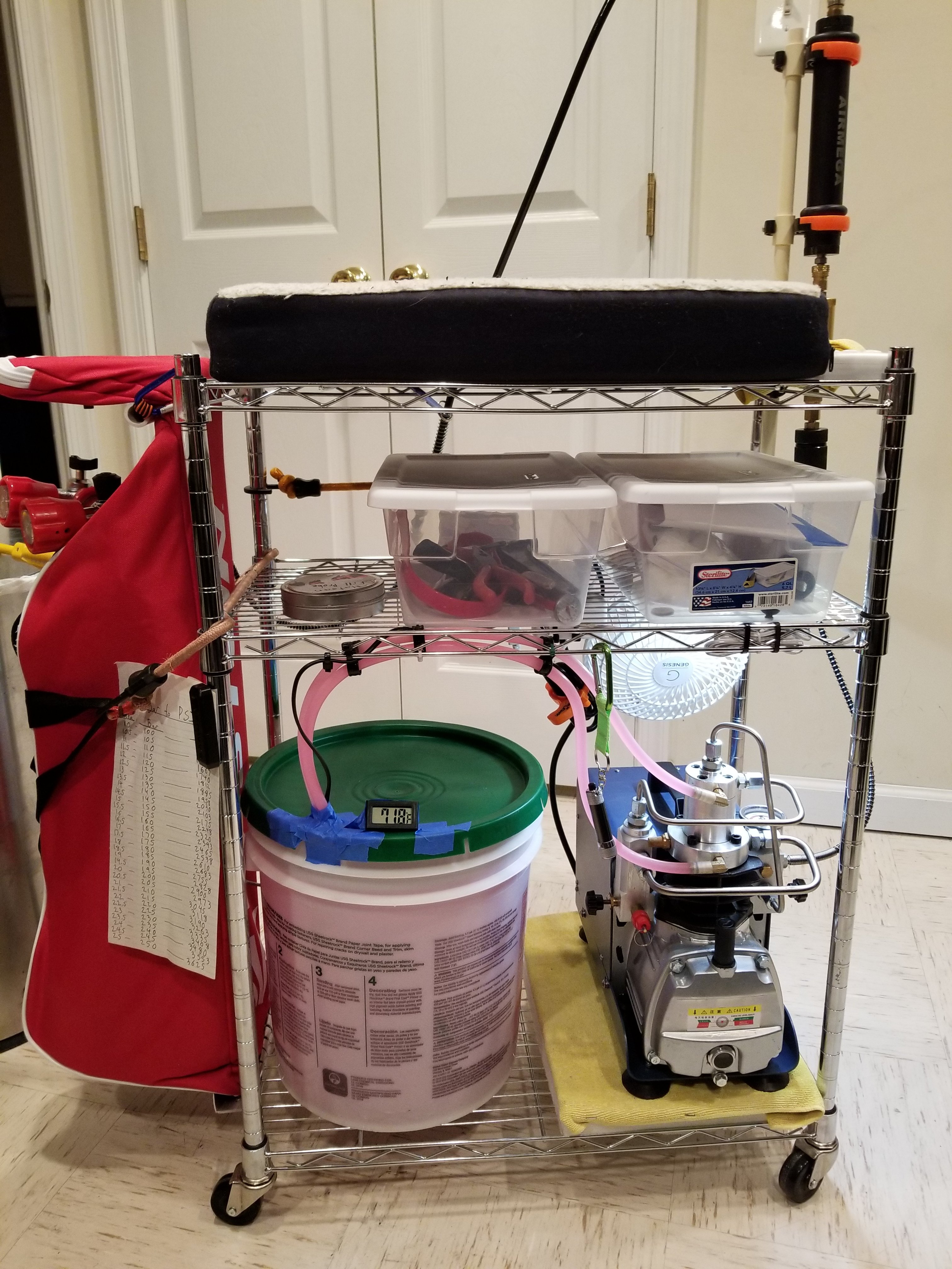

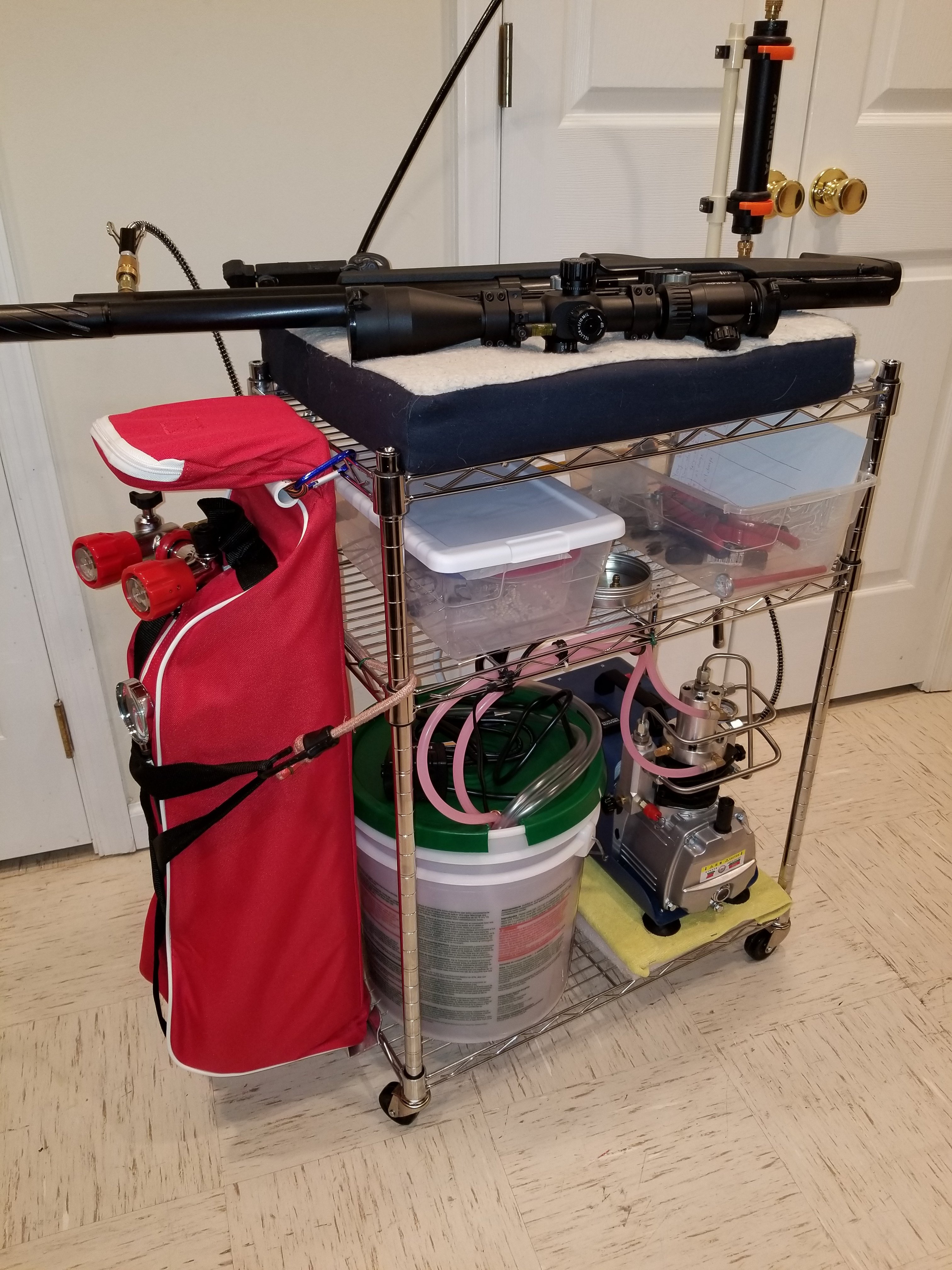

I also fill a 6.8L tank (usually from about 250 to 300bar). My run times average 10 to 12 min and temp stays under 122°F (I changed my temp gauge to Fahrenheit unit). I run mine with a small fan blowing on the unit from the back and a block of ice in 3 gallons of water.
