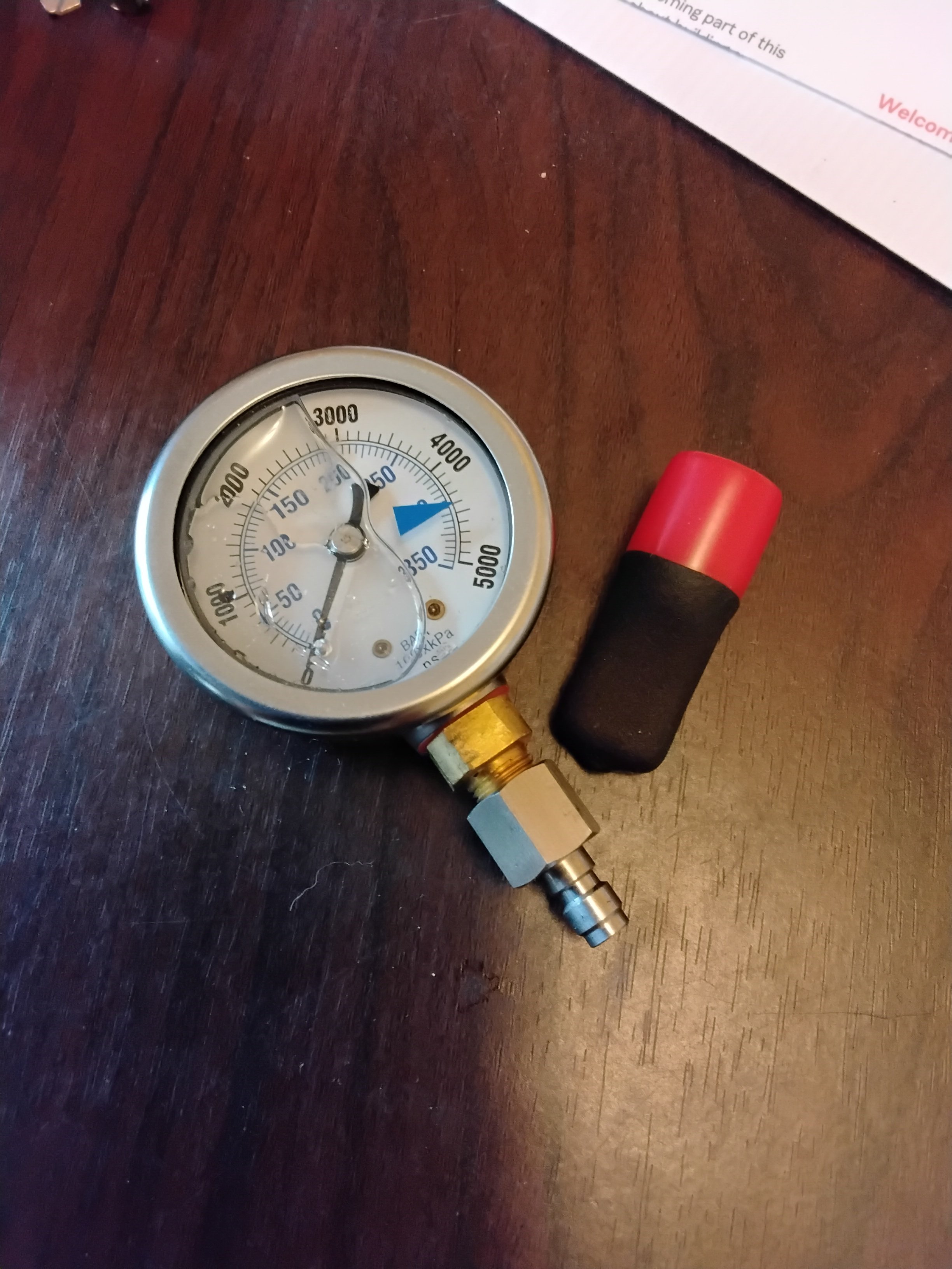

I put this together to check tanks and compressors. About 22 bucks for gauge and male foster off Amazon.
