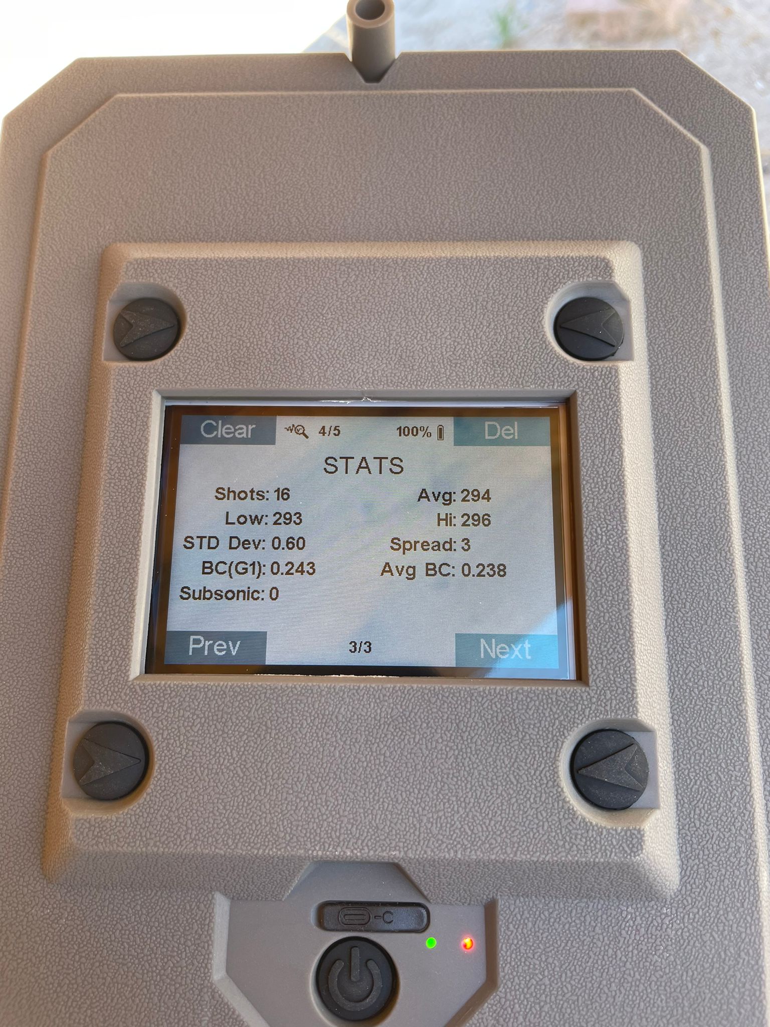

It was for a velocity of 260 m/s = 853 fps, at a higher velocity the BC would be slightly higher.
My friend from abroad who also uses ATP Smooth 49.5gr but at higher speed measured BC G1 0.238 at speeds of 294 m/s 964 fps
On the other hand, the measured BC at higher velocities is not as telling as for slower velocities, because when shooting at 200-300 yards, the velocity will still decrease and the average BC will be more in line with what we state on the slug packaging.

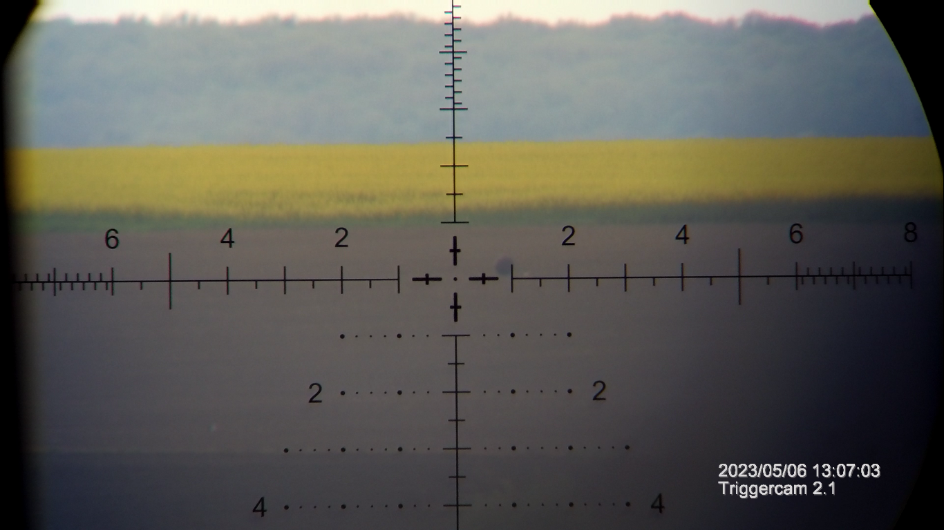

Amazing, is that a periscope on your scope to see over the elevated barrel ?
the periscope is raised a lot, but the image of the barrel/silencer already extends into the area of the reticle, as can be seen here in the photo.
If you zoom in as much as possible (24zoom, this is a black larger target than was used on the record), you can usually see through well. Unfortunately, the scopecam video for the record is of poorer quality, as I was moved by the placement of the TriggerCam
