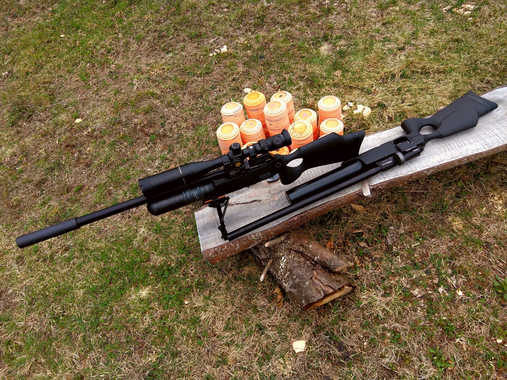

So I'm a fan of the FX Crown, what can I say. It is just my opinion, but I feel like it has captured a certain elegance of design the Impact lost by being just a little bit too complicated.
Anyway I just got my hands on one of the new "Value Priced" Crowns which are considerably cheaper than the standard carbon bottle Crown. I had expected it to be a lot heavier and more off balance, but it really isn't. Shooting it off a tripod, despite both a longer barrel and the big metal cylinder, the balance point was only slightly further forward than my 500mm barrel carbon bottle shroud. I think this VP crown is a screaming good deal at ~1300$. It still handles great, feels great, points great, shoots great, and costs a bit less.
One odd thing I did notice though is that the bottle doesn't appear to be magnetic. They advertise it as a steel bottle, but it sure doesn't seem like it to me both in weight and lack of magnetism. Yes I know certain grades of steel are non-magnetic, but still. If you were worried the metal bottle was going to be a brick on the front of your gun, fear not, it isn't. If you're on the fence about getting a VP Crown, I'd say absolutely go for it!
Just my 2c. If anyone has any questions about standard vs. VP I'll happily try to answer them. :D
