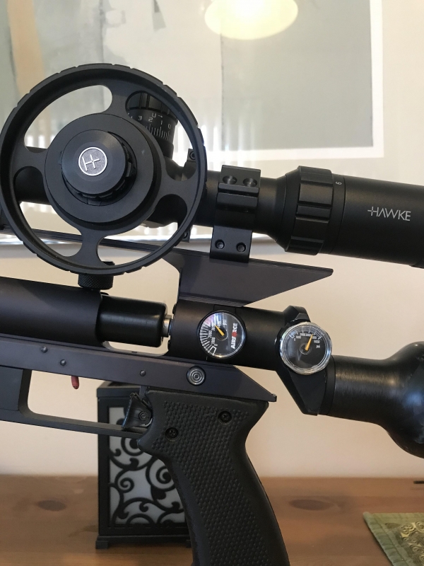

I simply had to post an image even though this may not be the correct forum location however it does go along with my post. When I received the AF valve I did not realize it would come with a gauge and fill nipple. I knew it would be a 1 in a million chance that the clocking would align with my TT tank adapter. I should have bought a lottery ticket the day I bought the valve because it lines up absolutely perfectly! I thought I would try before removing the AF gauge and fill nipple and good thing I did. I know, seems silly to have 2 gauges and 2 fill nipples...Initially, I was just going to install regardless of the clocking just so I could do some testing on the new valve. I can always remove and plug the holes if I like. LOL!
