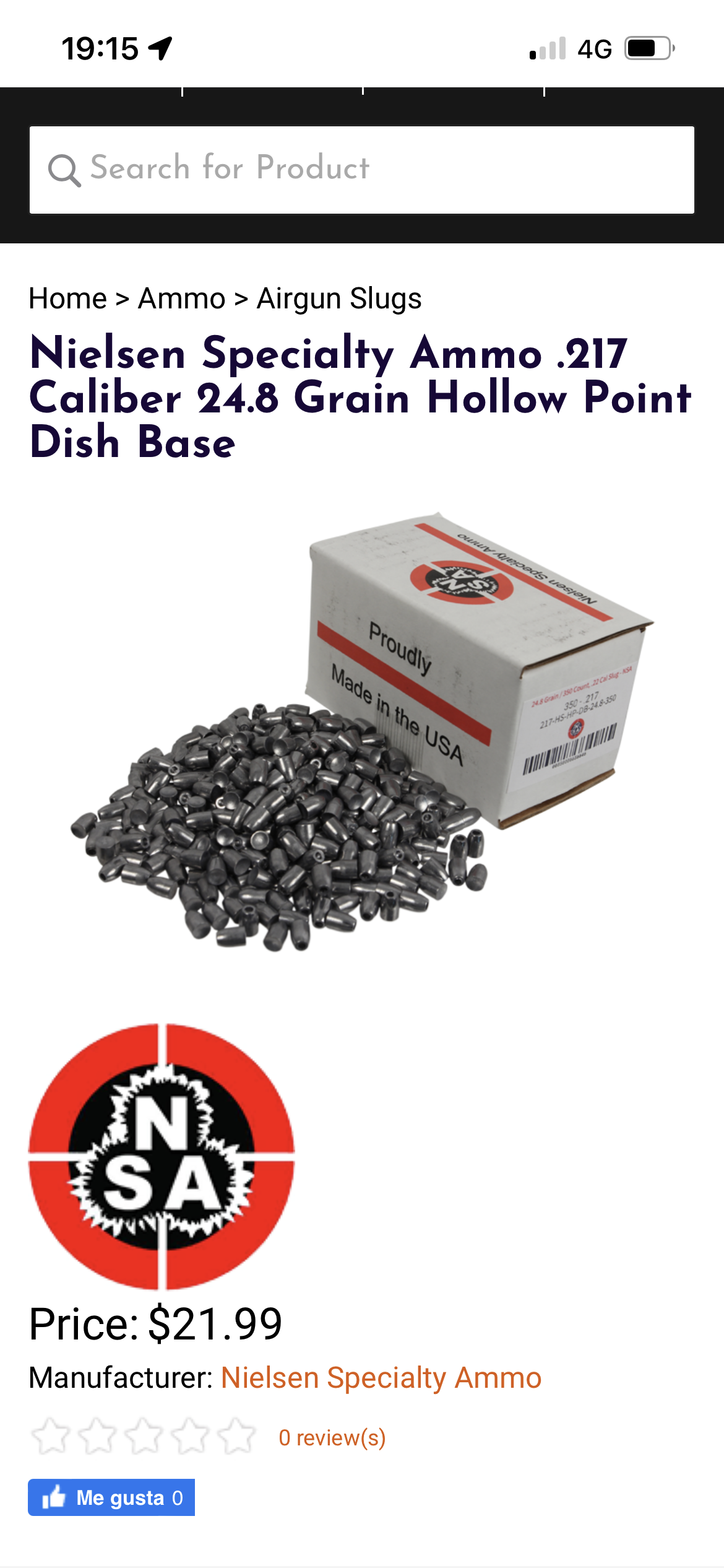

How accurate are the NSA slugs Compared to Pellets
On my Uragan these work great:

My Uragan is the first one.
Today I gave a turn and a quarter to the hammer spring to increase a little bit fps with 25 grain NSA slugs.
I had to give five cliks down to hit the same place at 50 yards. It doubtless increased the power and also feel a little more recoil.
Accuracy is better the parabole is better.
