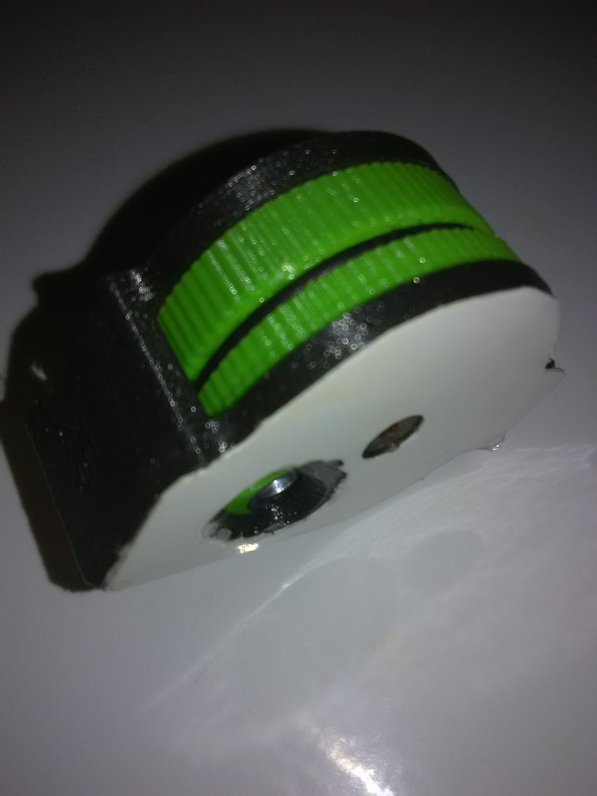

Oh yeah, forgot about the sling, you'll see the anchor points are not correct for "balanced" carry, G2's re-designed stock corrected problem. Clunky cocking bolt and jamming magazine aren't fun, either. Ordered a CARM magazine, had to modify with plastic to make it fit, works great. CARM refunded money and said to keep the mag, even suggesting a fix, great company. WM

Can only speak to the .25, Hajimoto, a Gauntlet expert, has a video out on mag modifications, recommends filing down several sharp plastic edges to smooth operation, tried but didn't help much. CARM magazine, after widening with white plastic, is light years ahead of OEM. WM
