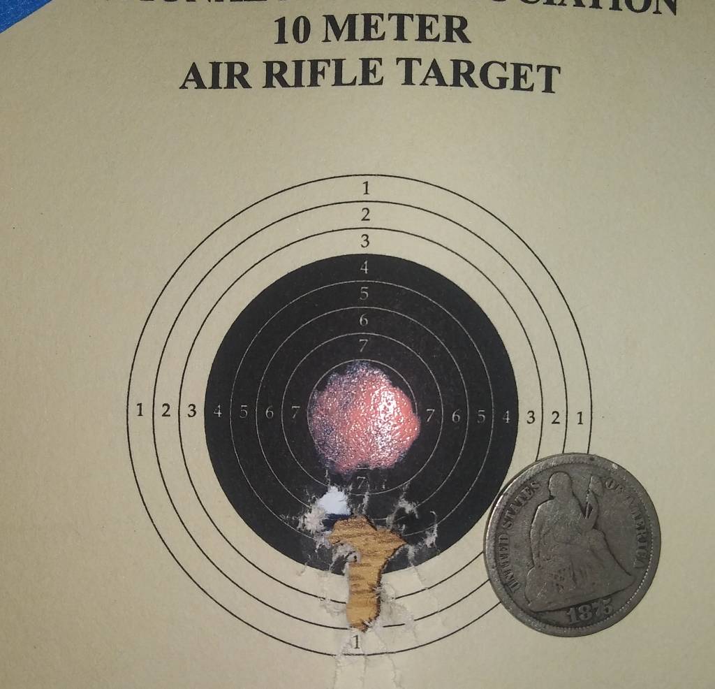

I've spent the last two days trying to make the JSB 25.39g Exact King Diabolo pellets group with the K1.
No good. The target in the pic is at 20 yards, and for accuracy out past 100 yards, there should been one ragged hole. 850fps bar at 125 for this group.
This rifle needs heavier pellets or slugs.
I'm buying some tomorrow.
Will
BTW It's a 10 shot group.

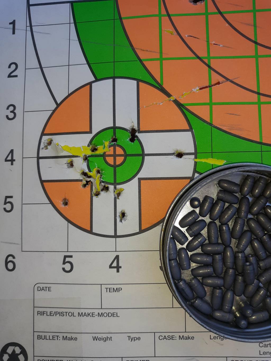

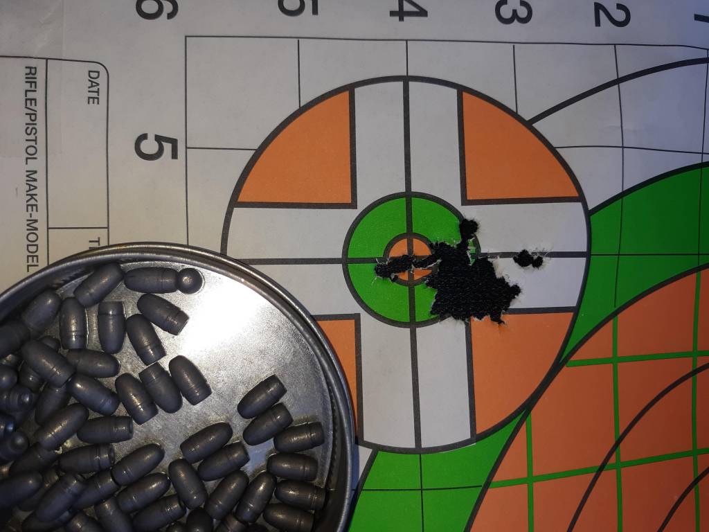

Everyone has different levels of accuracy they find acceptable. I too tried the 25 grain king's and did not care for them. Here is a 50 yard and 100 yard group (of at least 19 shots) with some of the huben slugs. They could probably be better. these were a while back. Cant remember if I used a rest or not
36-37 grain slugs ( of the ideal diameter) are where I think this gun really shines

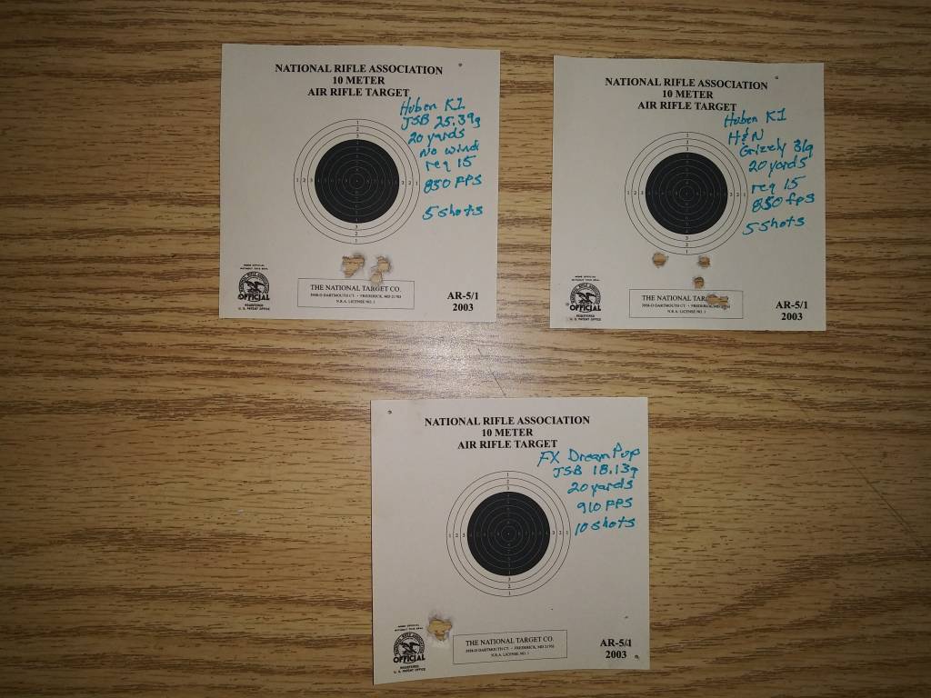

Ok folks, I have had it with trying to get the K1 to group at 20 yards and not corkscrew the projectiles at 100 yards.
I've tried 2 different types of pellets and two different types of slugs. The slugs are horrible at 20 yards and beyond.
What you see in the pic is a H&N slug and JSB pellets which shoot the "best" out of all.
I've tried different reg and power adjustments, this is as good as it gets.
I thought maybe my scope broke or I forgot how to shoot, so I took the scope off the K1 and put it back on my FX Dreampup .22 and shot, not a 5 shot group, but a 10 shot group from the same rest and distance.
The targets speak for themselves.
I think the K1 may be clipping.
I'm not sure.
Will
Dang I feel your frustration. I had some issues finding the best ammo for my .22 but all the slugs I tried and the heaviest pellets worked fairly well. Wish I knew what to suggest but I dont yet have my .25 in my hands, and even if I did, I had kelly swap my barrel for an unchoked, more slug friendly one so what works for me may not apply to yours.
Hope you solve the problem, it's such a blast when it works right
Once my k1 was spraying slugs all over the place. I had taken it apart to fix something or other and when I reassembled it I tightened everything down with the barrel slightly skewed to one side which it turns out was causing my problem. Once I took it back apart, recentered everything and tightened back up I was golden. Of course, if yours was never taken apart this shouldnt be the problem but I'm just trying to help. You never know

Here is a target I shot at 40 yards.
So for those that say this is an unnecessary step, I doubt that claim.
Also, at 100 yards the cork screw pellet travel is gone.
