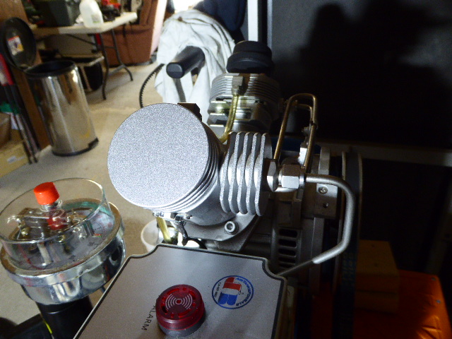

This message is for bosun hu. This video was what we need on here but I wished the gentlemen doing the fix was speaking during the process and in English. The video seems to be a new or earlier version of the Carette I own because the 1st stage is different . Please se pic below. Also the top part of the Ist stage that was removed by loosening a set screw with a 1.5 mm hex wrench. I took the set screw all the way out and still could not lift that part off. Is it possible you can give me a part source for the relief valve on the bottom of the water pump? Thank you, Bill
