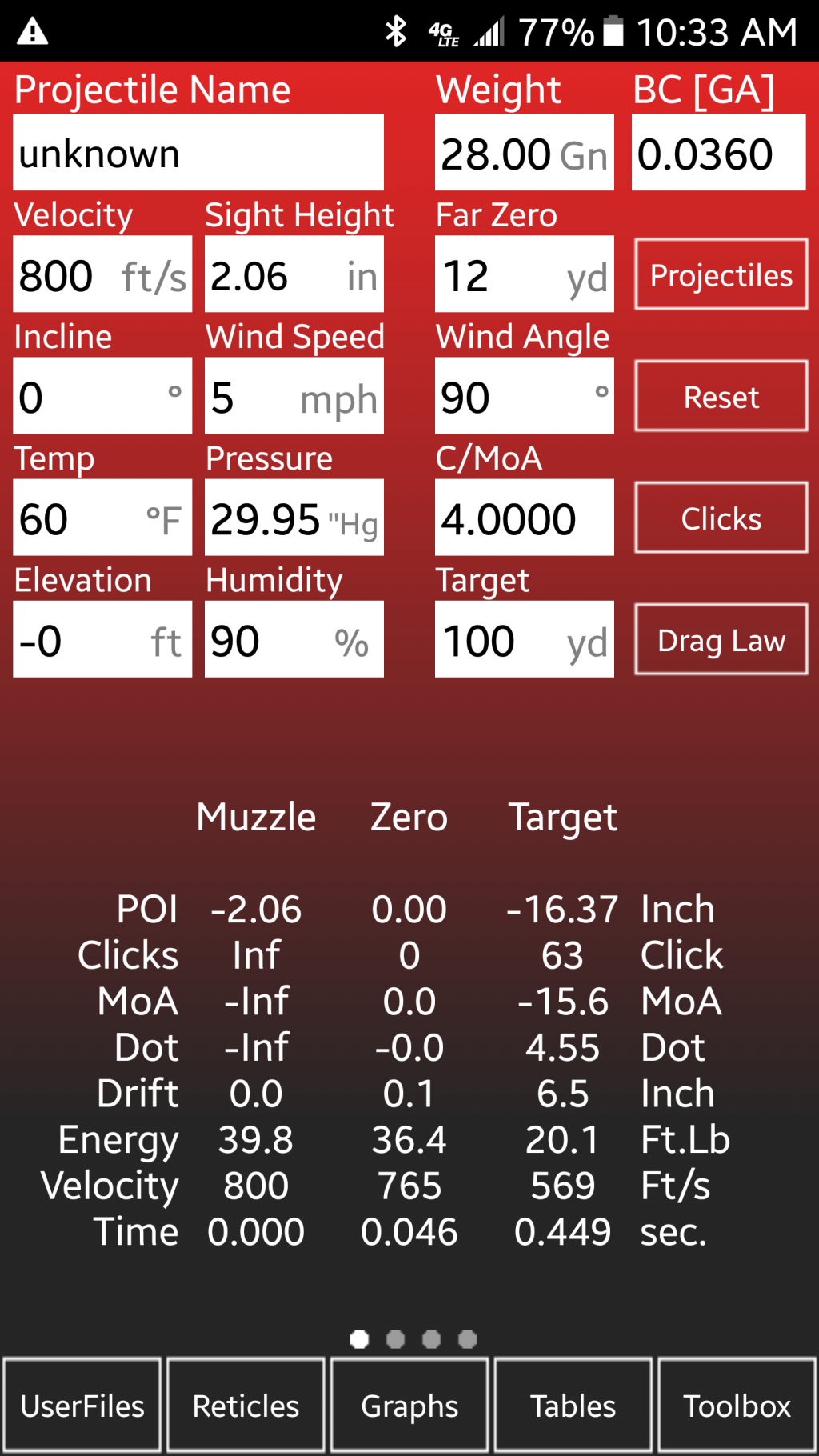

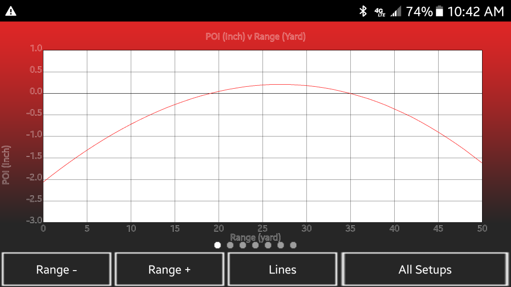

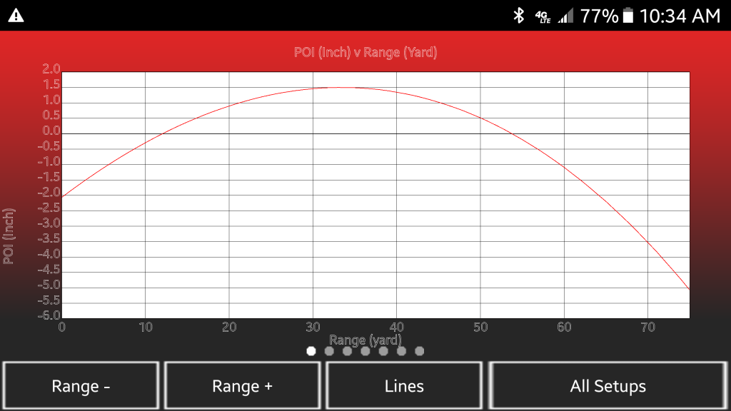

There is Way more info needed for us to give you an accurate answer, things like scope height, velocity, what pellet, temp, elevation etc..... but here's a guess as to your question.
this graph is zeroed at 35 yards you see that everything from about 13y to 42y is within a ½" of the Killzone. ;~)
