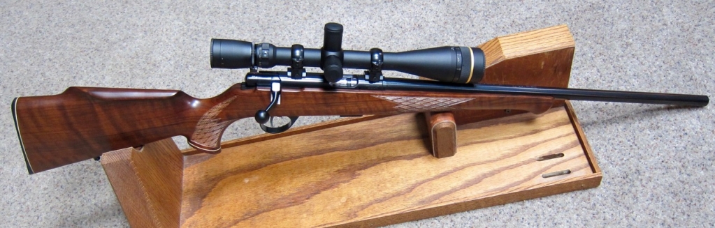

socaloldman- now CZ is a name I know well- I own 6 of them. In fact, my first NRA smallbore silhouette match rifle was a CZ452 Varmint in a custom stock built by Wayne Merier. I still have it; it’s my backup & bad weather rifle, to use when I don’t want my 1712 to get wet, she’s kind of a safe queen.
Ill definitely czech those out!
