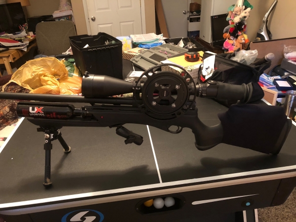

I've got a friend who just customized his .177 Gauntlet for Field Target Competition. He hasn't been to the first match with it yet, but I'm waiting to hear the results, as he was a seasoned FT shooter up until a few years ago. He was shooting Steyrs and Thomas FT rifles and just up and sold all his gear. He's re-entering this year at the other end of the spectrum ;-)
