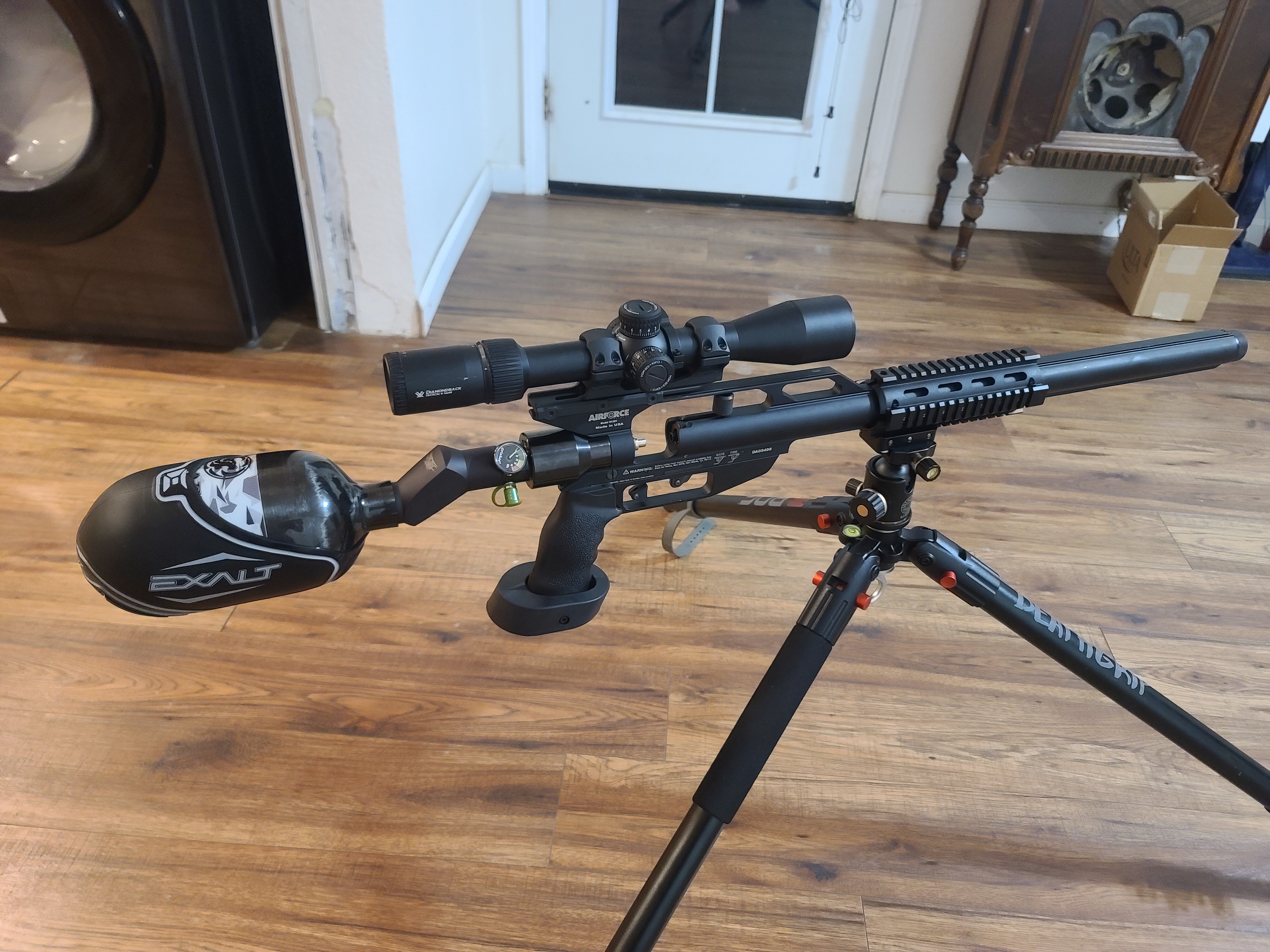

Bubble level helped me more than anything. This is what I use https://monstrumtactical.com/monstrum-next-level-rifle-scope-level-bubble/.
I shoot off a bog tripod with a ball head very little contact on the rifle. I've hit clay pigeons out to 155 with 33gn jsbs on a still day. And I have the huben cricket max reg.
Reactions: Nooyen T
I have heard that about the level before. I was looking into some scope rings with the level built. Might have to revisit that again. Thanks much
Reactions: Bras.25
I started with the level in the rings, it can be a little hard to see. This is the 3rd one I've tried. I like it because it's marked in finer Increments and it's slightly curved. Torquing the rifle on the stand to match the level was my biggest problem. I was hitting a different spot every shot.
