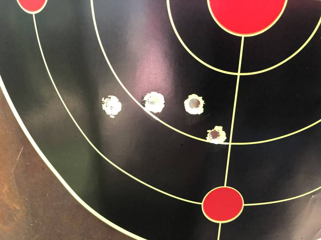

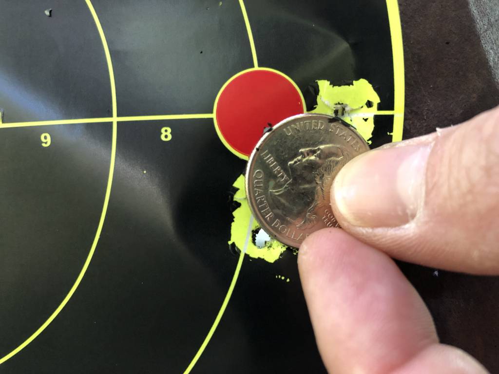

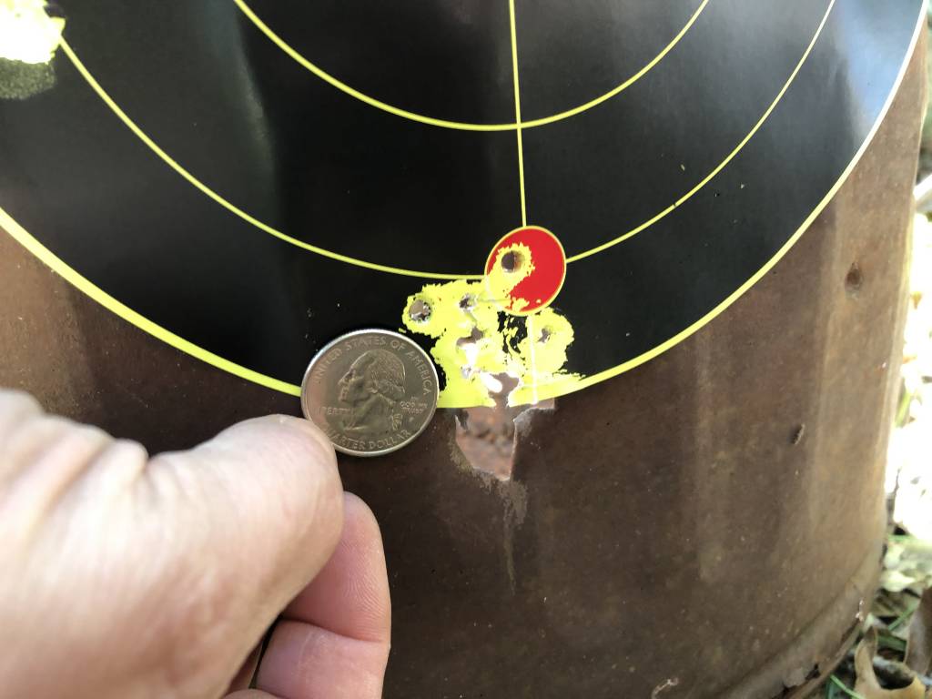

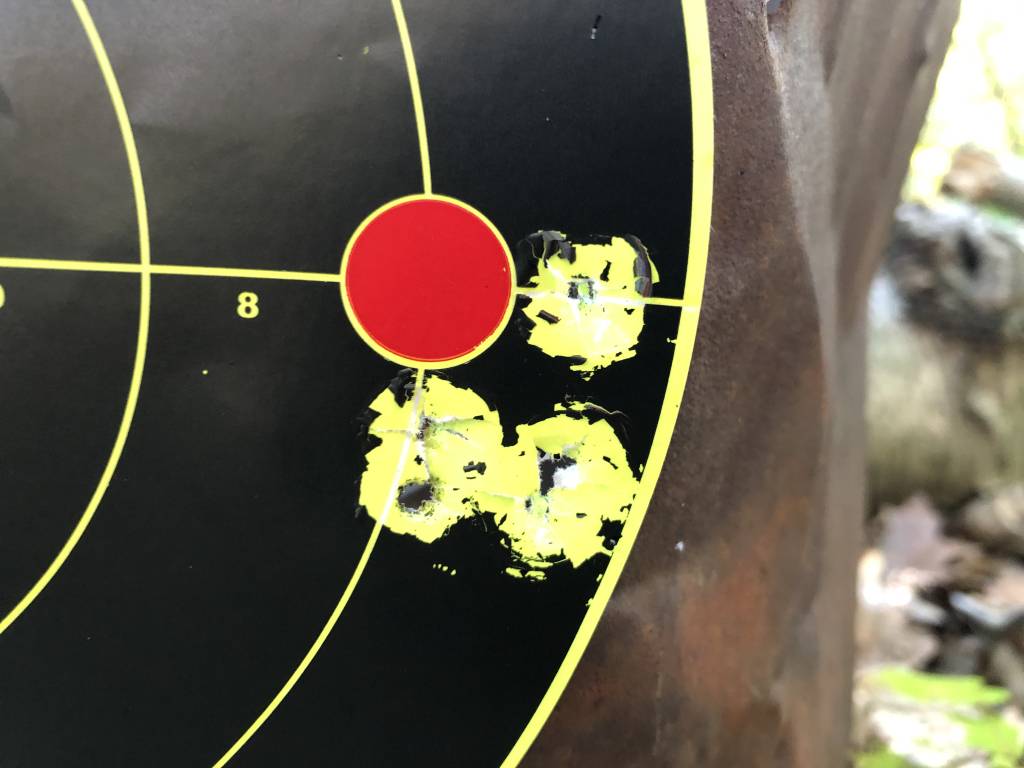

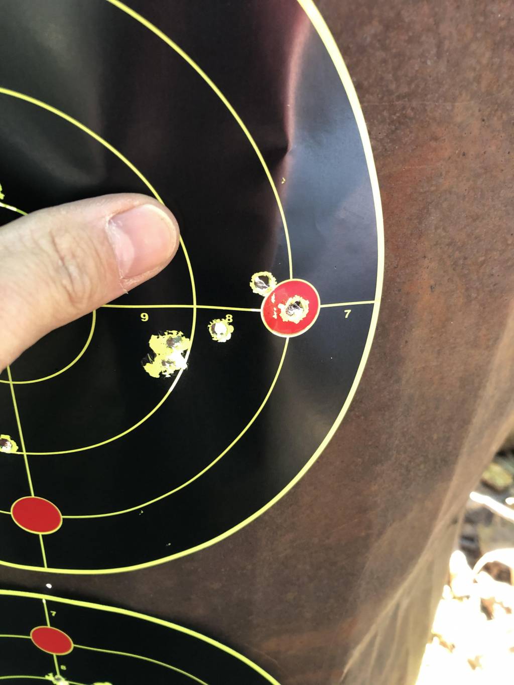

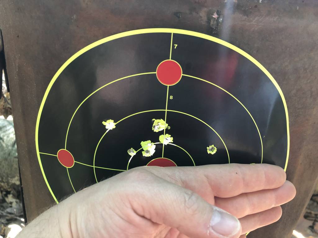

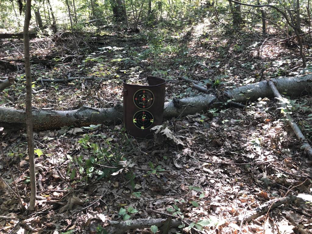

Hey @aimright, here’s what my groups look like at around 63 yards (edited to correct distance once measured). Top target was shot with the 13.4 JSB Monsters, bottom target with the JSB Beasts. Last pic is a 5 shot group and got me *really* excited! Pictures with the quarter are the Beasts. The wind was blowing quite hard, 10MPH gusting to between 15 and 20. The last 5 shot group that’s slightly more than 1” CTC was me waiting for things to calm down between shots. I’ll be borrowing my friends chrony and range finder to verify distances and and energy, but the way these Beasts sound when they hit...it’s quite fun :). The Monsters seemed to shoot OK, but nowhere near as tight as the Beasts! Good think I have about 1500 or them :). In the pic with the targets, it’s easy to see which groups are tighter. Thanks all! Happy camper here :).
