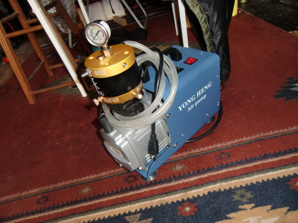

What you decide like most things will probably come down to budget. But hand pumping is no fun and it will more than likely limit the amount of time you want to shoot. The yong heng/tuxing compressors I have seen around for $275 on ebay for the 110V models without auto shut off. If that can be done I would start there, if not, cheap hand pump will get you up and shooting until economics dictate you can move upwards in your air source. Good luck.
The new Air Venturi Portable Self Contained Nomad Compressor is due out very soon and at a quite good price point at $499.99. It will operate on 12VDC or 110VAC. Light too at 17 pounds. If you want a Yong Heng or Tuxing style compressor I have one I have never used. It was a backup and now that I have a Big AV Compressor it is not needed. I never even plugged it in.

Read as much as you can about that Yong Hen before you buy one. I have ZERO experience with them, but it seems that there’s a lot of folk reporting problems with them. The biggest thing will be support. Meaning, you buy it, it fails, you send it back, get a replacement or your $ back.

So $300 for the Yong Heng? Can someone provide a link where I can get one for $275 or $300. Pm me.
Can I fill a gun straight off the compressor or would I need a tank also?? Are there more things I would need?
You can charge the PCP rifle directly with a compressor, but monitor the pressure. Especially, if the compressor does not have auto-shutoff feature. Also, make sure you release the air inside the charging hose before disconnecting it. The compressor should have a water separator/filter, or install one inline with the charging hose.
There are some Chinese compressors on Ebay for $280 with free shipping. Maybe able to catch a 8-10% Ebay coupon too.
Example below: the first ships from USA (same guy who sells the rifle mountable laser ranger, the next from CA and can make an offer to shave a few dollars off, the third one ships from China. There are various options, like auto-shutoff and adjustable max pressure....which may cost more. Also, should conduct a search for reviews, because as mentioned earlier some models have a mixed reputation.
