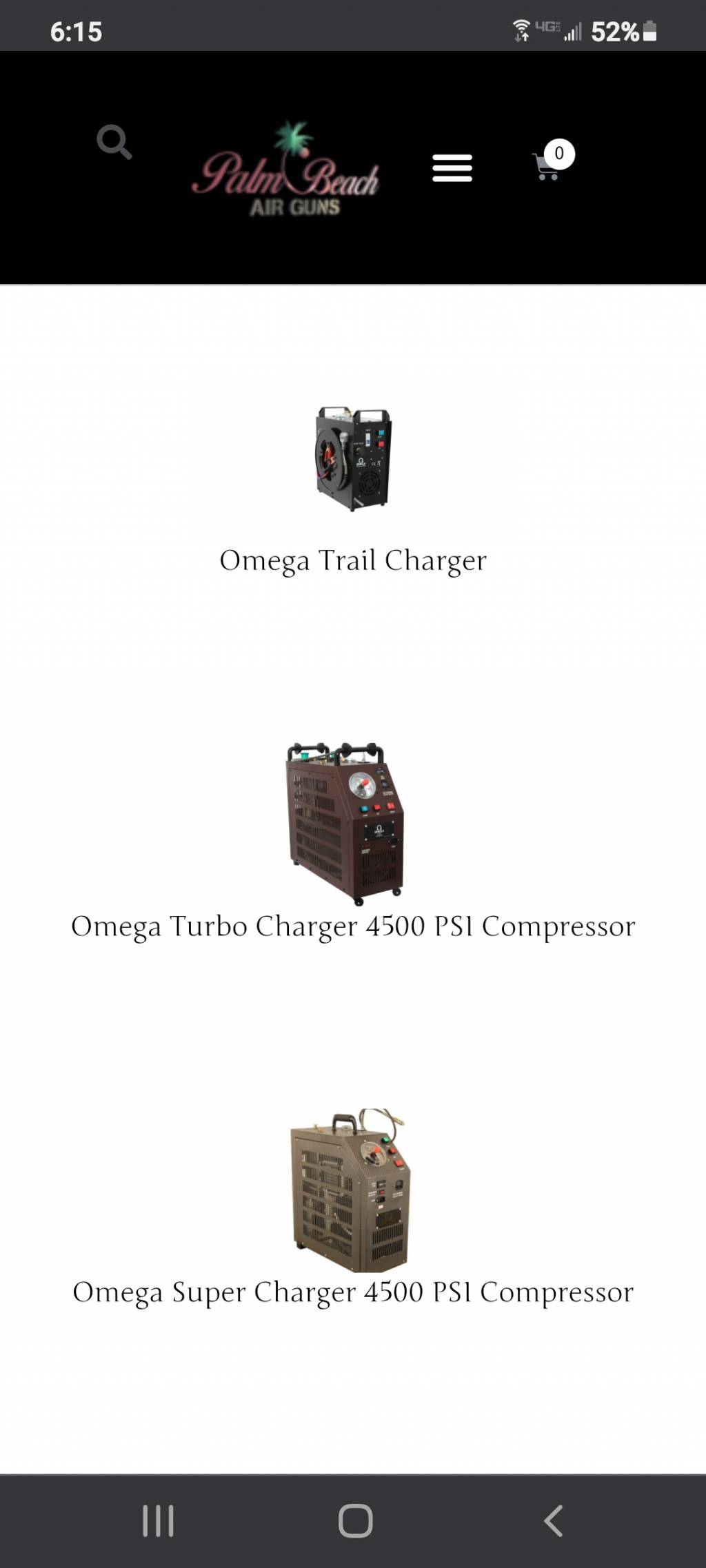

Which compressor is heavily debated on AGN !
I did see Palm Beach Airguns is showing Omega compressors in stock ?????
