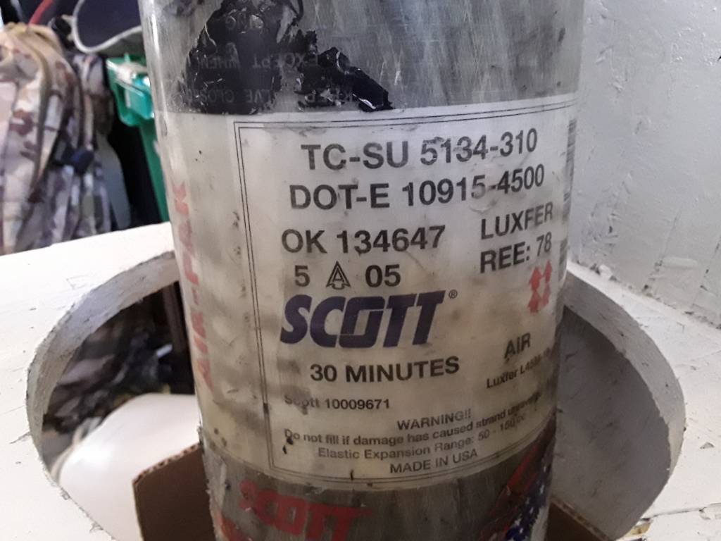

    OW, OW, OW! Being a guy, it made me wince & reach for my "junk" reading about your ailment! Your tank has to be newer than 70's if there's still a couple years left. Here's where to look for mfg date (picture, just above the SCOTT name. Mfg date is May, 2005 on this one)
    Thanks I have a carbon bottle but I can’t really read the stamps so a friend of mine said it was made in 2012 I think. No one has been over this week since it’s been a bad week , but as soon as one of them come over to shoot , I’m sure they can read it , And also remind me of the size. I’m not the sharpest pencil in the box right now with the handfuls of junk they say I need to take.
