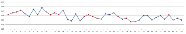

How Piggy the .25 Marauder is, depends on whether you add aftermarket products to it. A Marauder with aftermarket TSS (spring assembly), Lightweight hammer, upgraded valve, larger transfer port and hole in the barrel, and a Huma regulator can give you 42 regulated shots at 40 FPE. Each horizontal line is 5fps variation in speed in the graph. The graph is zoomed in, there are 165 lines below the lowest line in this graph.
