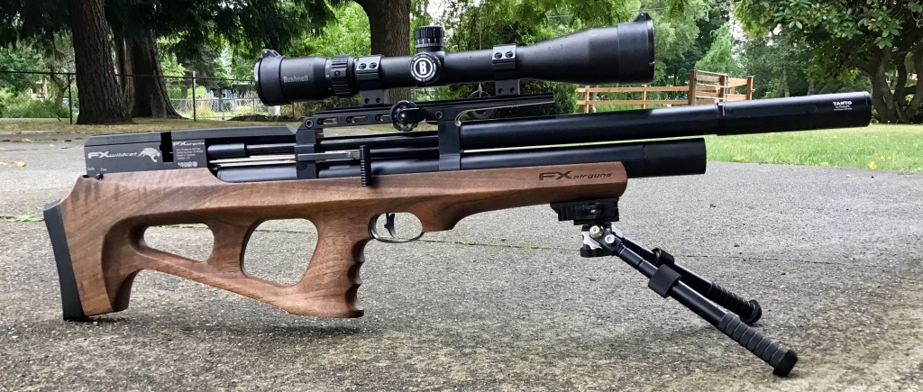

New to PCP Air Rifles - FX Wildcat
I'm the winner of the Airgun Depot grand prize FX Wildcat but don't know a thing about PCP rifles.

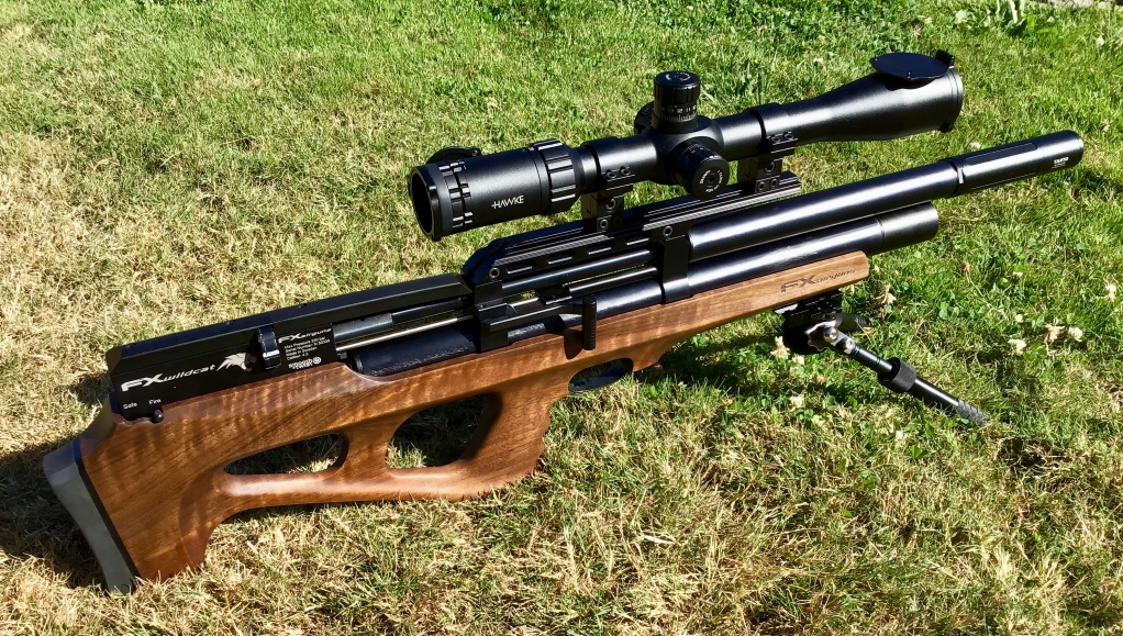

It had about 150 upon arrival (manual says don't shoot 100 or less) so I shot it.
What surprised me most about my first PCP is little noise and zero recoil (at least it feels like zero next following gas piston). And I shot bullseye six times offhand at 25 yards right out the box.
I'm waiting for a connector so I can refill it because Airgun Depot didn't include this little piece that connects the tank to the fill probe.

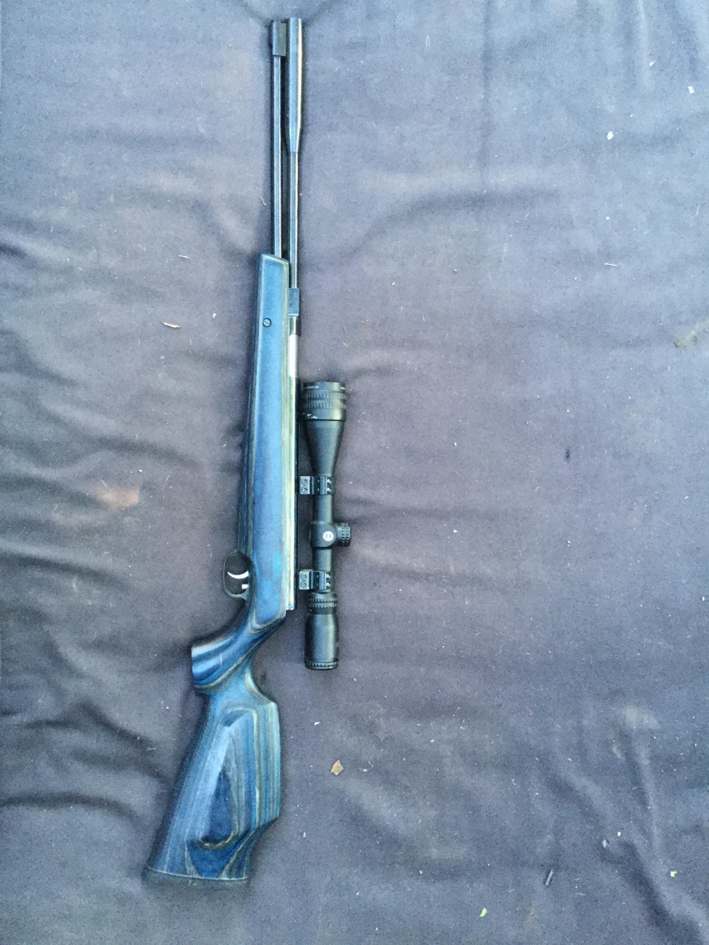

I will trade you this for the wildcat.
