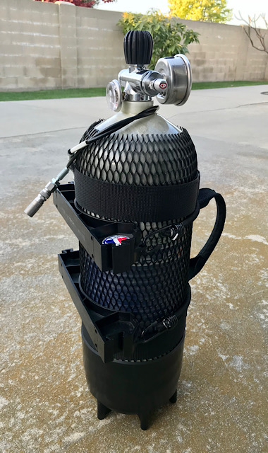

Look at tanks that have dual gauges, one for filling the other for pressure in the tank, makes filling much simpler. Joe Brancatto of AirtanksforSale/TopGunAirguns carries these gauges with different size tanks. This one is a Great White Tank that is 90 cu/ft. You also need a way to fill these tanks whether your own compressor or a nearby Dive shop 👍.

As said above. Buy a tank that is DOT certified or a shop won’t fill it. Very important. Majority of ones sold on Amazon and eBay aren’t. On eBay you can get acecare dot tanks. If buying used keep in mind they only have a 15 yr life for professional fills and have to be hydro tested every 5 years. So check the dates stamped on the tanks.
