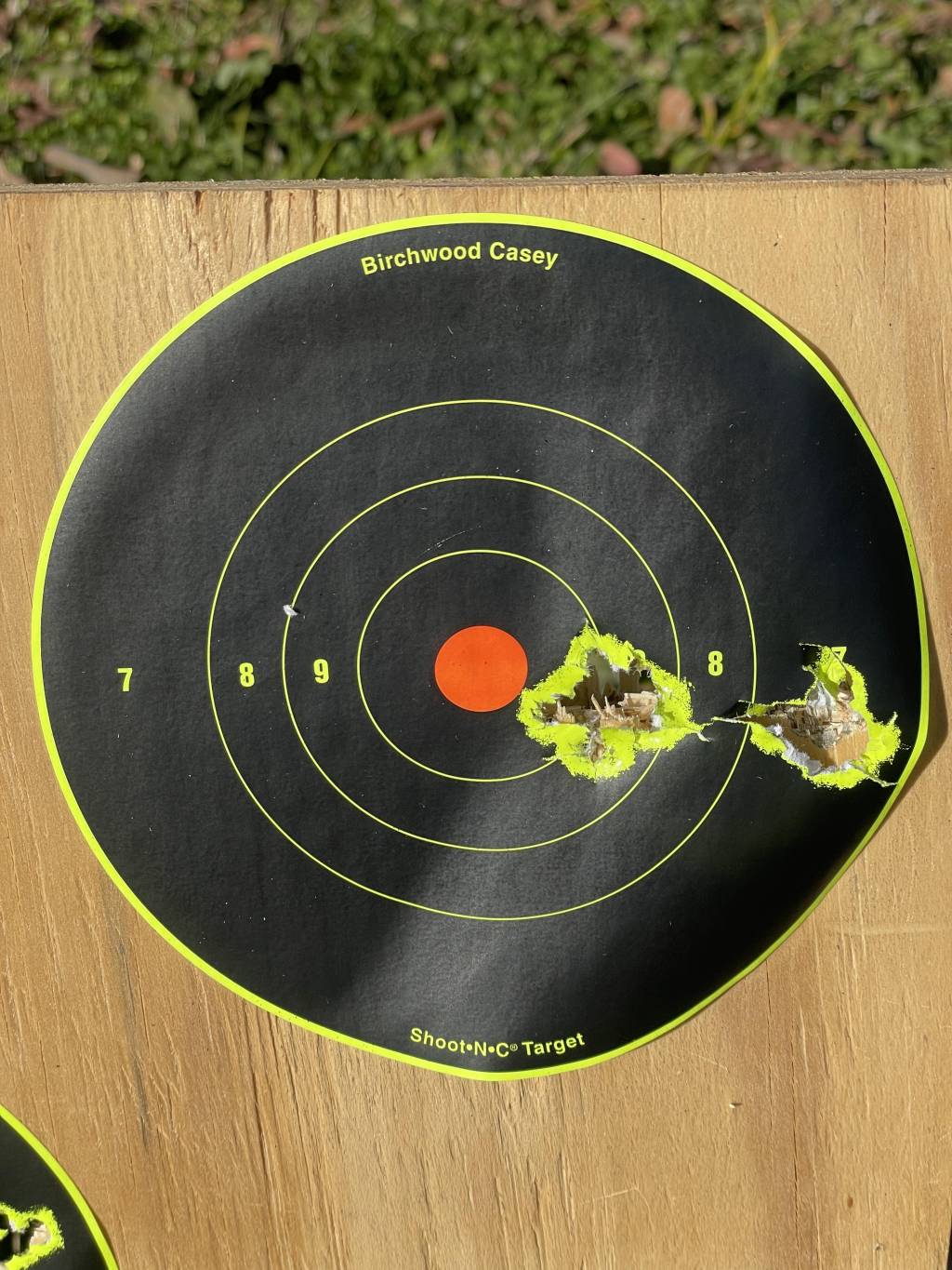

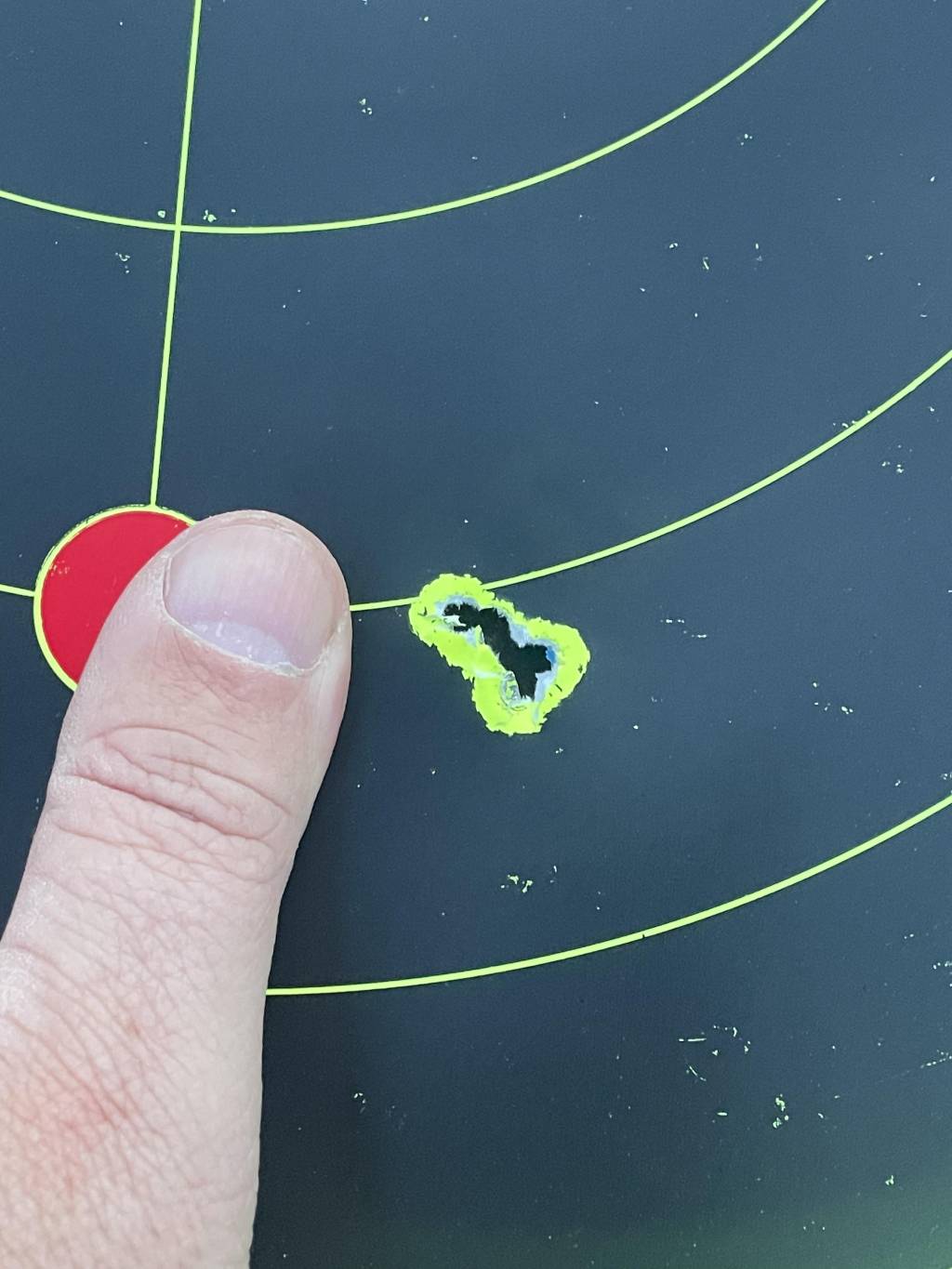

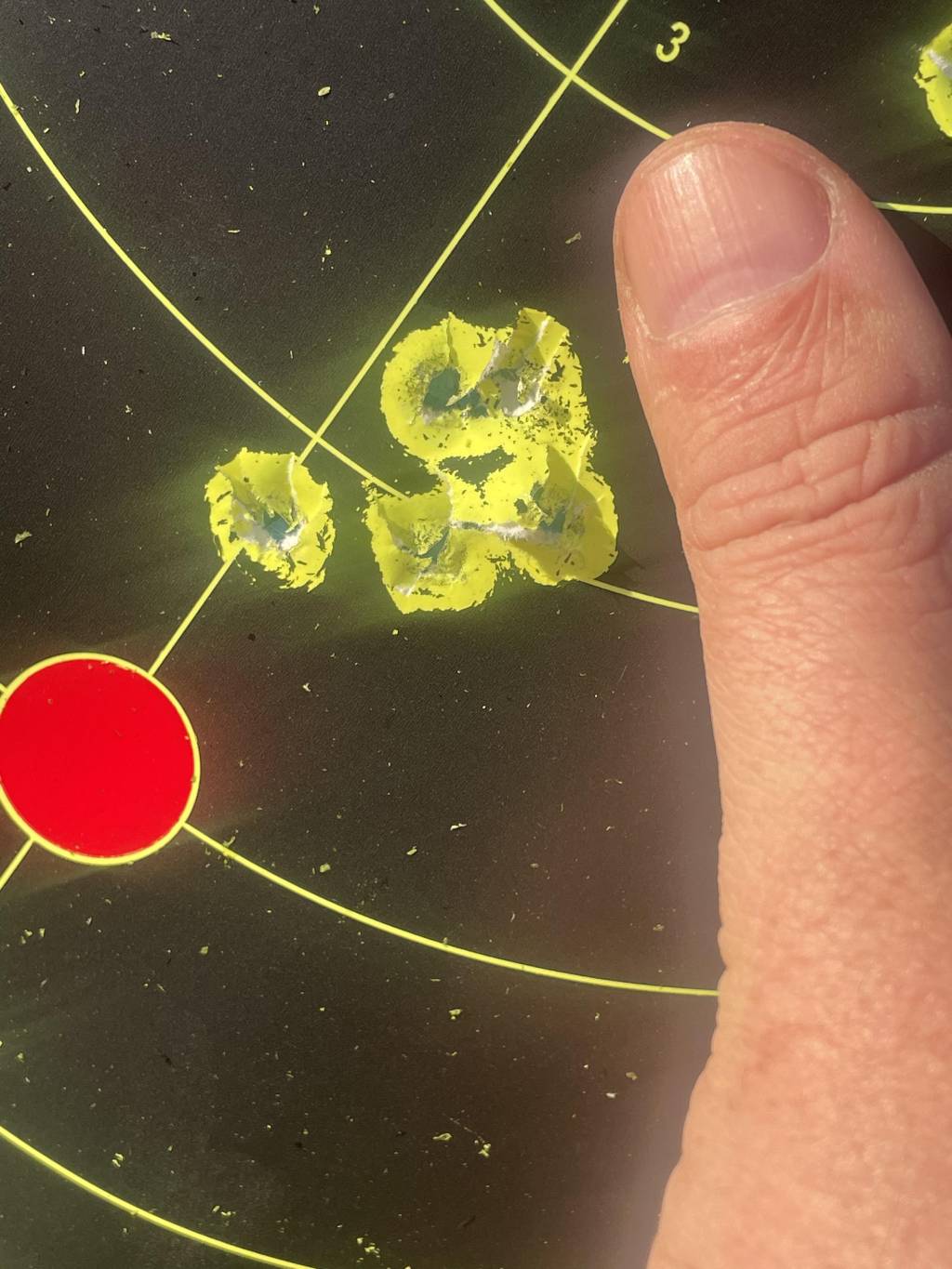

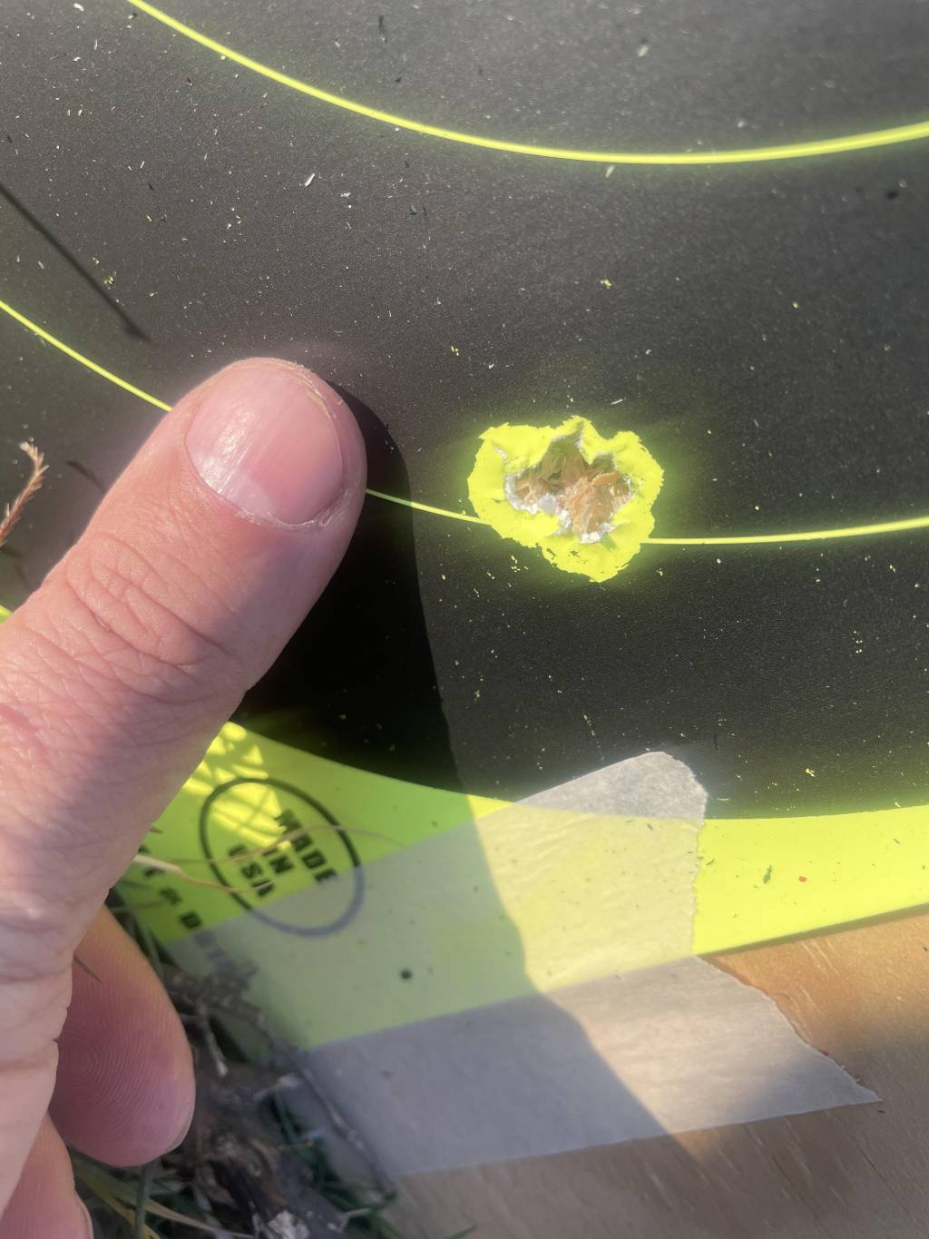

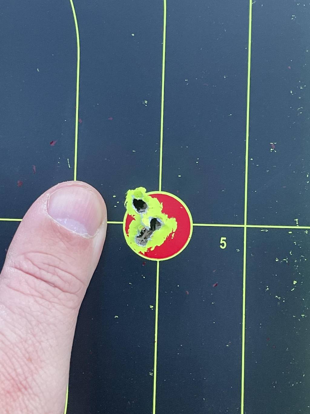

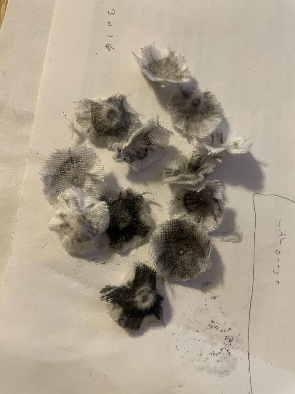

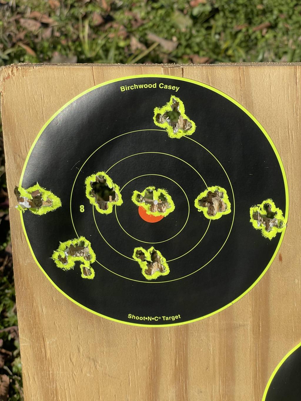

Took it back out again today, after sitting in the warmer house pressure creeped back up a little, was at 210 bar when I picked it up. First 6 shots were 900, 940, 954, 954, 940, 940. I then proceeded to shoot the rest of that mag and 15 more before using the chrono again. Started chron again on mag 17 for the day (shot 14 mags yesterday. The 12 for mag 17 were 940, 940, 954, 940, 940, 940, 940, 954, 940, 940, 926, 926. Looks like it fell off the reg at shot 370. I then shot until POI dropped at shot 397 at 50 yards. That comes to 33 mags on a 300 bar fill, I was just under 100 bar when I stopped after shot 400. Below are a couple of pictures of my 30 yard groups. Groups are 12 shots each. I will try to get the video of a couple 30 yard groups off of my Pard nv008 later. I also took a picture of what was left of a 500 count tin after one fill.
