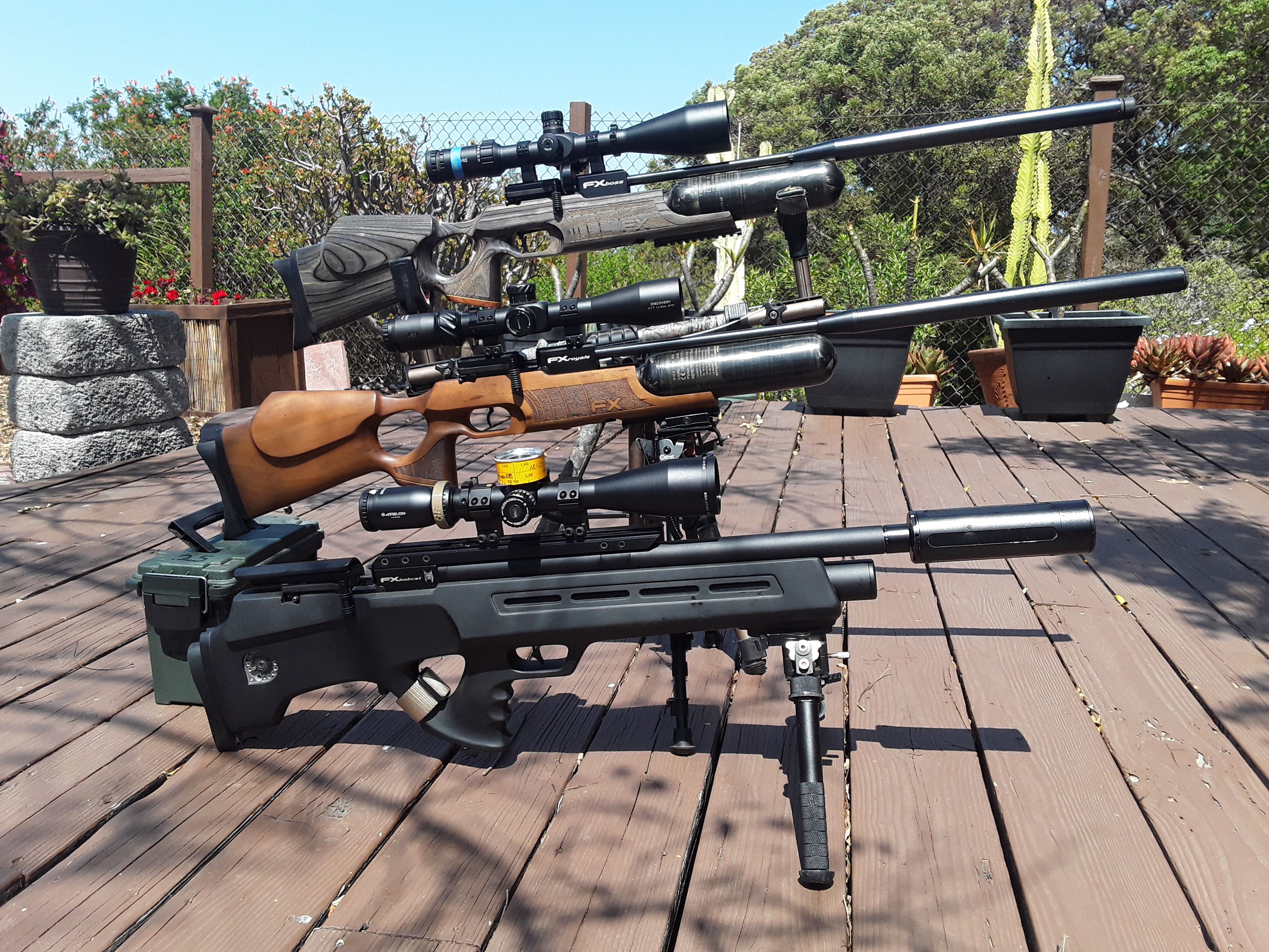

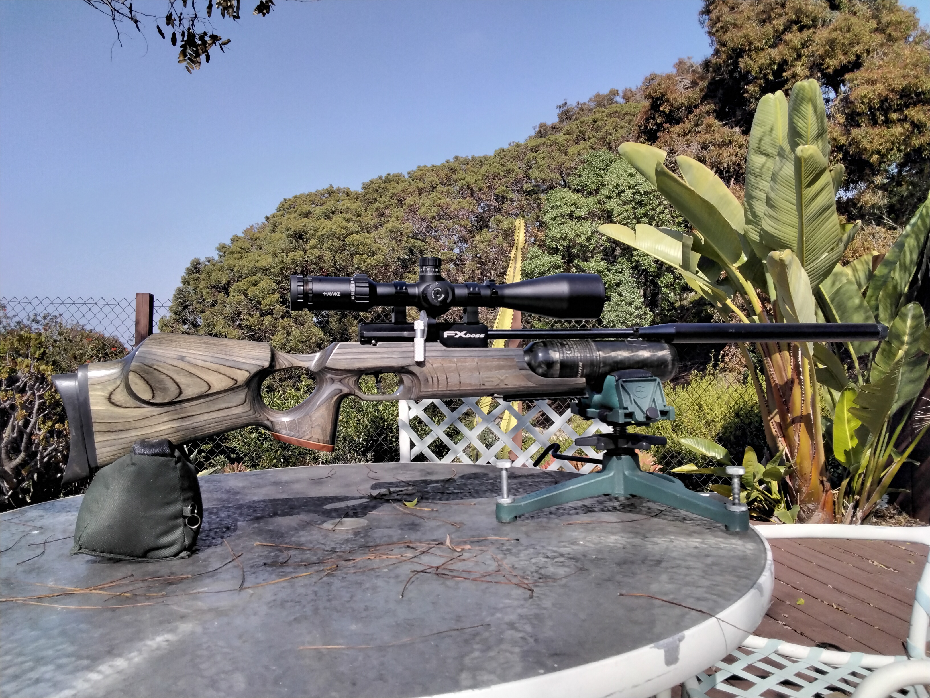

You acquired a SUPERB & simple pellet shooting platform. I have a .22 Bobcat,.25 Royale 500 & a .30 Boss. Never any leaks with the Royale & Boss. If the prior owner ever had it apart without replacing seals, especially around regulator exterior, THAT could cause leaks. Remove stock from action & spray with some form of leak detector to track it down. FX USA has diagrams under "support" on their website. 20220430_141952.jpg

I had to get into the internals of my Boss a couple months ago. I was surprised how relatively easy it was to work on & get it back to top form. Same as yours, just larger caliber.

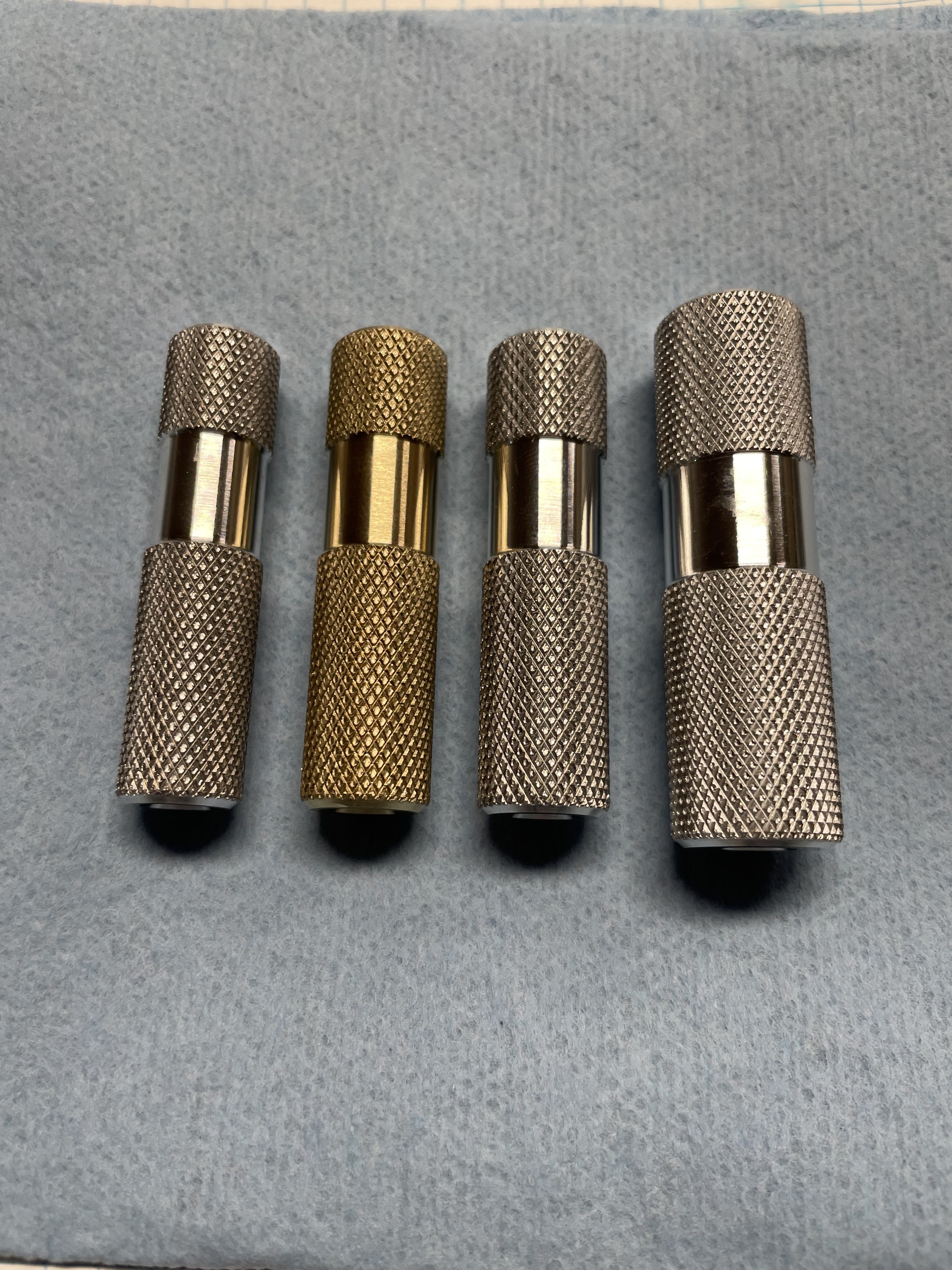

BTW, I dressed up all 3 of mine with custom made aluminum knurled cocking lever handles made by Chan (cfs916). They feel GREAT & so was his price! Same as Crown or Impact handles if you contact him.

BTW, I dressed up all 3 of mine with custom made aluminum knurled cocking lever handles made by Chan (cfs916). They feel GREAT & so was his price! Same as Crown or Impact handles if you contact him. View attachment 354516
Chan has since ramped up his game with these cocking handles. Beautiful work
