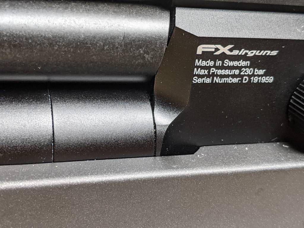

I recently purchased a used .22Cal Dreampup Tube version, Serial Number D191959. The rifle shoots great as it is, but I do have some questions after reading the blogs and vlogs on the Dreamline.
1. What generation/year model DreamPup do I have? From what I can find it is a Gen1 but am not sure.
2. It looks to me the rifle is equipped with an FX PowerPlenum. See the attached photo.
 Is this correct?
