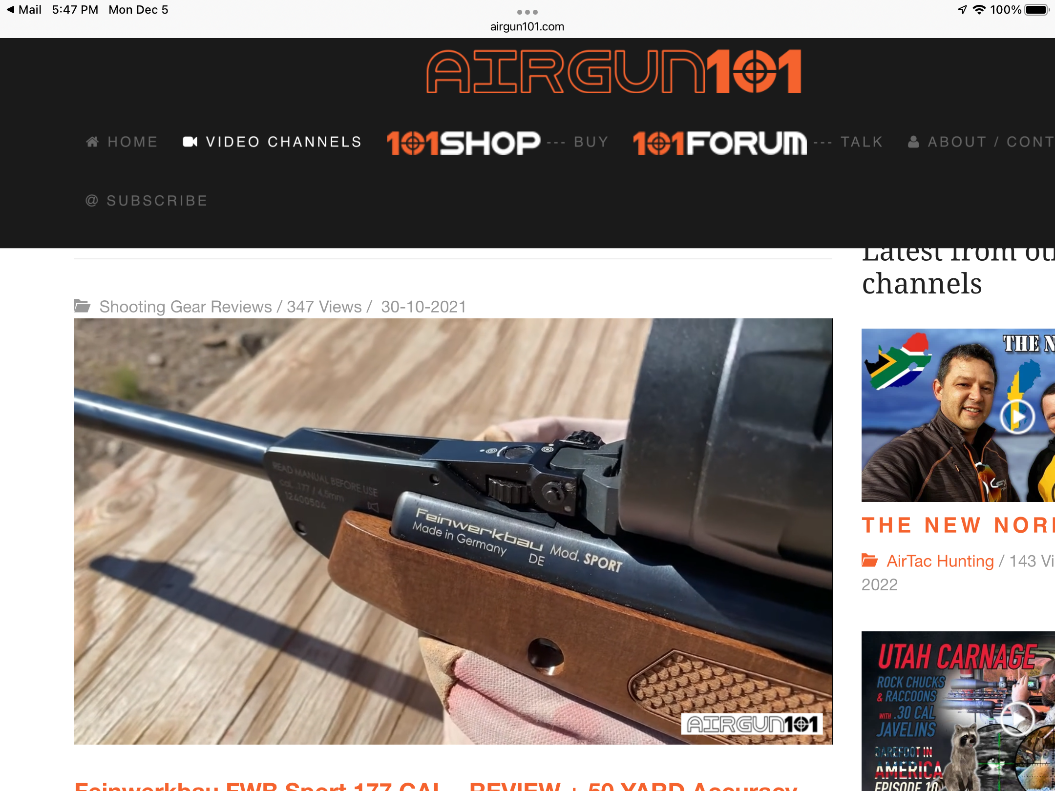

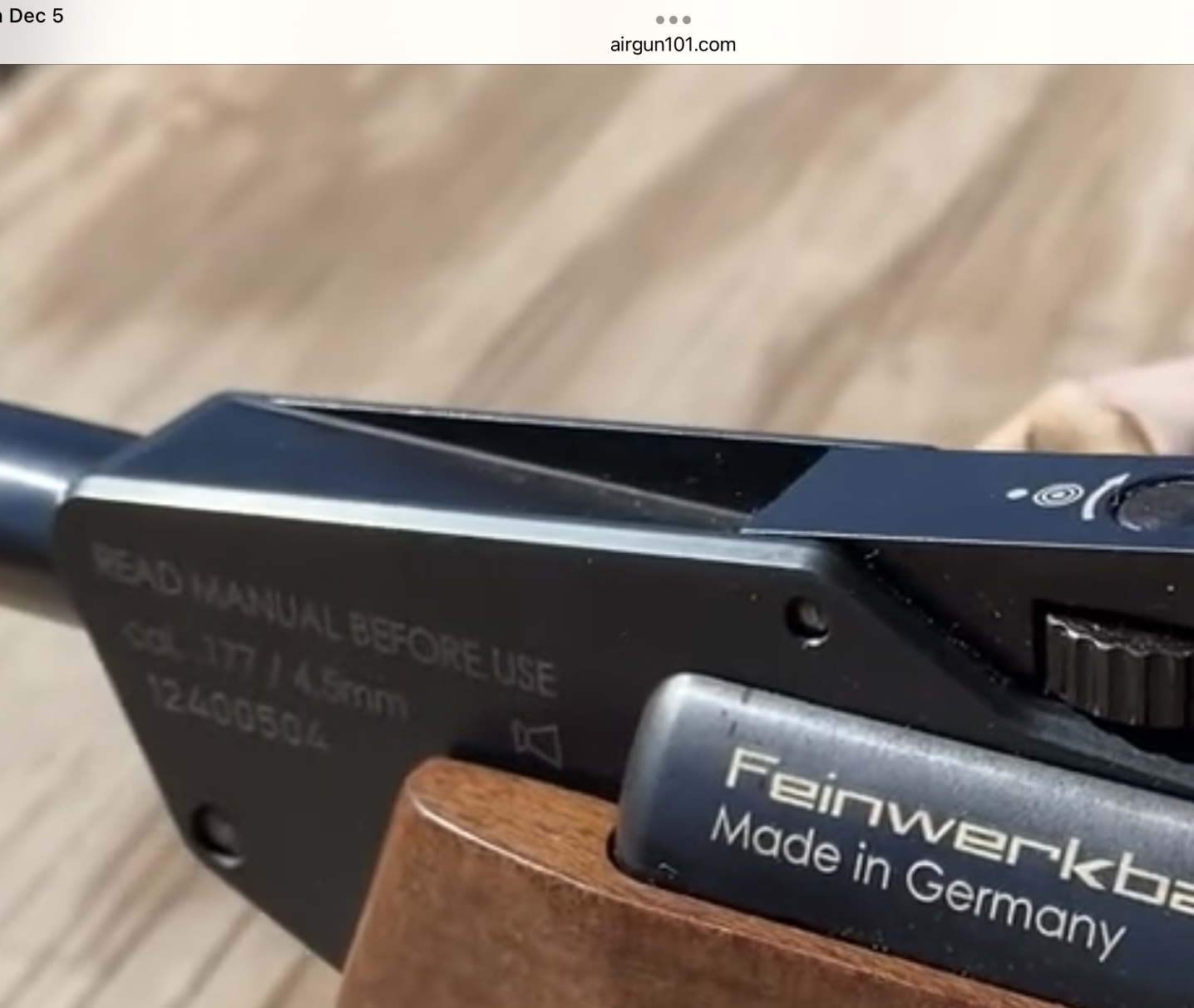

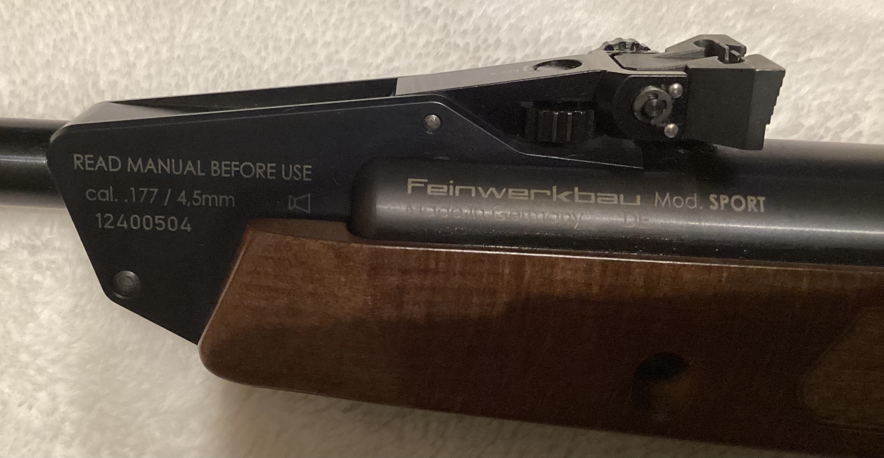

I bought this FWB Sport from Airguns of Arizona on 11/23, it was in the preowned listing and described as used for a video review model. Curious I searched the internet in hopes of finding a review with this rifle. I found the video review Ben Pierson recorded on 10/30/2021 for Airgun101 (Shooting Gear Review) at about 1:35 - 1:45 of the video I noticed a serial number 12400504 on the breech. Today the Sport arrived and after checking the rifle over I looked at the serial number and to my surprise it was a match. As Mr. Pierson stated this is one awesome rifle. I also put 5 shots through it at 25 yards with irons only and shooting off hand 4 of my shots grouped very nicely of which one hole was hit twice (slightly larger than others), my first shot is the one that is off to the right.
Here is the link the the Airgun101 Review: https://www.airgun101.com/68-whiske...view-50-yard-accuracy-this-is-an-break-barrel. I also captured an image of the serial number on the rifle in the video.
Spring noise and vibration were not an issue, she does have a stout recoil but all you need to do is take control, the accuracy is there for sure. This one will be with me for a very long time and a great addition to our family collection.
