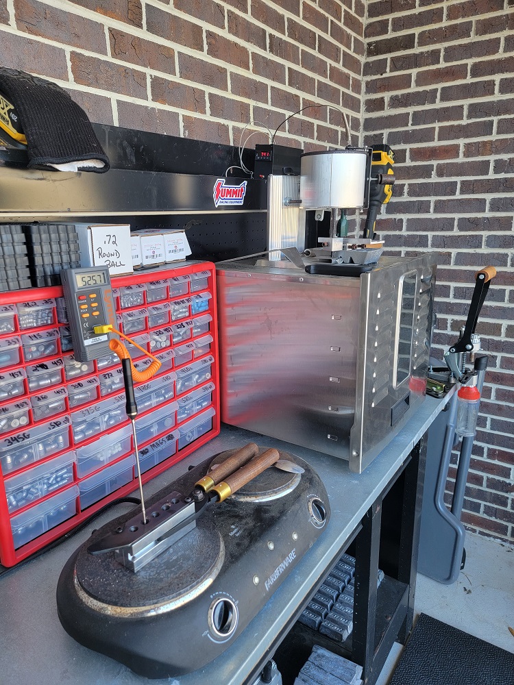

It you like to shoot start casting . Its not that hard or expensive. Lee makes .457 molds for $25.00. A 20lb lee lead pot $80.00 A lead thermometer $25.00 and your are ready. Pure lead I buy is a dollar a pound at the junk yard. $25 for the Lee .457sizing kit. I shoot cast powder coat .510 slugs that are really accurate. If you mess up a slug melt it and try again.
