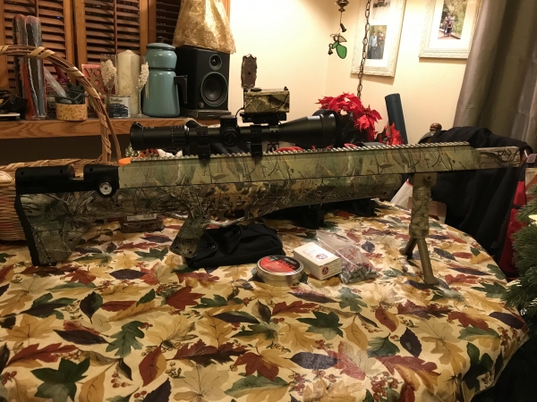

I am going to rain a bit on the sunshine here. Texas regulations allow big bore air rifles for large game, but requires 215 FPE or higher be used. If all he is hunting is non-game species, such as the invasive wild hog, then this requirement MAY not apply in his case. But if he is shooting Deer, it will. I like the Benjamin Bulldog, and own one. But a stock model from the factory is slightly short of the required 215 FPE mark (I only get about 195 FPE with the Nosler Extreme 145 grain round). There are tuners, who port the valve and transfer port, who get about 300 FPE out of that specific air rifle, but their services set you back about three hundred dollars. And yes, a moderator does make a significant difference in the noise. It drops the noise level from about that of a 22 long rifle powder gun, to an un-moderated break barrel air rifle.
