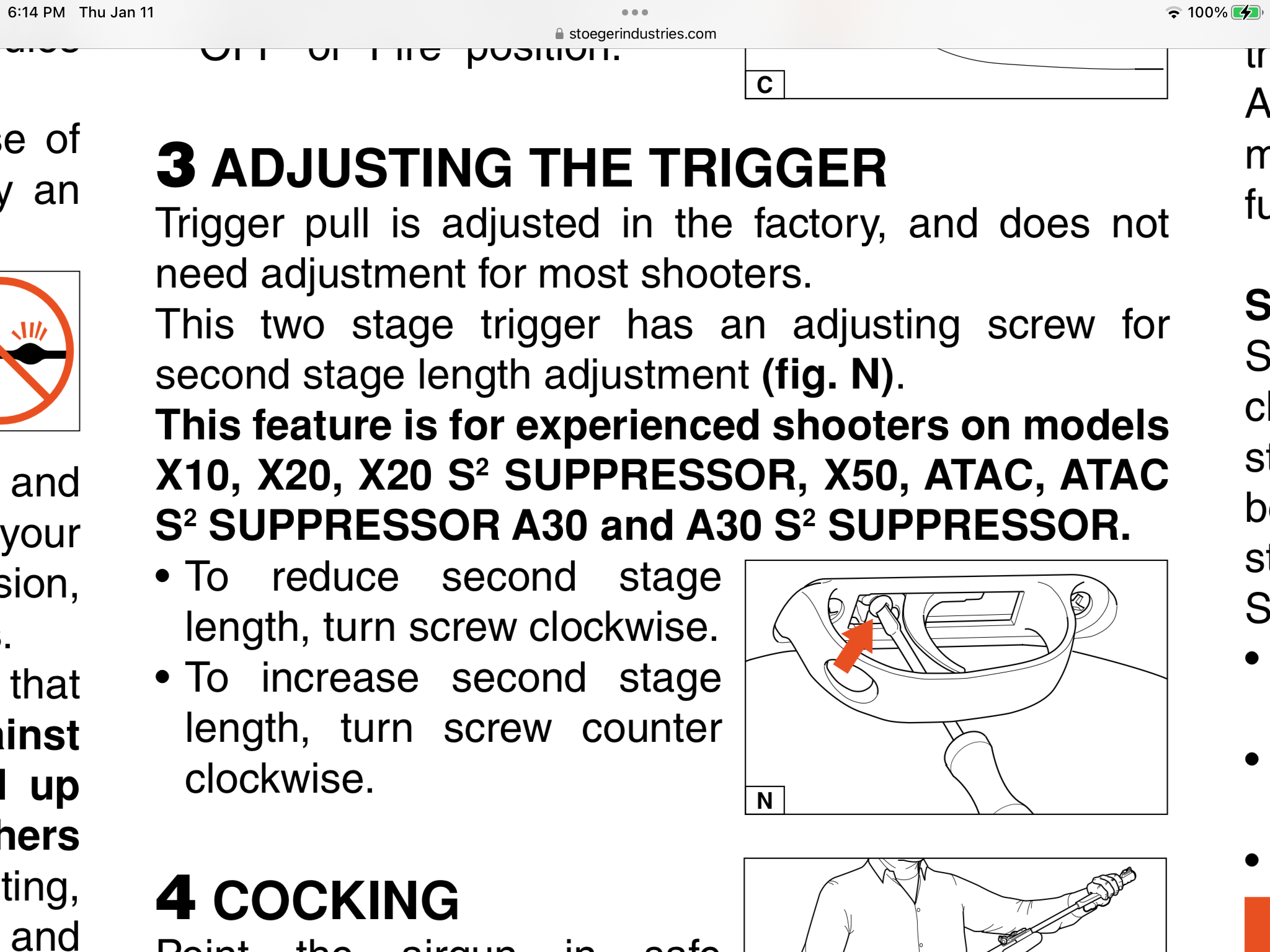

I like the gun but not the trigger. I wrote the folks at GRT but they didn't know which trigger would fit. Do any of you have any suggestions. Thanks, Will
Many triggers are adjustable to change the pull weight. Some require disassembly and spring changes and polishing of internal engagement surfaces. Does your manual offer any guidance to adjust the trigger? Perhaps there is something on YouTube if you search?
After reviewing the online manual it appears the pull,weight isn’t adjustable, only the length of pull.
Therefore you will likely have to disassemble the the trigger and replace a spring. Many factories don’t want you altering the trigger due to liability issues.
