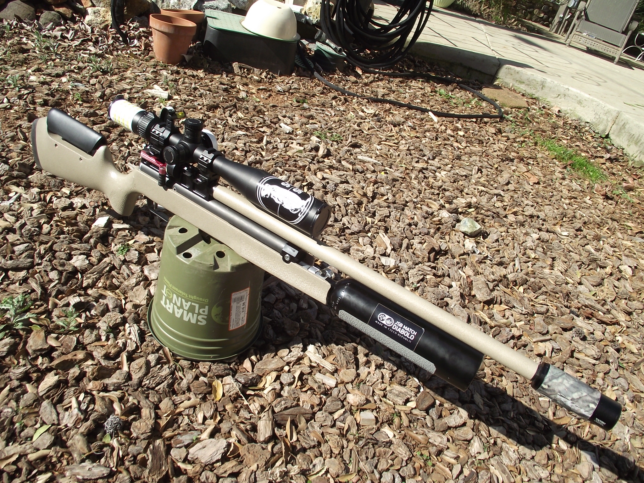

My own built custom ....
Marauder G2 based with ONLY the Trigger group, Partial stock, Partial air tube being semi original.
Every other part & piece from someplace else.
Cruises at 90fpe and leaned on near 130 fpe.
Accurate to a shooters fault.
If its only the trigger group and a piece of the stock and air tube from a Marauder…
… that’s a “Motorhead G1”…. not a Marauder G2, lol.
