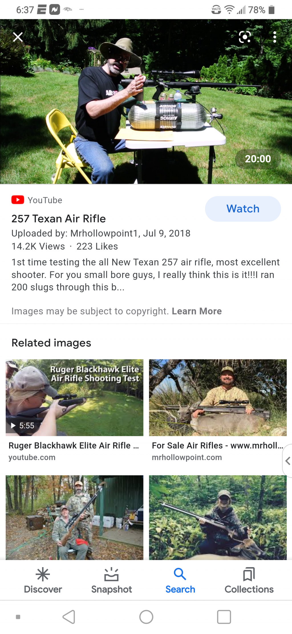

@Jaydog, Having problems posting link. Go to Youtube and watch Mr Hollowpoint.m video on tuning the Texan.

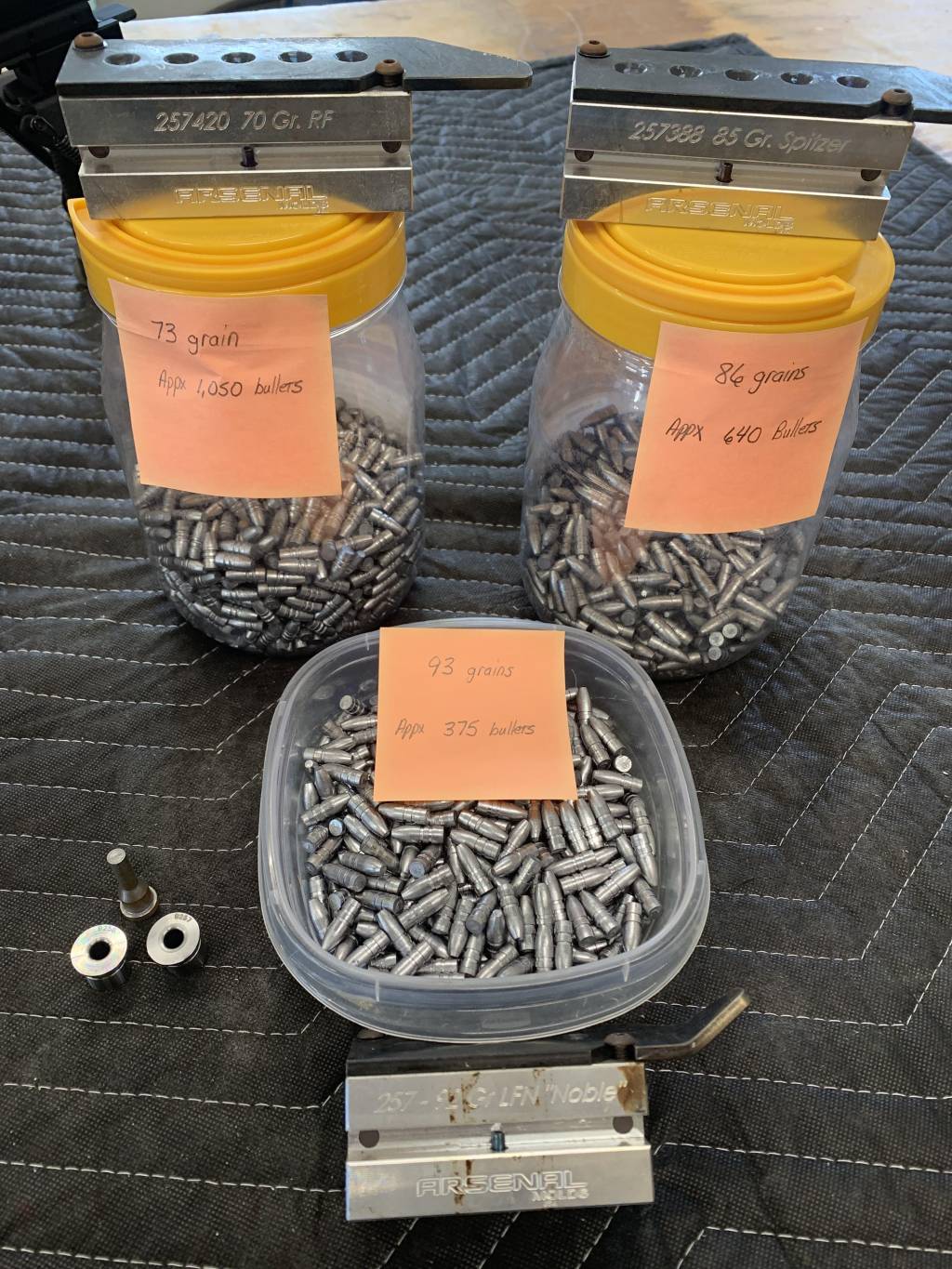

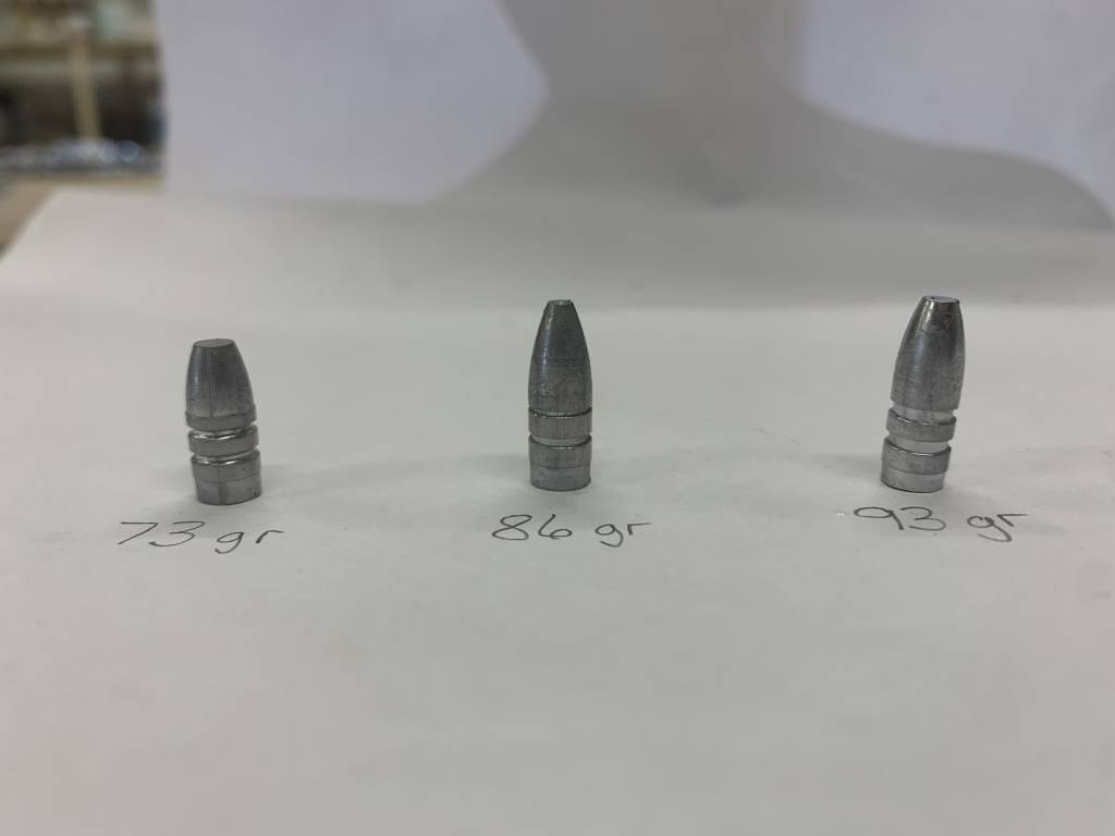

I have a .257 Armada with a 1:14 TJ barrel liner. I've tried a few slugs and so far nothing better than this:
http://arsenalmolds.com/bullet-molds/257-Bullet-boattail
Lubed and sized to my lead-in/barrel.
Shoots good from 920fps to 1030fps. Currently shooting at 990fps and they hold together well out to at least 300m.
Casting your own gives more control, or you can buy them:

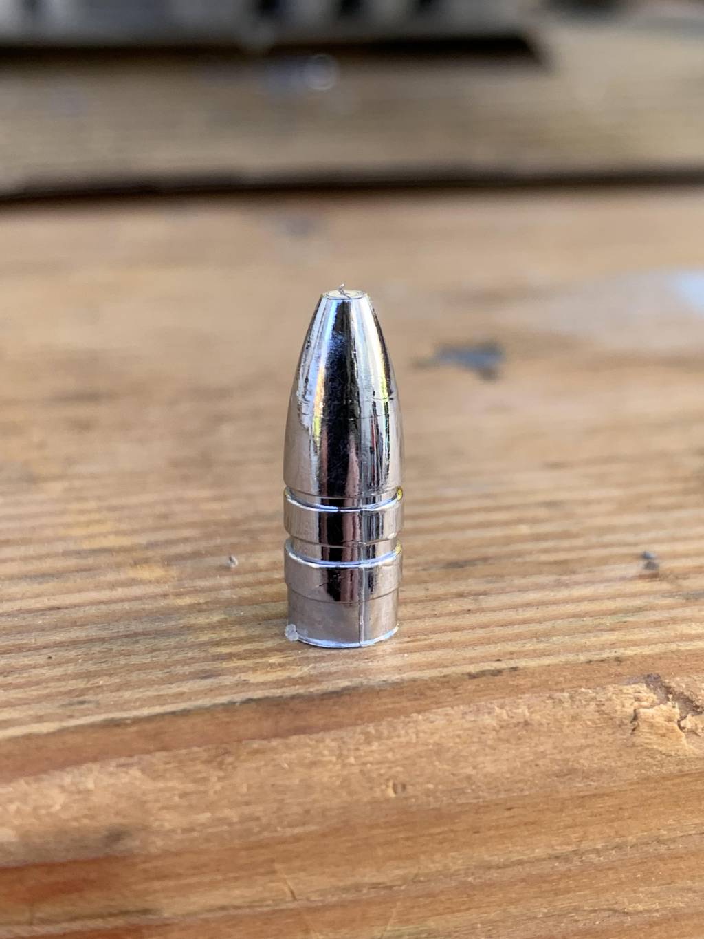

Texans have barrels that are not the smoothest. I would clean it until there's no lead residue, then run some patches with J-B Bore Bright. Re-clean until a patch comes through clean as a whistle. I then lube my barrel with using 10 weight RC Silicone Shock Oil. I use the same lube for my cast bullets.
As far as I'm concerned a 257420 bullet / bullet mold is the place to start with a .257. On your Texan you'll end up with the best accuracy at very low power. That should be about 950-1020 fps with a 72 grain bullet. Beyond that you will scatter your groups.
My favorite bullet molds in order of accuracy and preference:
Arsenal 257420 or 257420 with Boat Tail
Noe 258-75-FN-BQ6 4 Cavity RG4 BT - With hollow point I got the best 100 yard groups with this bullet.
Arsenal 257388 85 Grain Spitzer Bullet - is promising but so far I have not found it's sweet spot.
Heavier bullets are just going to disappoint. the 257420 or Noe 258-75-FN-BQ6 will go in one side of a big turkey and out the other. You can hear the impact.
Size your bullets accordingly to the bore.

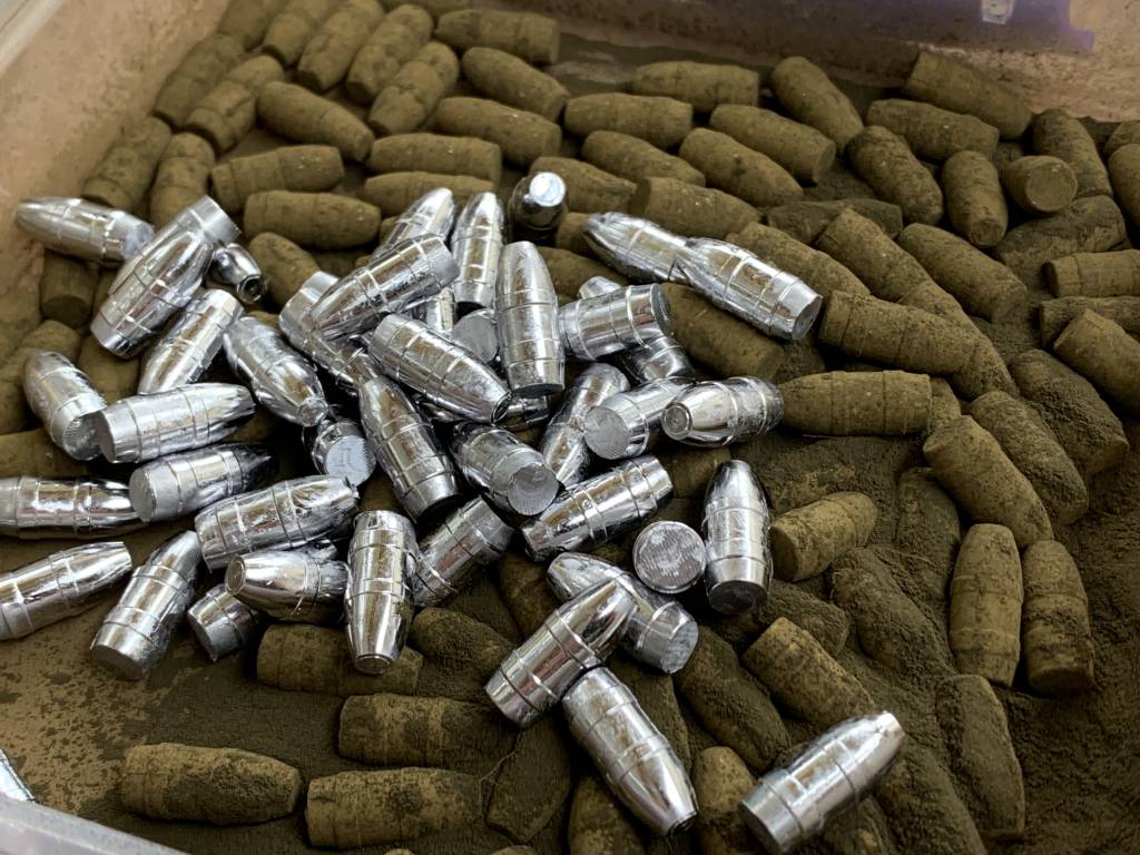

I cast with pure lead when possible. If I have trouble getting the mold to fill out I will add a button of tin to the pot.

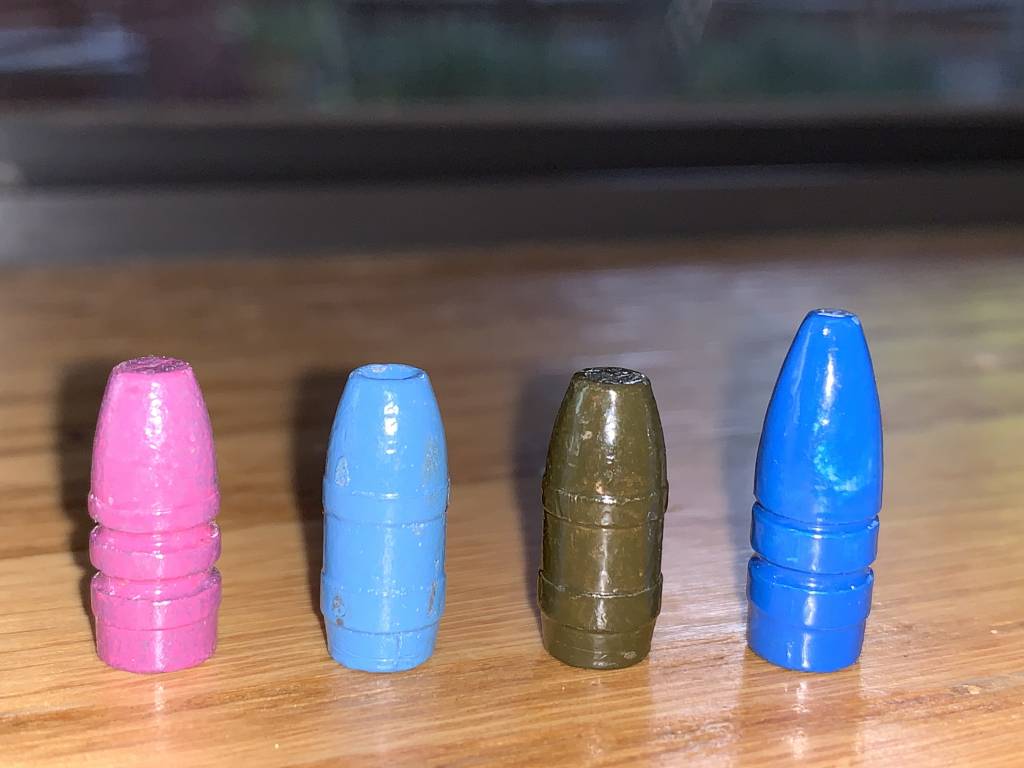

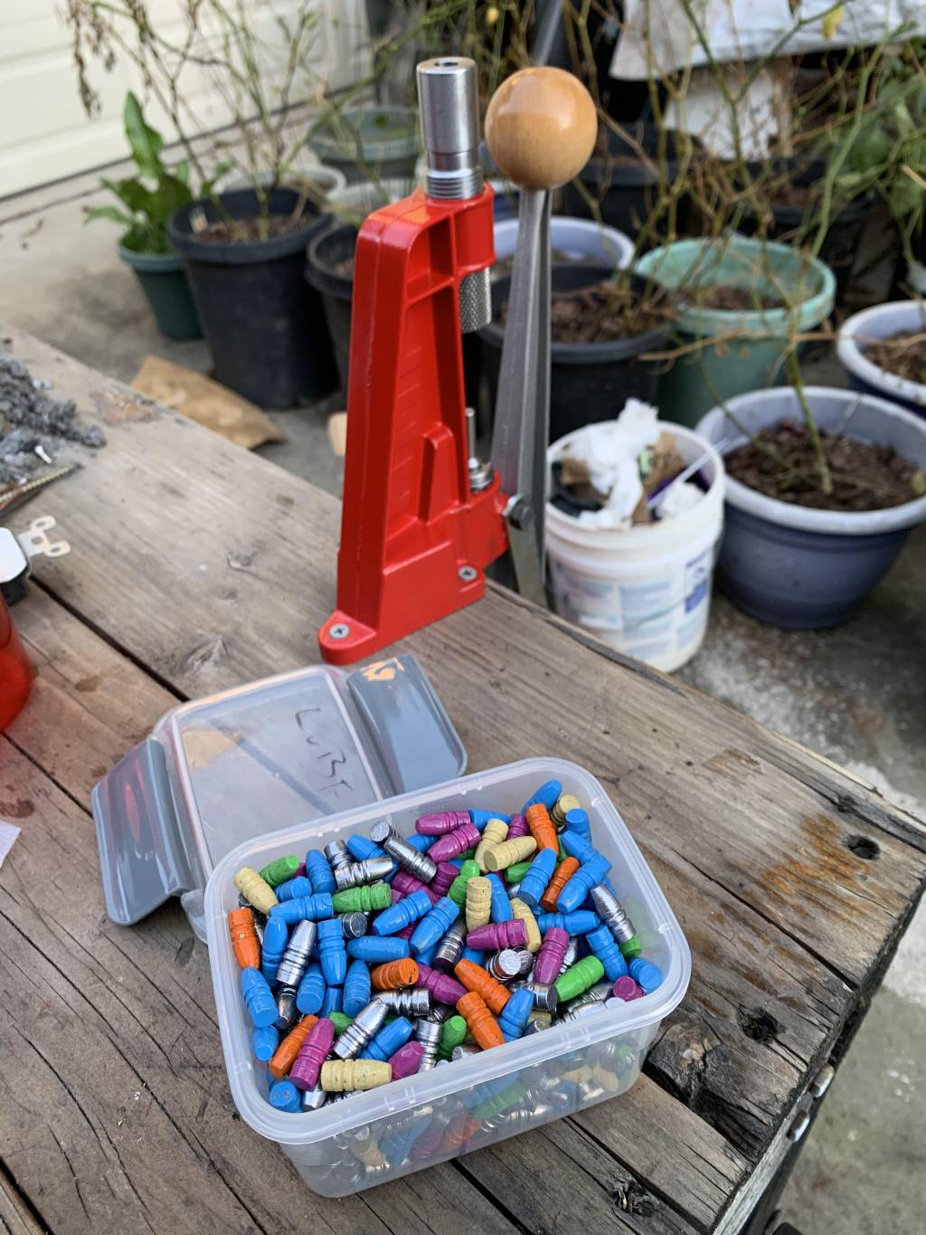

In conclusion:
1. clean barrel - keep it clean.
2. lube your bullets.
3. Size your bullets

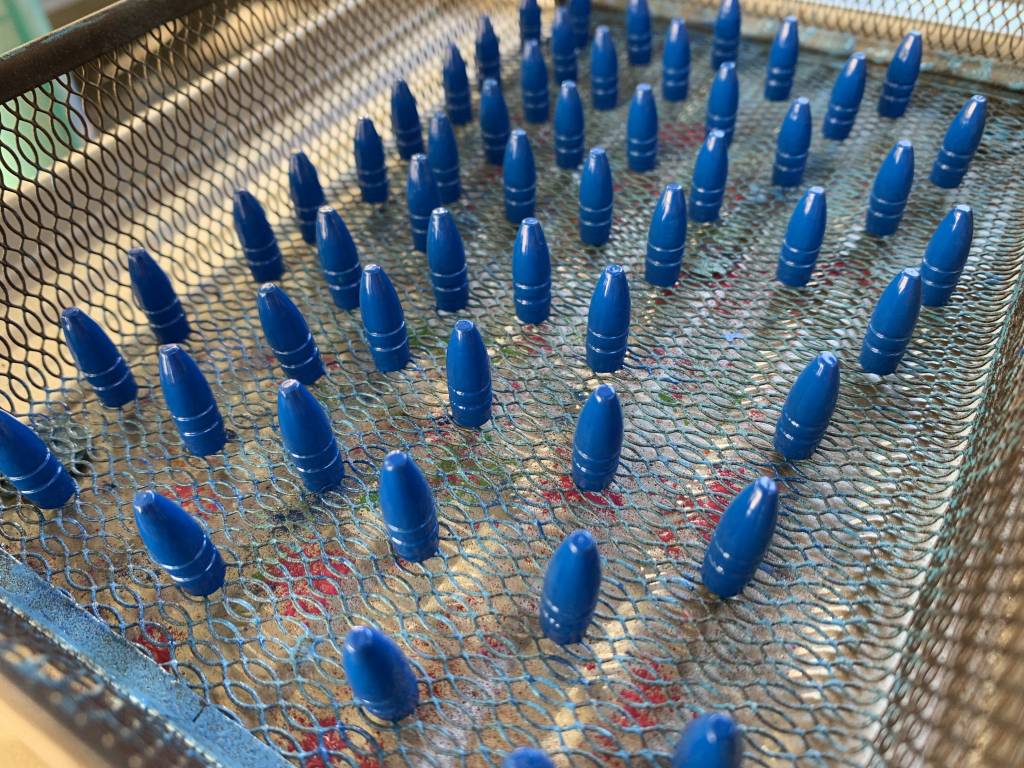

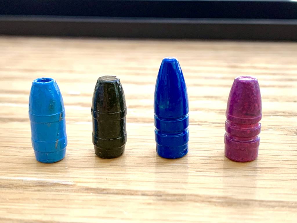

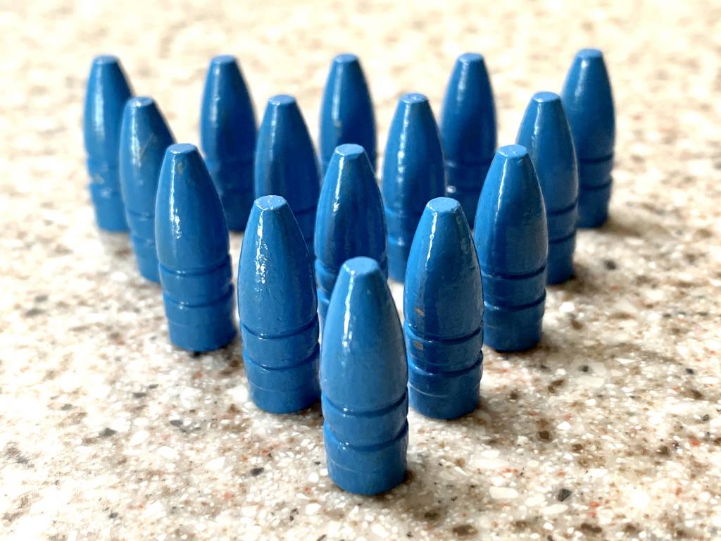

4. Optional is to powder coat, size and then lube bullets. I do this religiously.

Not the same as the Seneca at all. I pour my own 257420 BT. Takes a little practice but when you mess up, just remelt them.
