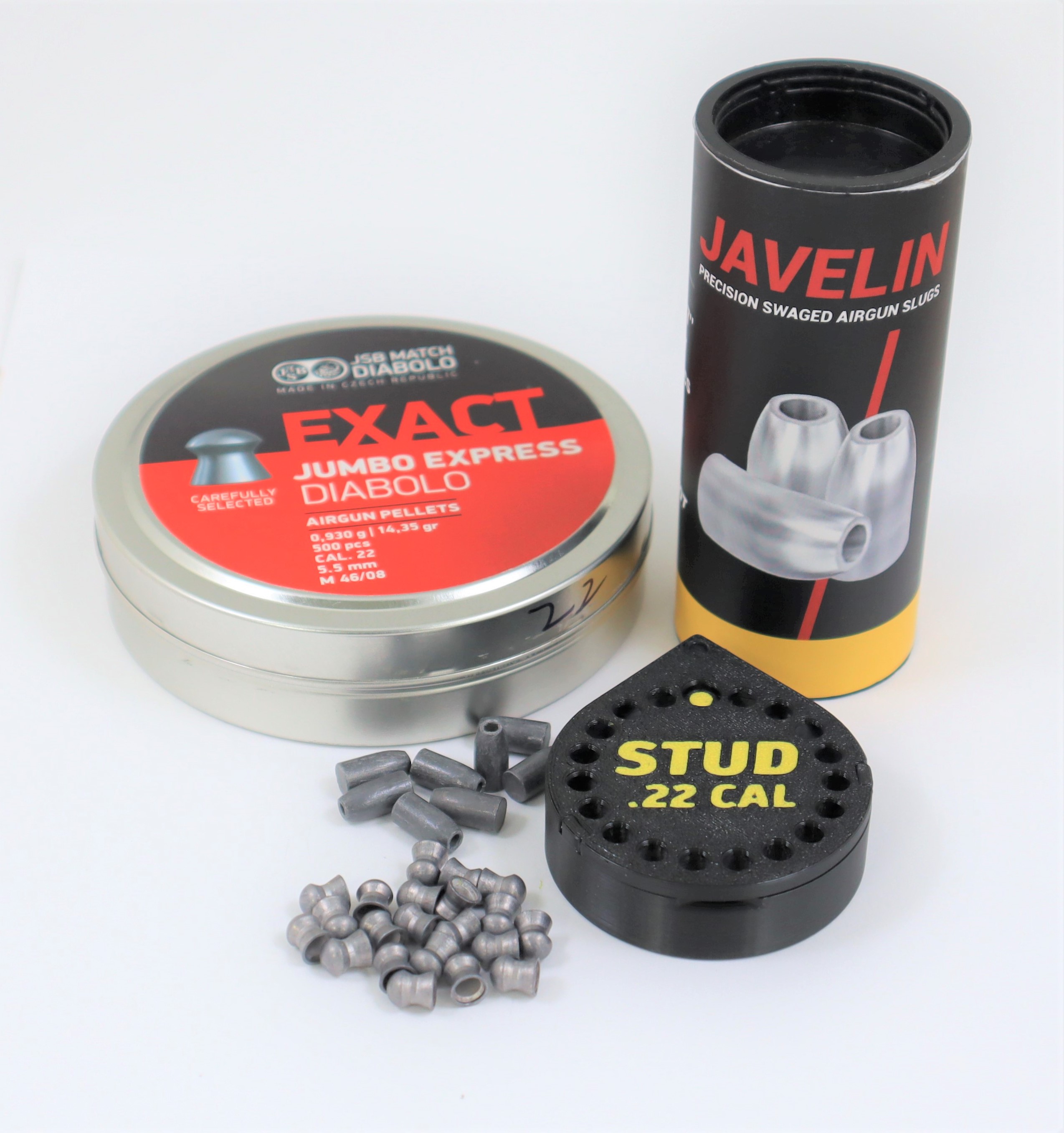

STUD is pleased to announce its newest magazine for FX airguns, specifically the Maverick/Dreamline/Crown/WKMK3's.
This is the new "Factory Replacement" magazine from STUD and currently available in .22 x 18 rounds (more calibers to follow).
Like its big brother for the Impact, it features a roller bearing on the center rotor for glass smooth rotation. In addition it has the industry leading "STUD Pocket" for excellent round centering with the barrel.
Dual magnets on the lid allows for easy lid removal and installation without the twisting latch like the factory mags.
These mags unlike the factory mags will accept slugs or pellets (like the 40gr's from Javelin etc.)
Of course this magazine is fully compatible with the STUD Feeder/Loader system for the easiest loading of a magazine in the industry. Pour, shake and the loaders are ready to fill.
The mags are available individually or as a bundle ((1) Mag, (4) Loaders and (1) Feeder).
They are in stock at all STUD dealers or directly from STUD.

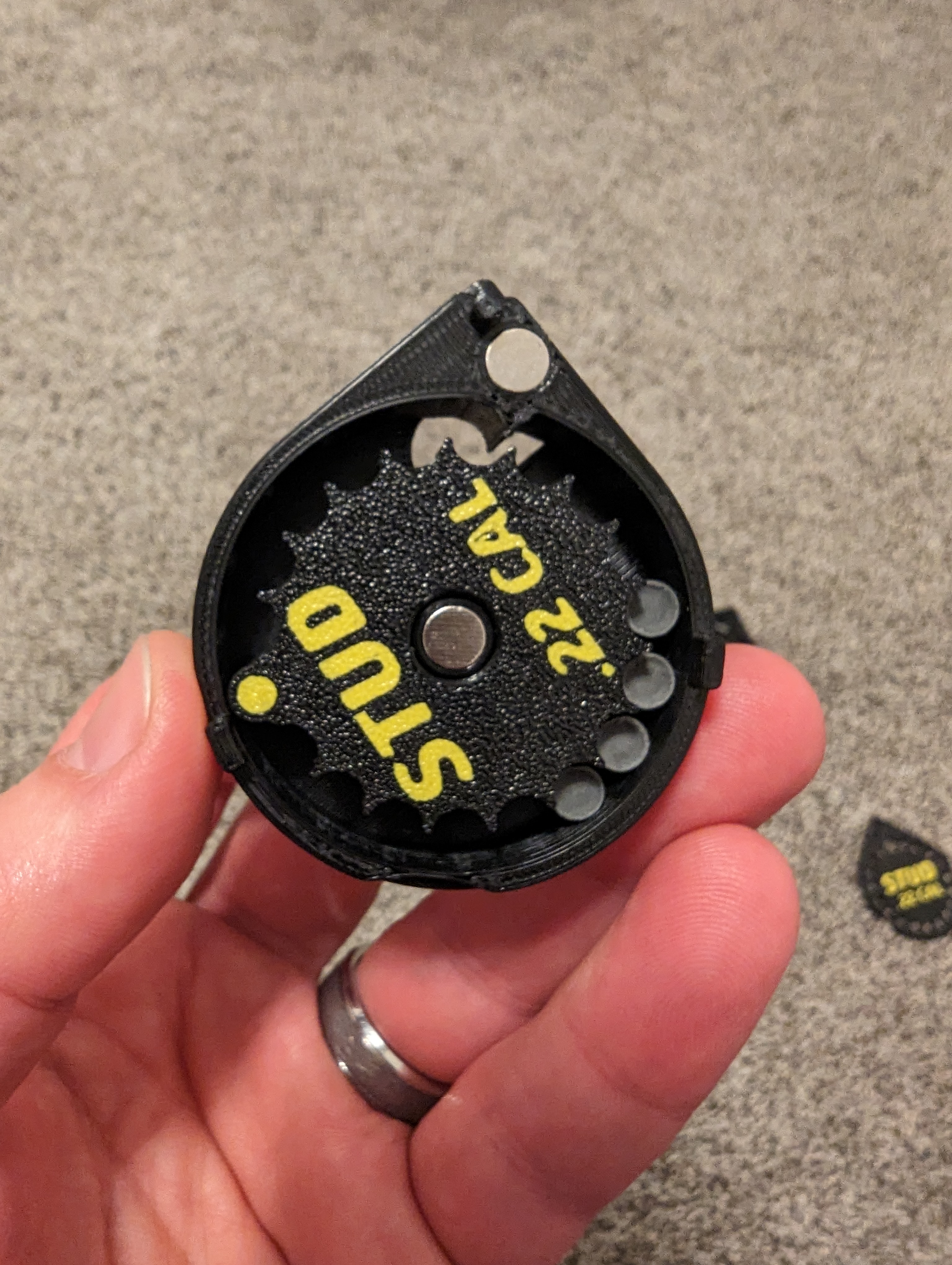

@douglashepler I love the Impact mag, so I thought I'd try this one out on my Maverick. Unfortunately it has an indexing problem. Maybe it's just with shorter slugs, but the feed wheel gets very easily stuck. These are 25.5 gr Zan slugs in .217. There are no obvious manufacturing defects, and the wheel will get stuck in various positions (not just the one pictured). It happens more easily when the mag is vertical, ie inserted into the rifle.
Let me know if you think there's anything I can do to fix it, otherwise I'll reach out to my dealer to return it.

So sorry with a delayed response, I just saw this today. Yes, with really short slugs with long front leads, they may not be enough of the .217 diameter to be stable in the mag. Get with the dealer you ordered it from and they will take great care of you. We will make a note of it in our ordering section to avoid this with others. Any issues send a message to us through the STUD website. Thanks so much for being a STUD customer
