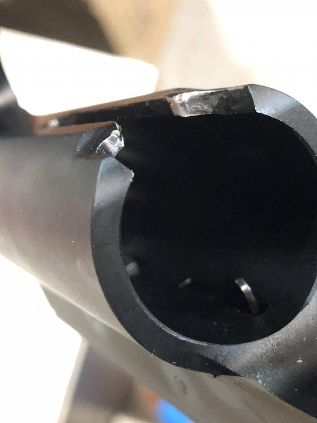

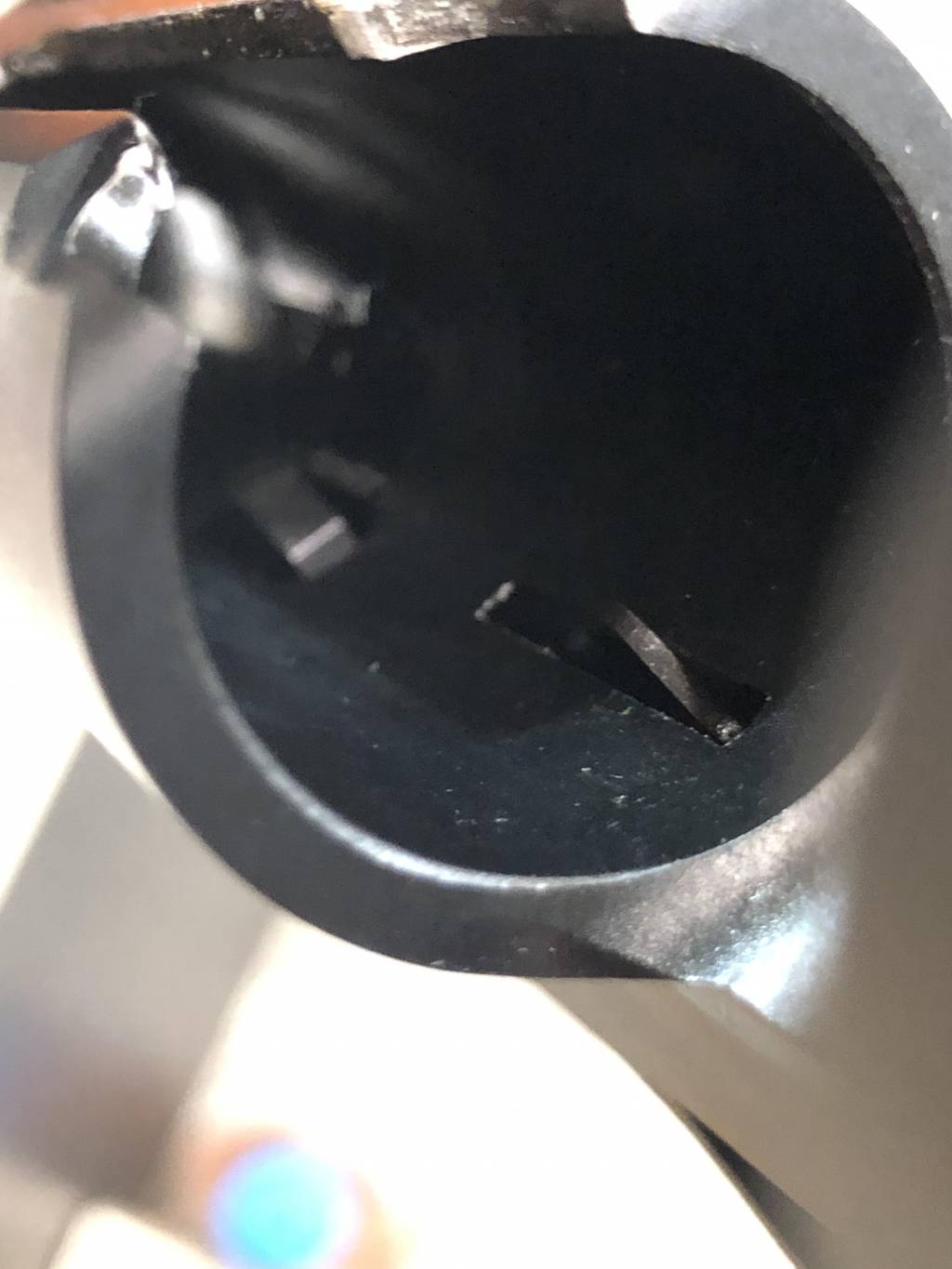

Can someone help me get my .25 back in action.I have the barrel out now, I see the safety tab is up in the "safety off" position. and when I switch it to safety on, the tab goes down. The trigger mechanism up in front of the safety is up. So can I knock out the pin for the auto safety? What am I to do? The first pic is with the safety on, the second is safety off. I'm at a loss.

Try the factory spring to se if something is damaged first...some frames don't like heavy spring not by the weight of the spring load . Is because the thickness of the wire for some reason..I have to change mine from heavy thick but shoot spring to a stronger n longer in factory thickness spring n both guns are working great...the thicker spring even fire the gun when the safety was taken off n make the trigger pull harder..with the thin but longer spring I have the same power and a way better shot circling ..
Mercado, thanks I will try that. I did punch out the auto bar last night and finally decided to open the trigger assembly to take a look. I had to fiddle with the levers to get the one to retract up in the shroud to let the hammer slide past. I don't remember if I hit the trigger or what sequence of decocking the gun happed the first time I installed the new hammer and spring.maybe that was the problem. It was 2 a.m. when I stopped. I am going to go finish it up this morning and see if I fixed it. I was crosseyed and pooped messing with that thing for 4 hours.
I am new to the PCP world, and man, I love it! Funny thing is, I upgraded my Texan about a week later. The directions were different. AAO told me about tripping that lever in the assembly to get my sping and hammer in and out. The pdf I got for doing the .25 did not. Their directions are for removing just the barrel now that I think about it It didn't dawn on me to rewind and do the same to my Condor until last night. If it doesn't work here shortly, I will put the lighter spring in and let ya know.
