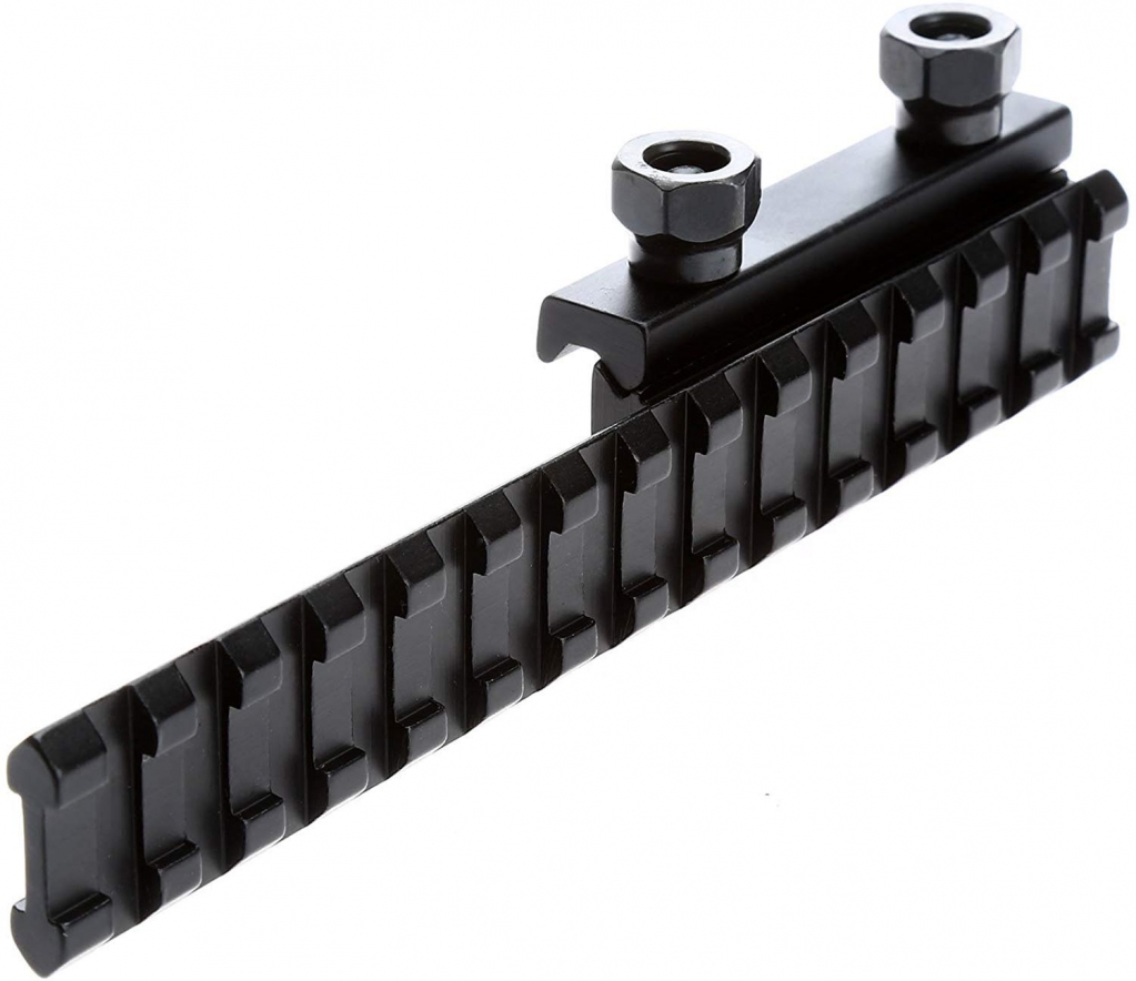

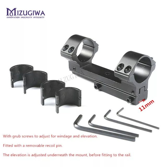

The magazine is up to 7mm from the dovetail 11mm
this picatinny rail is 145mm long can do the job

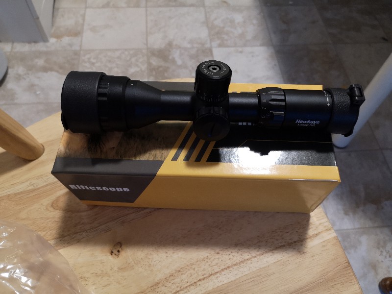

I just received a Konus AS34 2-6x28 for my P-Rod.
It has a built in mount that can be flipped. It's dovetail on one side and picatinny on the other.
The way it fits on my P-Rod the mount is only in front of the magazine. I'm not sure it it will work in the PP750 but I thought I'd post it.
Here is a picture mounted direct on the dovetail side. The built in mount is just under 2.75" long, or about 68 mm.
It's a bit low for the P-Rod and will need a riser unless it would be used with a single shot tray only.
Note that this scope has parallax fixed at 100 yards. Unfortunately I didn't realize that until after it shipped (long story). To my untrained eye it looks like the parallax can be adjusted on this model but I'm new to all this so I posted over on the Optics forum.

I forgot to mention that as the scope is mounted above it has sufficient eye relief at 6x to sit that far forward on the P-Rod.
I think that would be a good trait with the PP750 so the back of the scope and the telescopic stock are close to even when in the closed position. I've also tried a Bugbuster and an inexpensive Hawke 2-7 that just had to set too far off the back of the gun for sufficient eye relief.
I eventually want a folding or telescopic stock on the P-Rod so short eye relief scopes have pretty much been ruled out. Obviously a P-Rod and a PP750 aren't the same gun but with the forward dovetail I saw some similarities and wanted to post what I have found so far.
