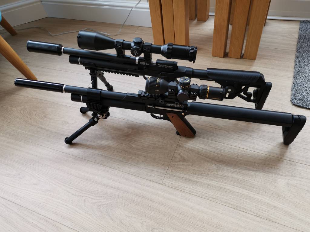

Finished both the .177 and the .22
These Carbines are superb performers

Wow looks great!
do you have forum links covering your stock mod and the barrel support/Bipod rail?

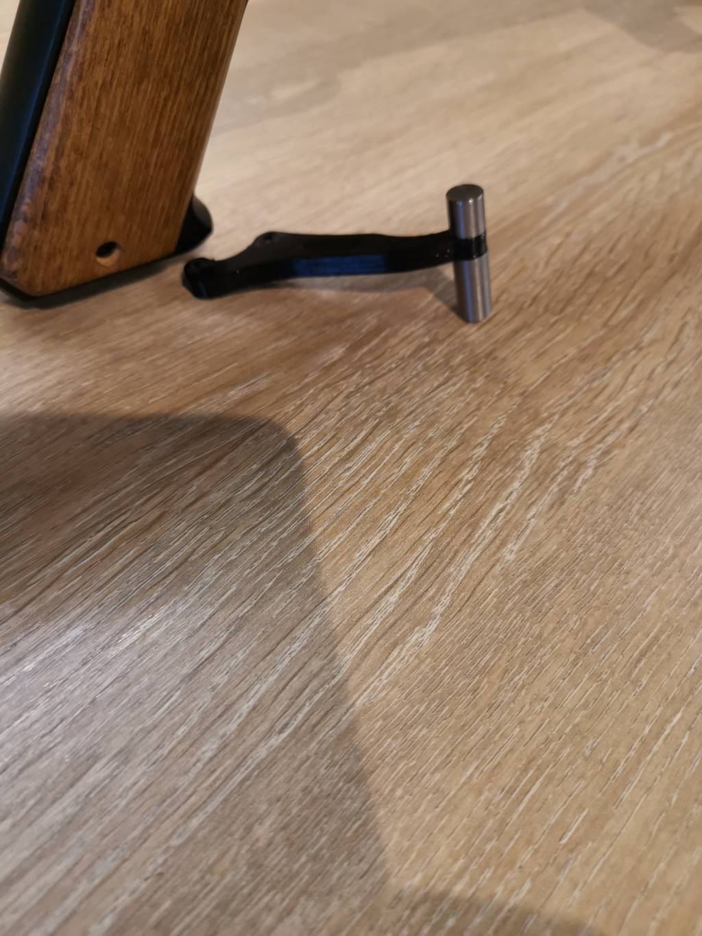

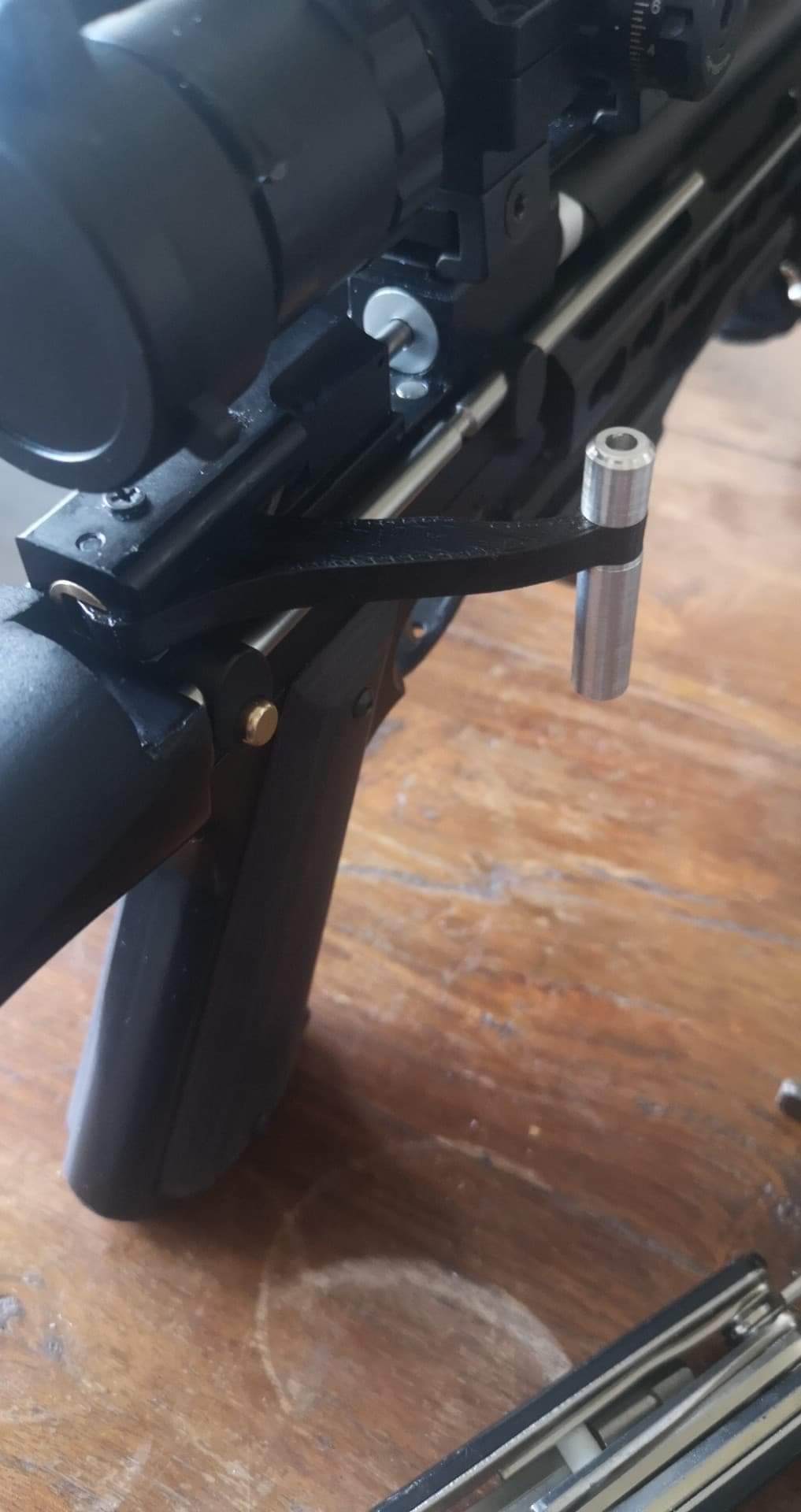

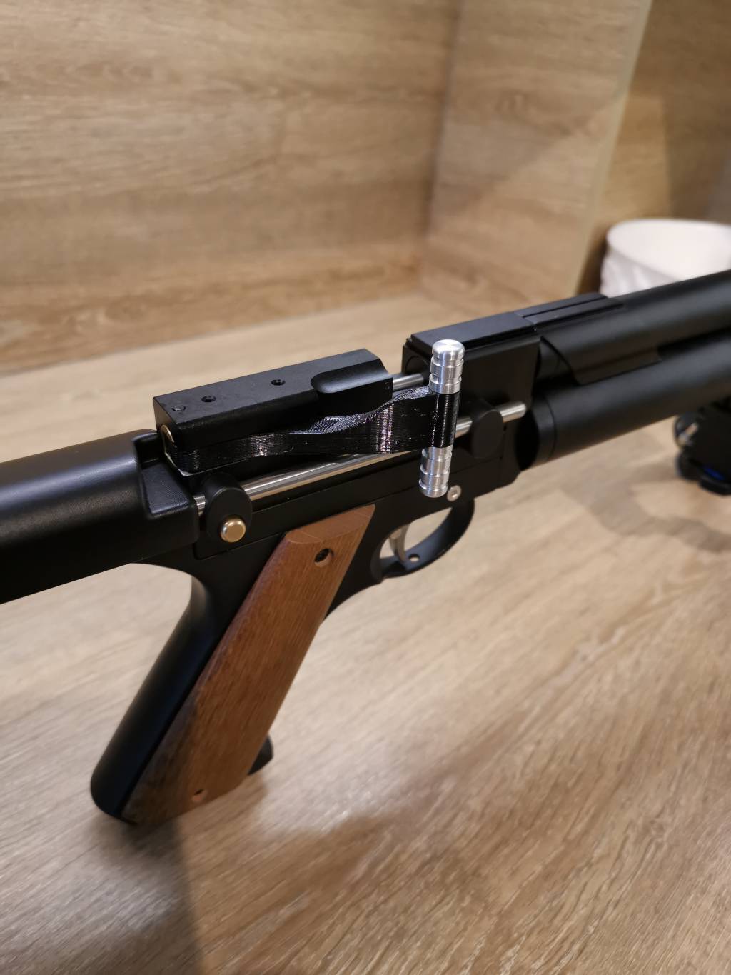

How has the 3D lever worked out so far? I'd like to have one of those cocking levers. Could you post a pic with the lever in the fully closed position please.
I’ve actually had to ( 1st time in a while ) do some work, damn employer getting above their station...
so not yet fitted, they will be sorted and a review done by the weekend.
