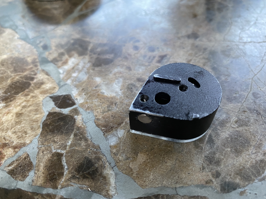

Thanks for the advice. Can you show a pic of the rounded edges on the mag?
Just a half mm off the corner keeps it from catching.
I thought you were talking about rounding off the edges of spindle inside the mag that holds the pellets. I think get2anthony was talking about the way the pellets get deformed inside of the oem mag and not the CARM mags. Thanks for sending the pic though. That would make insertion easier
I have had that catching/tipping problem in other guns. Can be very difficult to fix, any widening can cause more space to tip into, exaggerated with wadcutters.

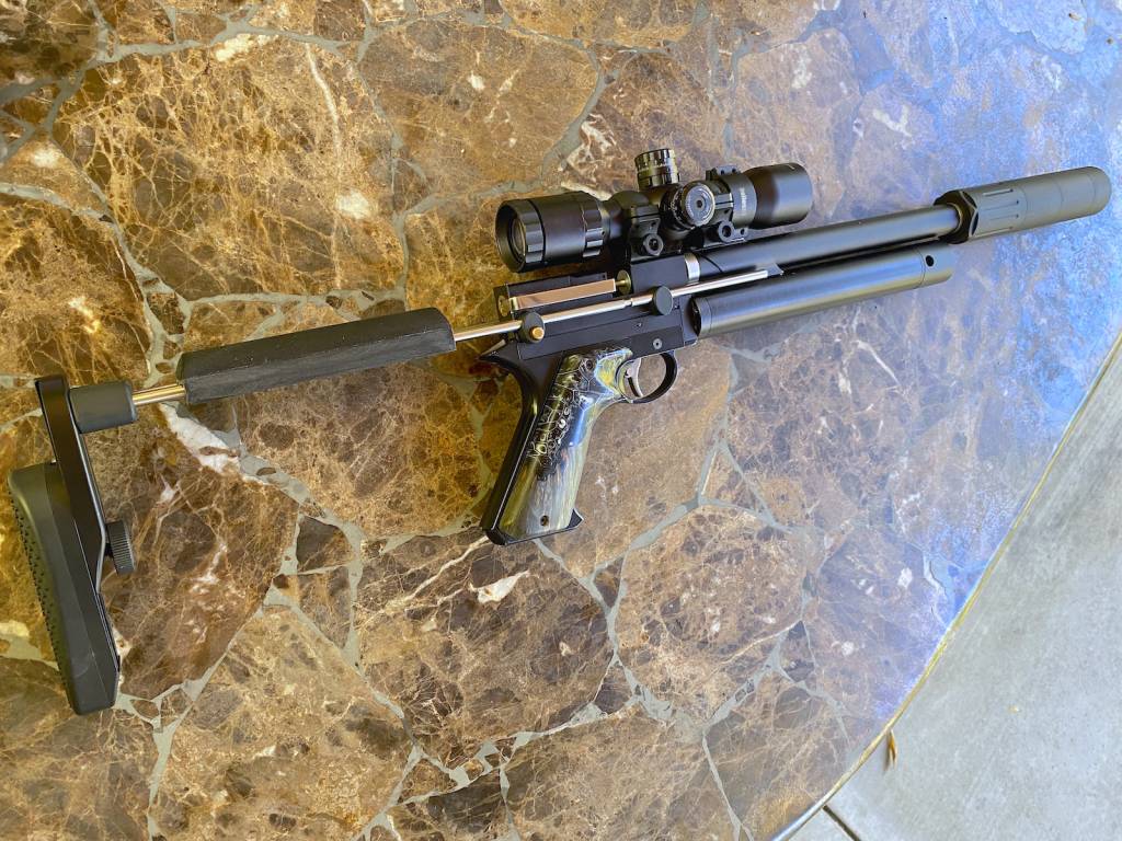

The PP750 is really a charm to shoot, I'm settling down with the power mods and shooting a lot to find the sweetest set points for my purposes. A couple of spare magazines would be nice.

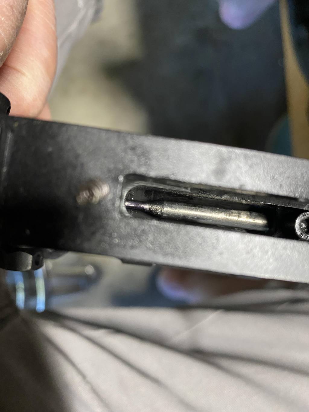

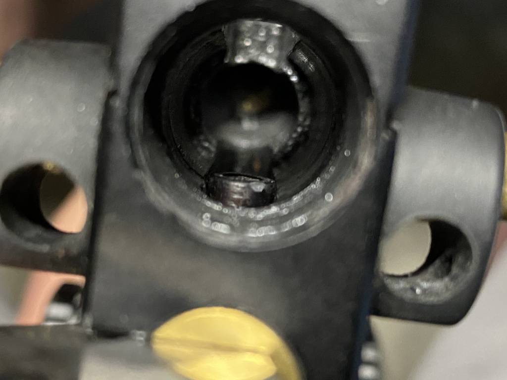

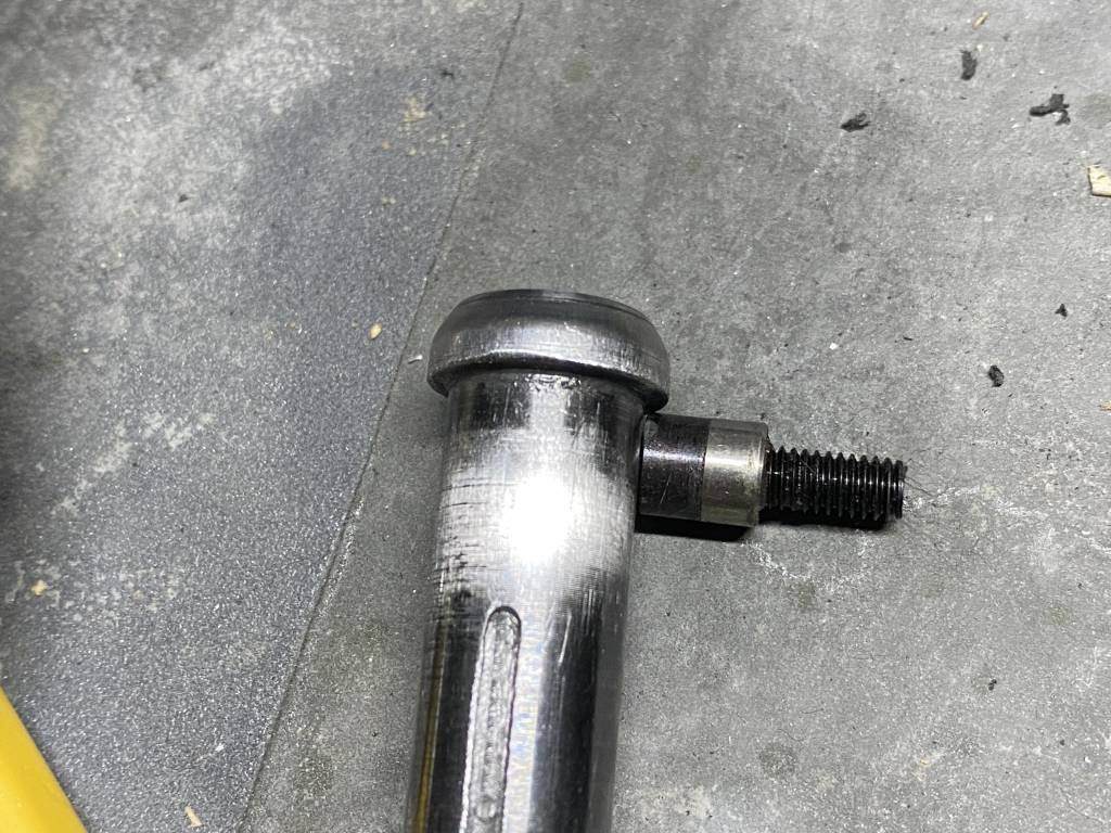

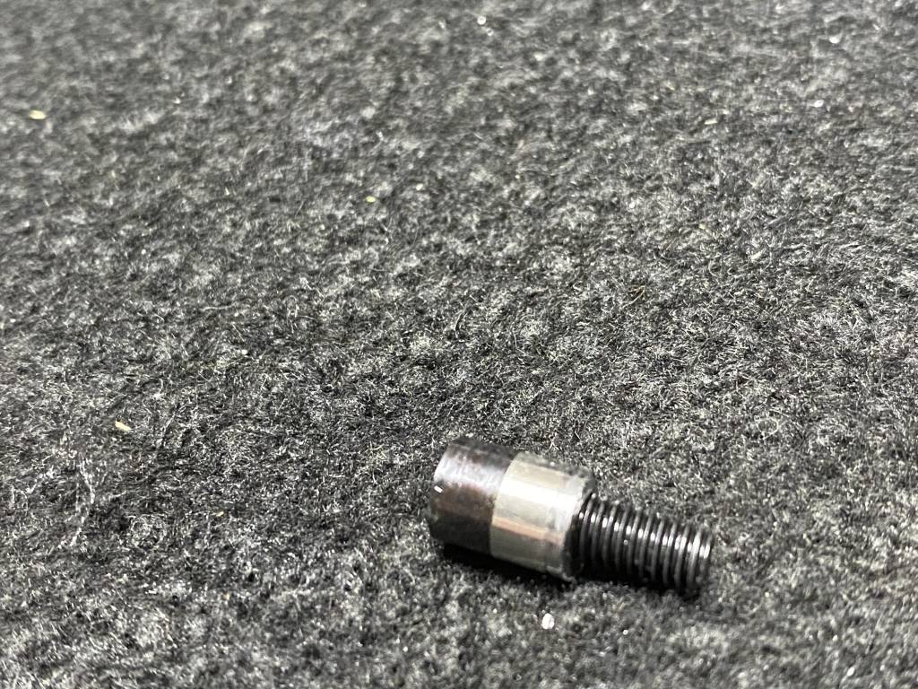

The cocking cycle has some roughness and an occasional binding right before sear engages. The pellet probe is rides on a 1" wide portion that is unsupported by the thinned end at the end of the cycle as it is retracted past collar, then skewing under load, dragging against block bore. There is a machine bolt stud projecting from the pellet probe, overlapping a ledge on the hammer. Unfortunately the overlap engagement is less than 1mm when the skewing occurs. This has lead to wear on the corner of the bolt head which a few times has ridden up and over the hammer ledge causing a major bind.

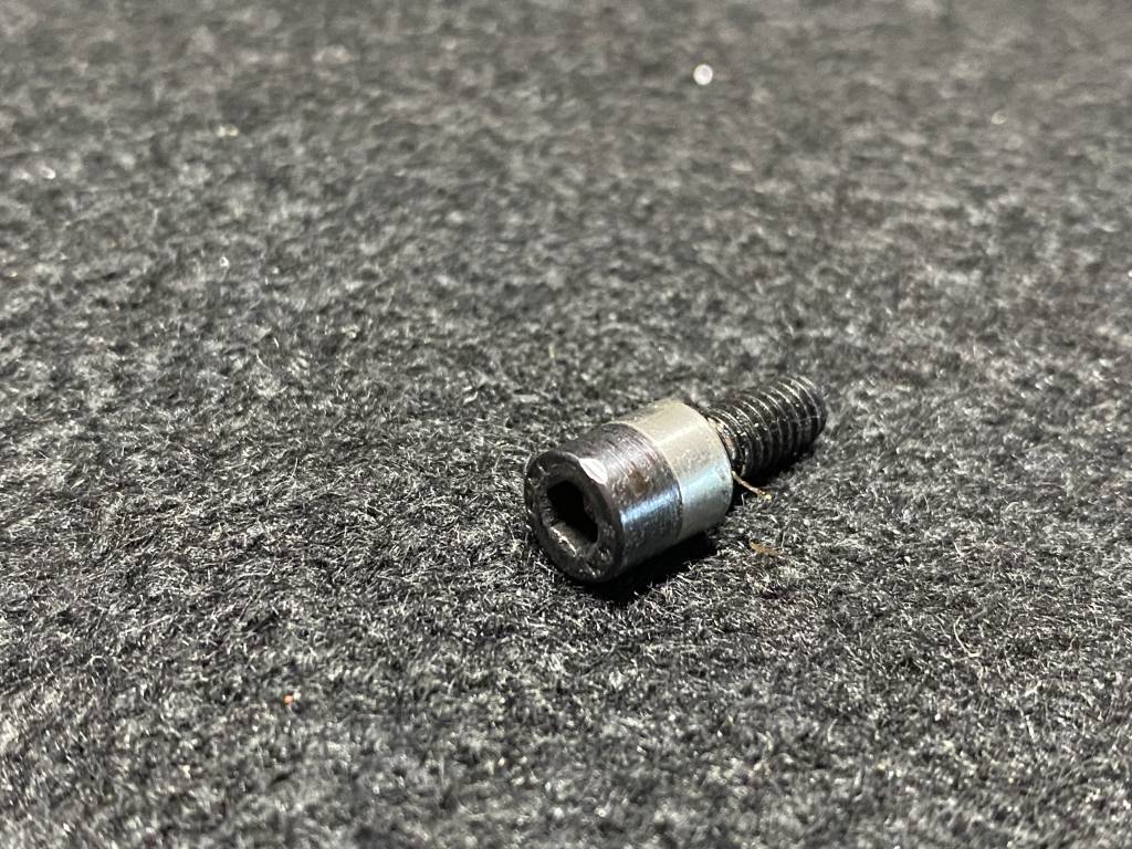

Adding a 0.020" (0.5mm) shim under the machine bolt head increased engagement, no more severe binds. Cocking is still rough at end of stroke, because skewing is still occurring.
I plan to inlet some PTFE slides in the future.
I see the shim in the second picture...that is one thin shim! Got any idea of the diameter of the bolt it goes over? Most of us will be ordering the shim, barring a really good machine shop or hardware store nearby. Is there any benefit to what material the shim is made of?
Given this information, we can pre-order and be ready if and when it might be needed. I'm assuming not all 750's will have this problem.
