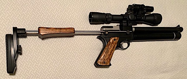

In response to a well-known (and well-loved) forum poster who private-messaged me, I'll share the basics of my custom PP750 cheekpiece; so someone with a 3D printer can reproduce a functional equivalent.

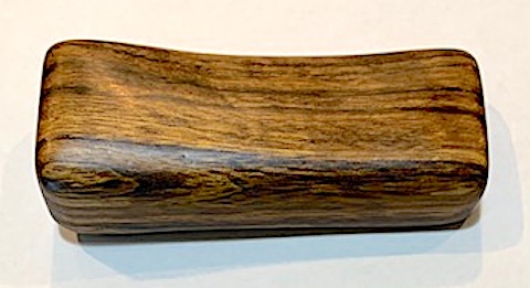

The short answer for those looking for simple functionality is, "Yes. The block is approximately 4.5" long, by 1.75" wide, by 1.25" thick. The rods are exactly 6mm thick, and spaced exactly 27mm apart." But for anyone interested in more information, I should qualify the answer above with the fact that my cheekpiece was custom built to my preferences.
Those preferences-
1) Just large enough to cradle my cheek like a soft, young, inner-thigh; at least as well as (distant) memory(s) serve me.
2) In that spirit, incorporating swoopy, SEXY lines (see #1 above).
3) Continuing in aforementioned 'spirit', a 'warm' wood species with attractivelypsychotic personality (see numbers 1 & 2 above; particularly "as well as (distant) memory(s) serve me").
4) Lacking a 6mm drill bit, I used the next larger-diameter, 1/4" bit.
5) In order to insure the oversize holes did not allow the cheekpiece to slide fore and aft without my wanting it to, I spaced the holes slightly wider than the rod spacing; about 2 RCHs wider (again "as well as (distant) memory(s) serve me").
6) Luckily in that regard, I achieved the non-free-sliding, wedge-fit I had in mind. ("Everybody loves a tight fit!")
Here's a close-up of Victoria Principal's inner thigh... er, I mean, my cheek-piece-

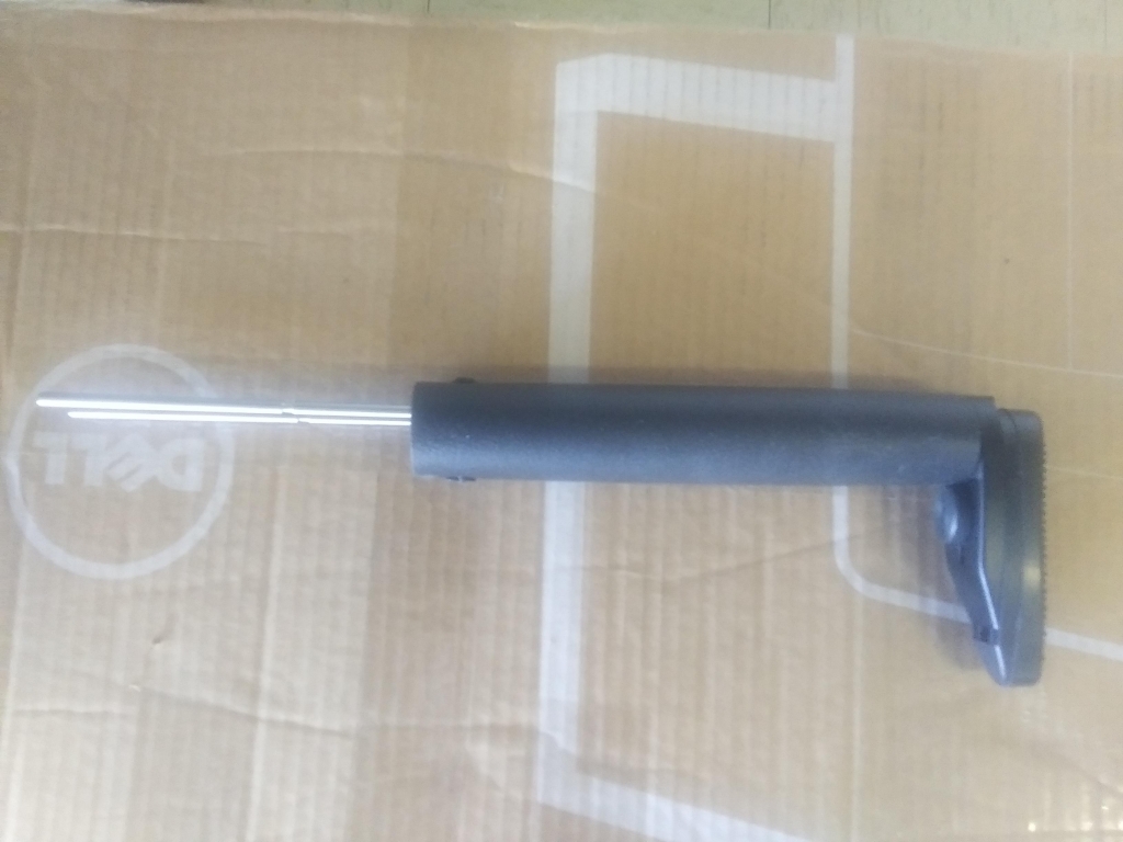

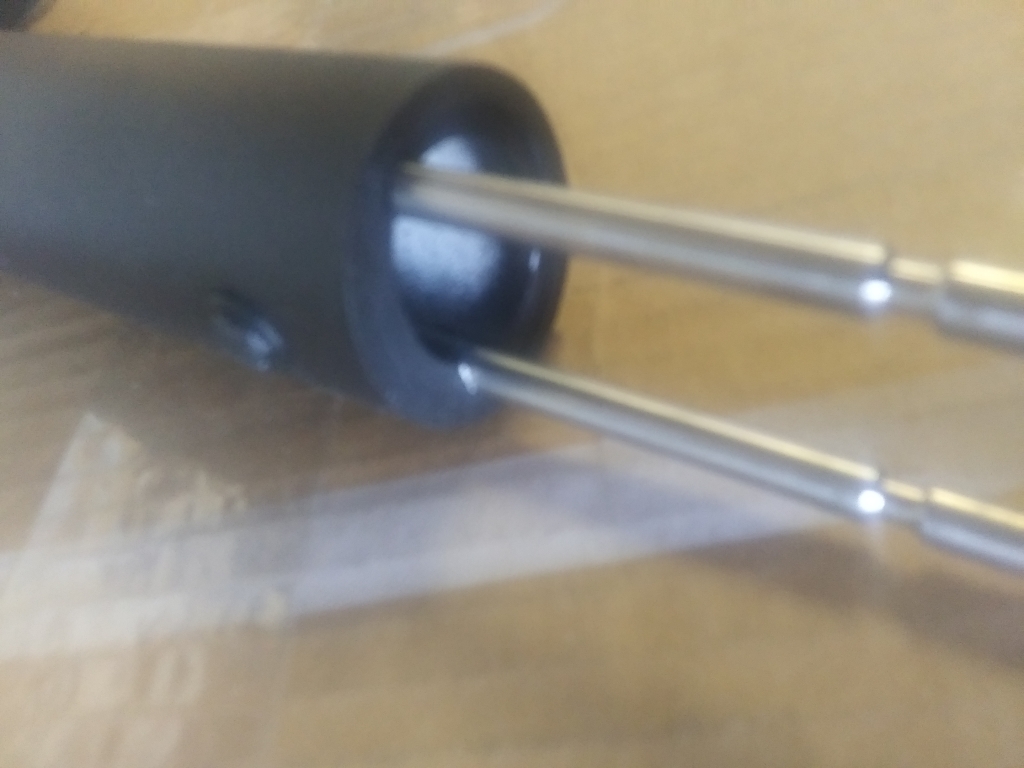

I like the cheek piece, but I'm wondering how you are dealing with the wire stock. It's pretty for anything but the lightest of holds. It's stable up and down and side to side, but it's very susceptible to torsion forces and twists in a wiry kinda way. It looks like the cheek piece would help with that a bit.
To mirror what a few others have said, if someone can make up a bunch of these I would most likely buy one. I think the best design would be a top and bottom piece that squeeze and hold the stock wires tight.

My cheekpiece stiffened the 'wire' shoulder-stock enough to render that a non-issue.

As much as i think I might have been the one that started this thread. I have to say that I have been VERY disappointed with this little gun. First off all the baffles were not in the gun. I received a blow up form Wes and all the baffles were not in the gun. Second the strength if the side posts that hold the Metal bars for the stock on the gun are very easy to break, Probably because the bars can easily twist as you use the gun. I attempted to send the gun to Wes for service but the gun was declined at the Border by Canada officials. You get what you pay for I guess. I managed to fix the side mount for the bar by JB welding it as I was afraid that the other side wold break off, This of course left me with a stock that can not be retracted. All in all with the availabiltiy of NO ONE to service the gun. the fragility of the parts this is not a good investment. Sadly I am with a gun that breaks the side posts easy and no wat to service the gun.. Also I found myself with a gun that after a very short time the trigger would no longer stay in place. The trigger would just fall forward. Th thought that maybe a spring ws missing afte several uses. NO there is a very small thin white piece of plastic bar that keeps the trigger from falling forward. That broke, and I managed to replace it with a spungy piece of plastic that I took from the outside of a pen. Again not being able to get harts and the fact that this piece was actually pressed into the prt of the gun leaves this very easy broke, Trust me here I have Daystates, Air Arms and other guns that work for years. This little gun is basically a bad investment. especially when you can not get it serviced. You will surely experience the same problems.
