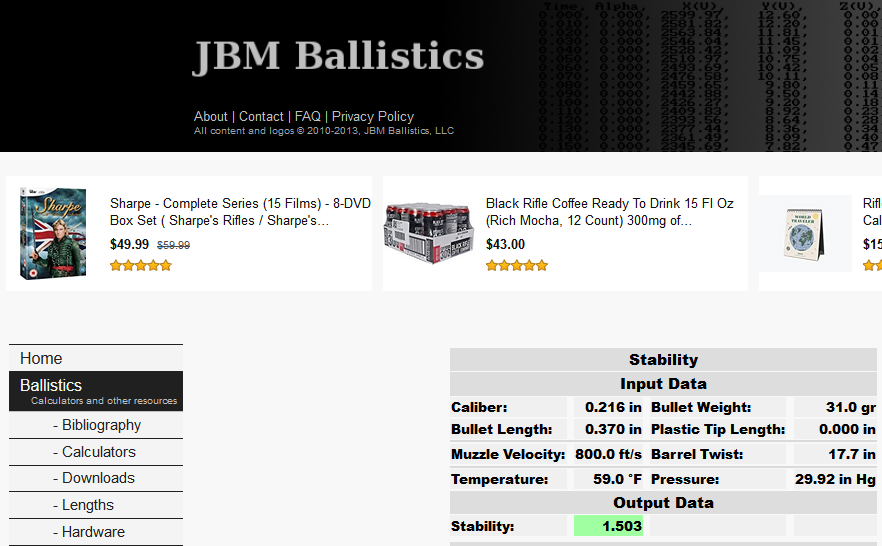

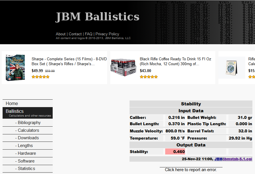

since I'm back and I find that an airgun with a barrel with a 1:32 twist was probably used, then it's not worth talking about the possible accuracy at all, since it goes against the basics of ballistics, since slugs = bullets behave the same as bullets for firearms and require basic ballistic prerequisites for stable flight, and the most important thing is gyroscopic stability, which firearms shooters who reload or test their own cartridges clearly know that the value of the stability coefficient must be at least above 1, better above 1.5 , otherwise the projectile will not be stable.
For these calculations of gyroscopic stability is used Muller's formula or Greenhill's formula.
Here is an example of a calculation using an online stability calculator based on the input data. Yes, these are all variables that matter, so the same bullet = slug can only be stable for a certain given muzle velocity, both up and down.
Example for ATP slugs 31gr used pointlessly in the video for barrel twist 1:32 where the stability coefficient is only 0.46, i.e. much below 1 and therefore extremely unstable :
The second picture has narrowed imputs except for one and that is the barrel twist 1:17.7 (standard LW airgun barrel), here the stability is 1.5 and thus the condition for a fully stable flight of slugs is ensured.
Additionally, BT (boat tail) slugs or bullets like Altaros ATP slugs are more prone to gyroscopic stability than flat base slugs or bullets.
If AtlasAirguns knew at least the basics of ballistics, he would know that he was doing an absolutely pointless test, and if he knew them, then he was deliberately doing a falsified test according to the presentation of his results.
Of course, stability is a secondary issue, because if you put a small diameter slug in a large barrel, there will be no rotation at all, since the grooves will not hold the projectile and the only rotation will be provided by the choke at the end of the barrel, but by already deformed slugs

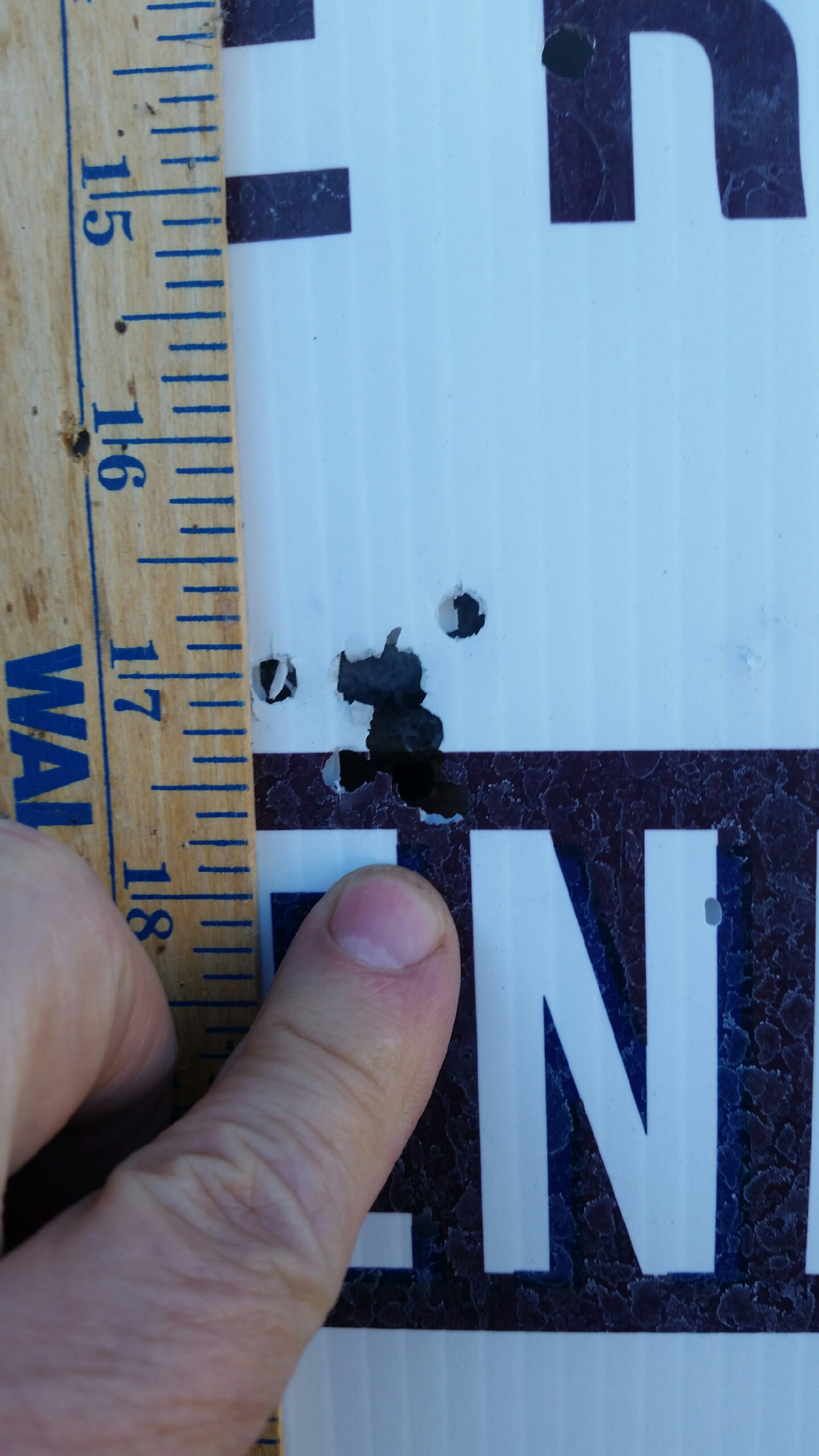

only 40 yds, off bags, 16 shots, Huben K2021 25 cal Altaros smooth 6.45 for Hubens/Leshy
