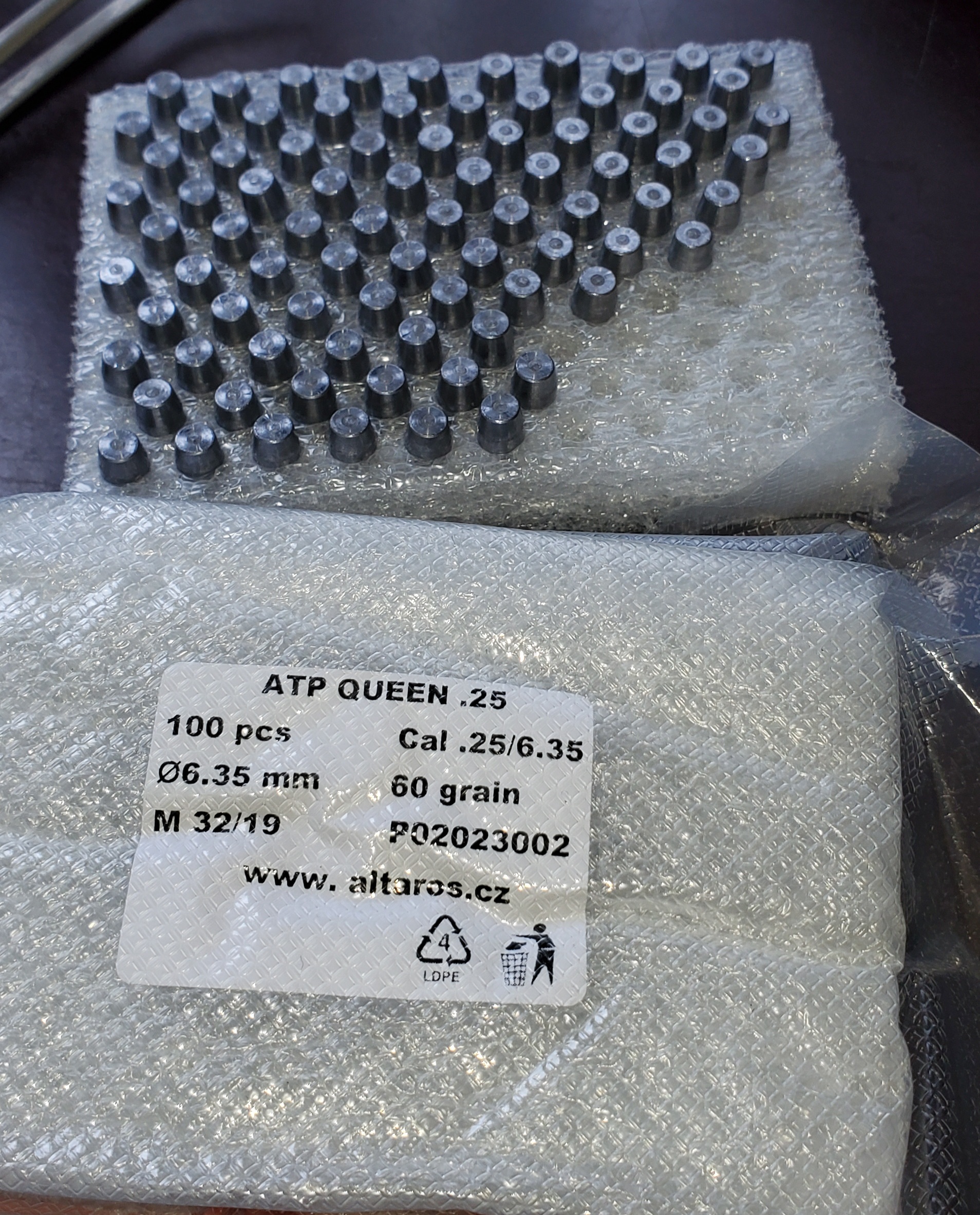

New slugs Altaros ATP Queen .25 60g - BC 0.245 - suitable for FX Panthera magazine
Hey looks who is here. Thanks Orion. Are you able to make it so the mags can hold a 14mm slug? I sanded down the lip on the cap to make it work for me?
I think so! I’ll check tomorrow the design but I was able to make a lid for the Maverick that works with 40gr slugs and the Panthera lid has more space that I can reduce a bit. Send me a private to keep talking about this over there, really don’t want to hijack the thread
Well I got my 60gr .25 Queens Monday so speed in delivery has gone a lot faster (only 6 Days!) Totally quicker than in the past! So I'm very happy with that. But still a bit pricey to buy a large amount of.

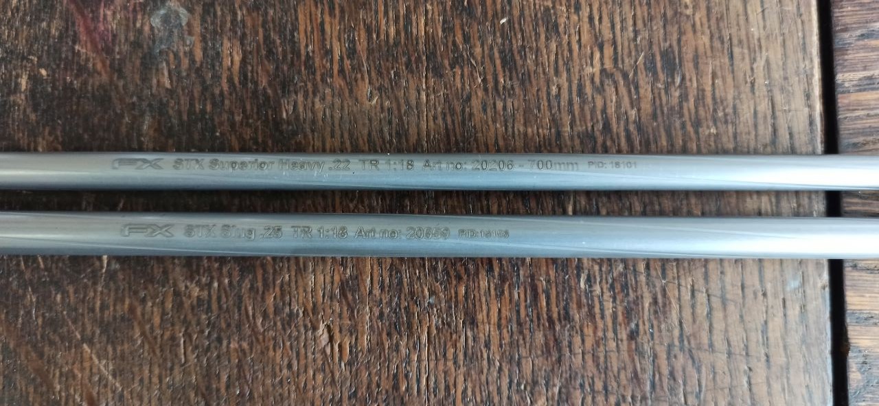

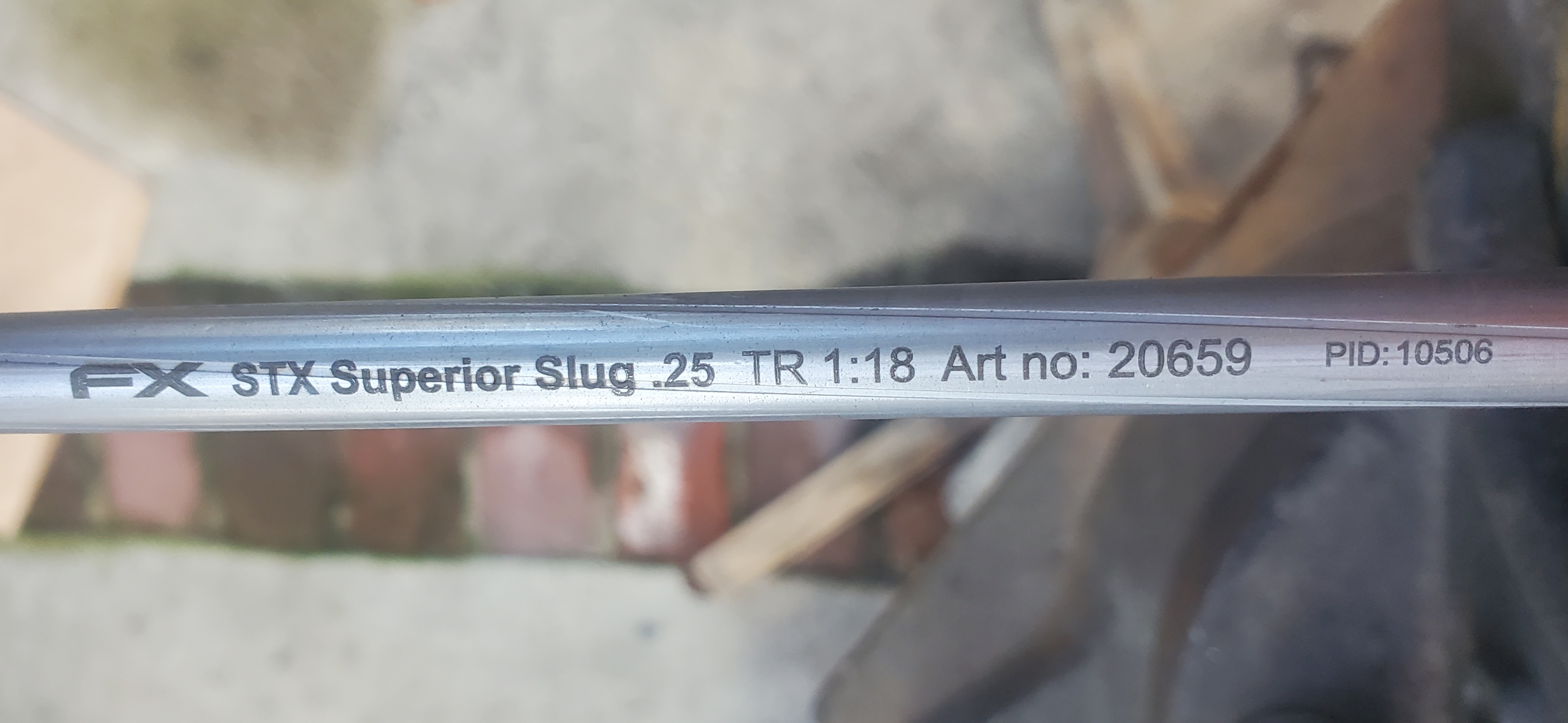

I waited a long time for Krale to have a stock a 700mm .25. I buy all barrel at that Krale under the shop name Superior Heavy. I just checked and found this.
Either Krale made a mistake with the order, or my FX makes a big mess of markings or barrel types.
Both have a twist of 1:18, but who knows what is actually what.
I don't know how inaccurate they were, or what was going on, but unless it was a supported barrel, I don't think such a ridiculously thin tube could stay stable at this power and slug weight.

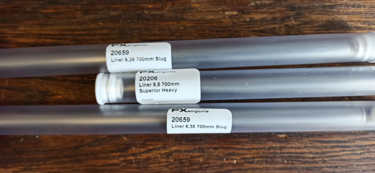

From my research the one that just says slug is the better most recent one and the one that say superior slug is not. But since you have both you can test. Or send the one that says slug to me. I will buy from you.
I have also read the 20206 is better than both the 20659 versions but I am still early in my research and have not actually compared them myself.

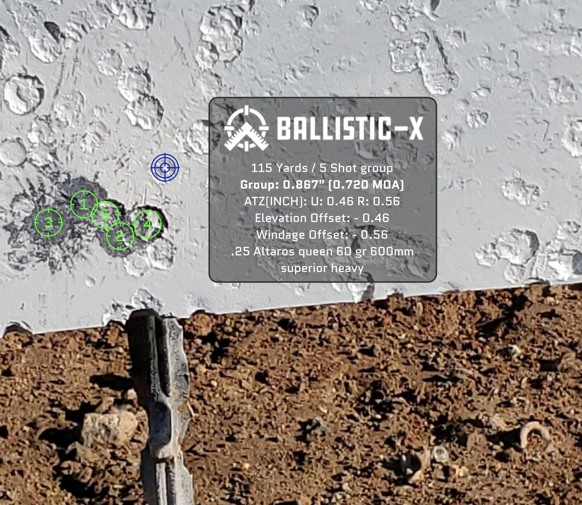

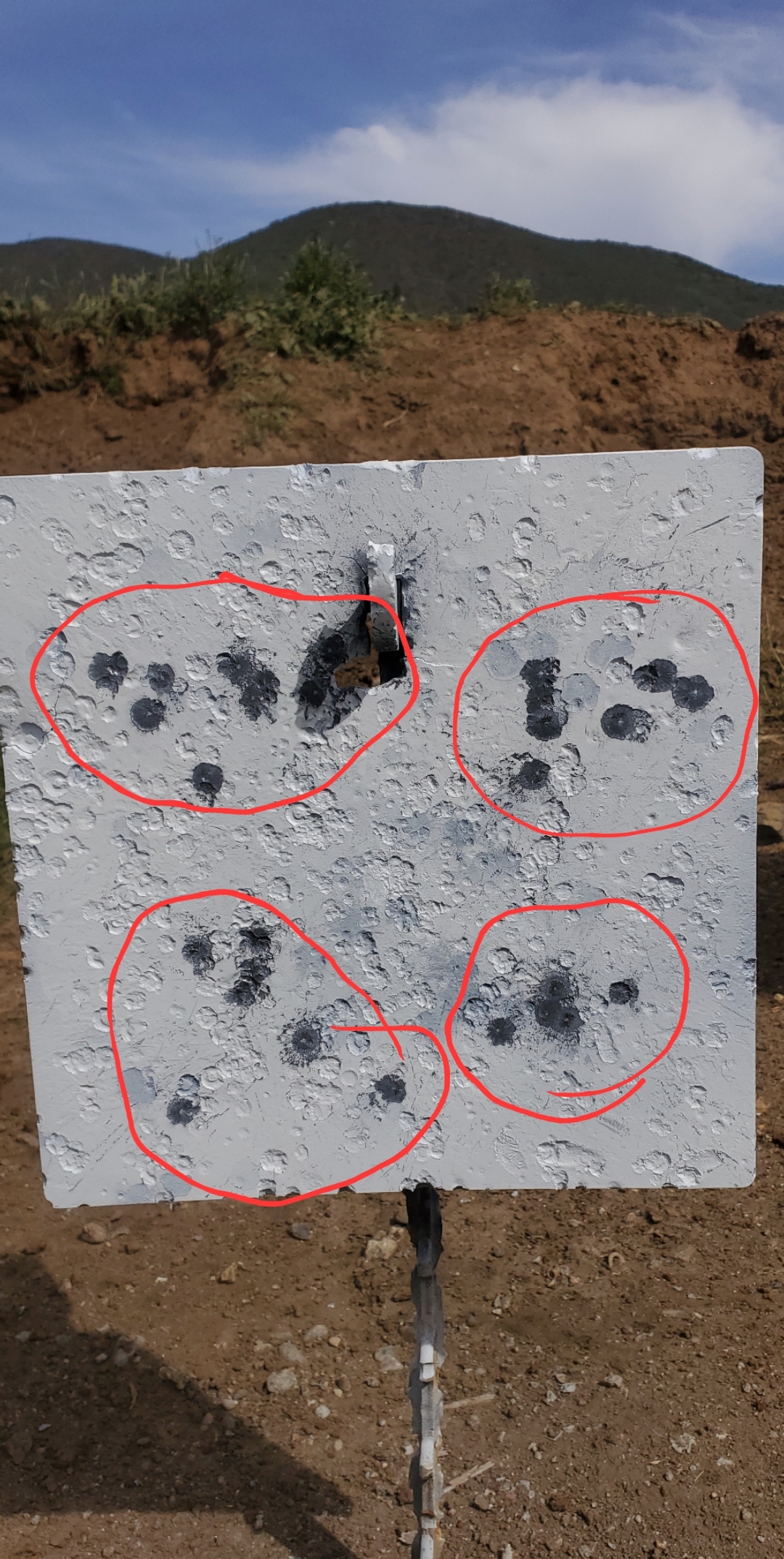

Boy, I really want these 60 gr Queens to work at 900 fps in my 700mm but they did not work with my earlier testing in a 700mm FX Superior Slug 20659. Coming into the weekend I remembered I had a old Slug A barrel in 600mm. I slapped that in my Ernest gun and got so so performance at 23 and 34 yards at home. I figure it was better than the 700mm performance I had the other week so I would take it on my range day. It did not do so good. About the best I could do was this at 100 yards
So of course the further you go out the worse it got. I was trying different speeds but I could not get below 850 very well without issues. Today I picked up a couple 600mm carbonfiber sleeves for the 700 to try but after reading the info that alteros mentioned above I could at least see what a stock mk2 could do as i kind of wondered what speed could i achieve with a stock mk2? Well the best speed I could get was about 765fps this is with a 25cal/Altaros 60gr queen/600mm/old slug a liner/stock mk2 / huma V2/ pin probe/ reg at 145. But more importantly the slugs are totally Stacking it in the yard at those speeds! Now I really want to go back out but maybe bump up the mk2 with a power block and power plenum 720, or a heavier weight hammer as I think this is maxed out speed wise for the hammer weight and reg pressure. Why is this so amazing to me? Well it's doing the same thing as the 22 cal 32.3 grain alteros slugs did at home (stacking them at short distances) and when i took it to the range they continued to stack them! Too bad I spent so much time on the 60 gr Queens Monday as they were not going to do anything for me at the range. But before I left there wasn't much time but I fired the .22 cal 32.3 alteros and got these at 100 yards. There was one flier in this group outside of the group you see.

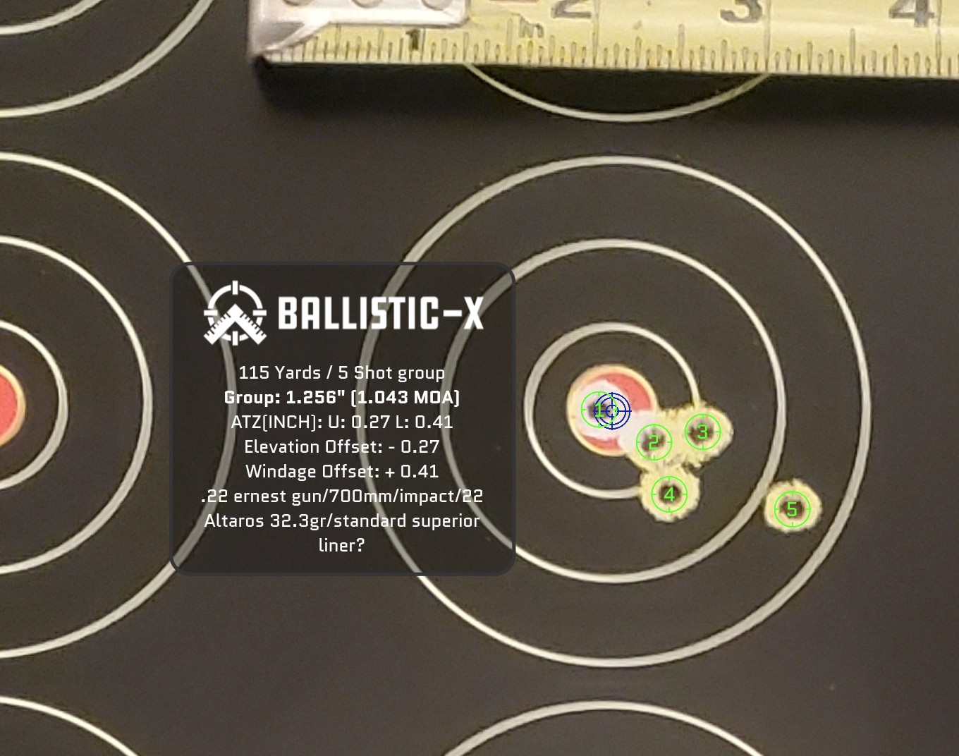

But since I was in a hurry to make a Dr appt back closer to home I was rushing it. Basically the gun was totally out shooting me at this point It was shooting where I was pointing.
Please Note again these two pictures above are not the 60gr Queens but some 32.3 gr Altaros in 22mm that I had some good luck testing at home. I uploaded what video I had of this, shaking a bit as i did not have enough height left in the rear bag. Turn volume down as there is powder burners shooting. Picture is reverse of above as it is from my sideshot cam which flips the image over.
