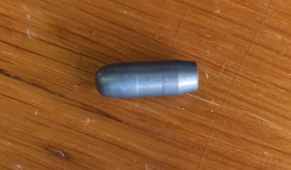

inserting them into the barrel is as easy as the 40gr ATP King .22, as they are practically no different from them. With the right technology (CNC machining) nothing is impossible, for example the relief (grove) between both ends, which is the only thing that adds to the resistance when inserting into the barrel. When this material is removed, there is practically no difference between the two bullets in terms of resistance to insertion into the barrel. Currently I shoot them 270 m/s 885 fps but soon we will be able to add on speed.

In my 700mm Panthera .25 without the Tungsten hammer I am able to shoot the 66gr Kings at 830fps. They are showing good accuracy so far, I only put one mag of them thru the gun so far. And I was able to get them to fit in Orions mags. I just sanded down the lip on the cover and they fit and work great in it. I just got the Tungsten hammer but have not installed it in my .25 yet.
But now they make the Queen, so there you go. Approx same BC, 60 grains and fits in mags without mods.

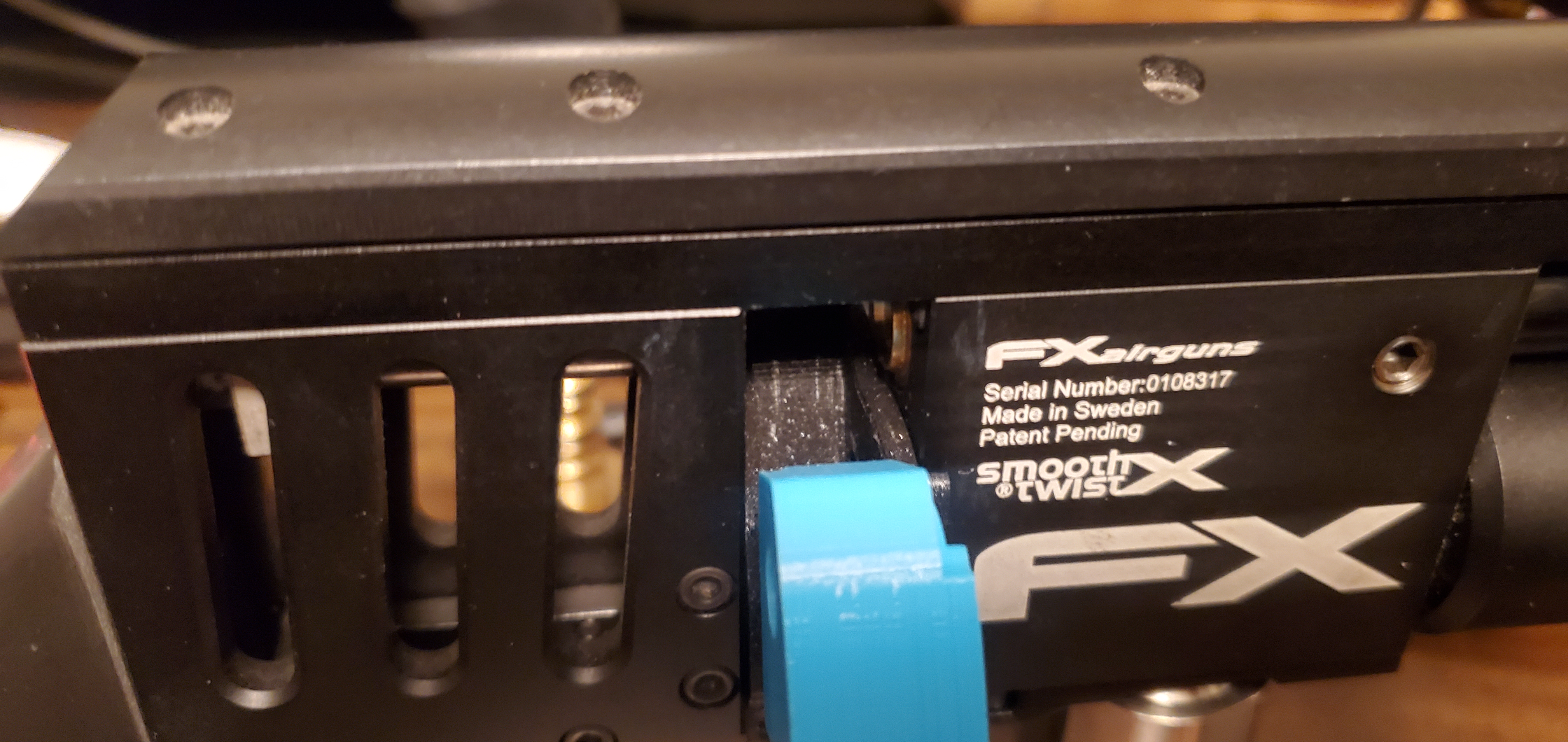

Have you measured to see how long of a slug would fit in your modified Orion mag?
Allen

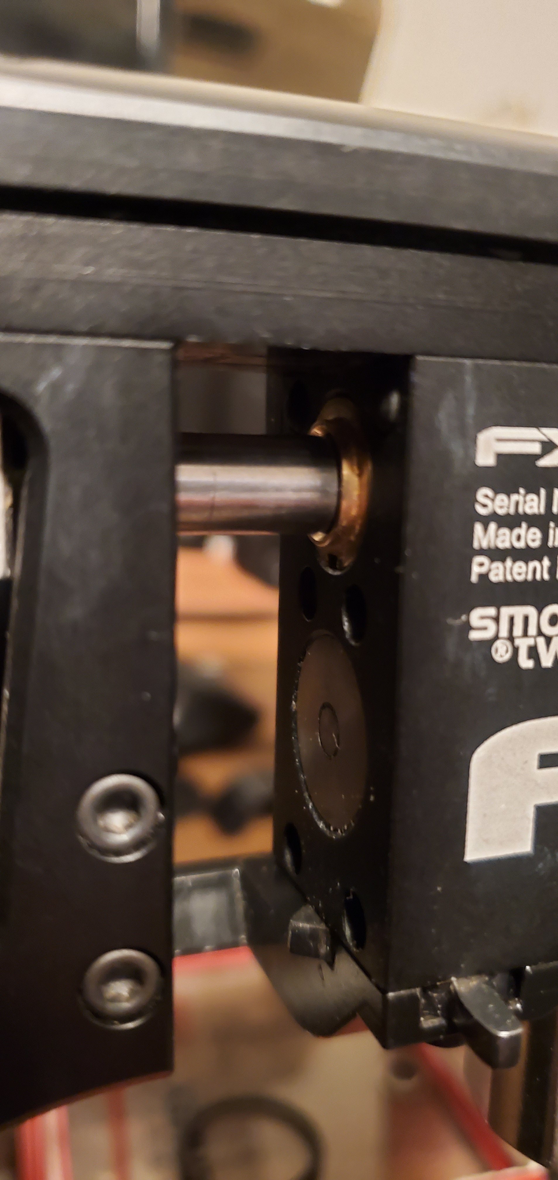

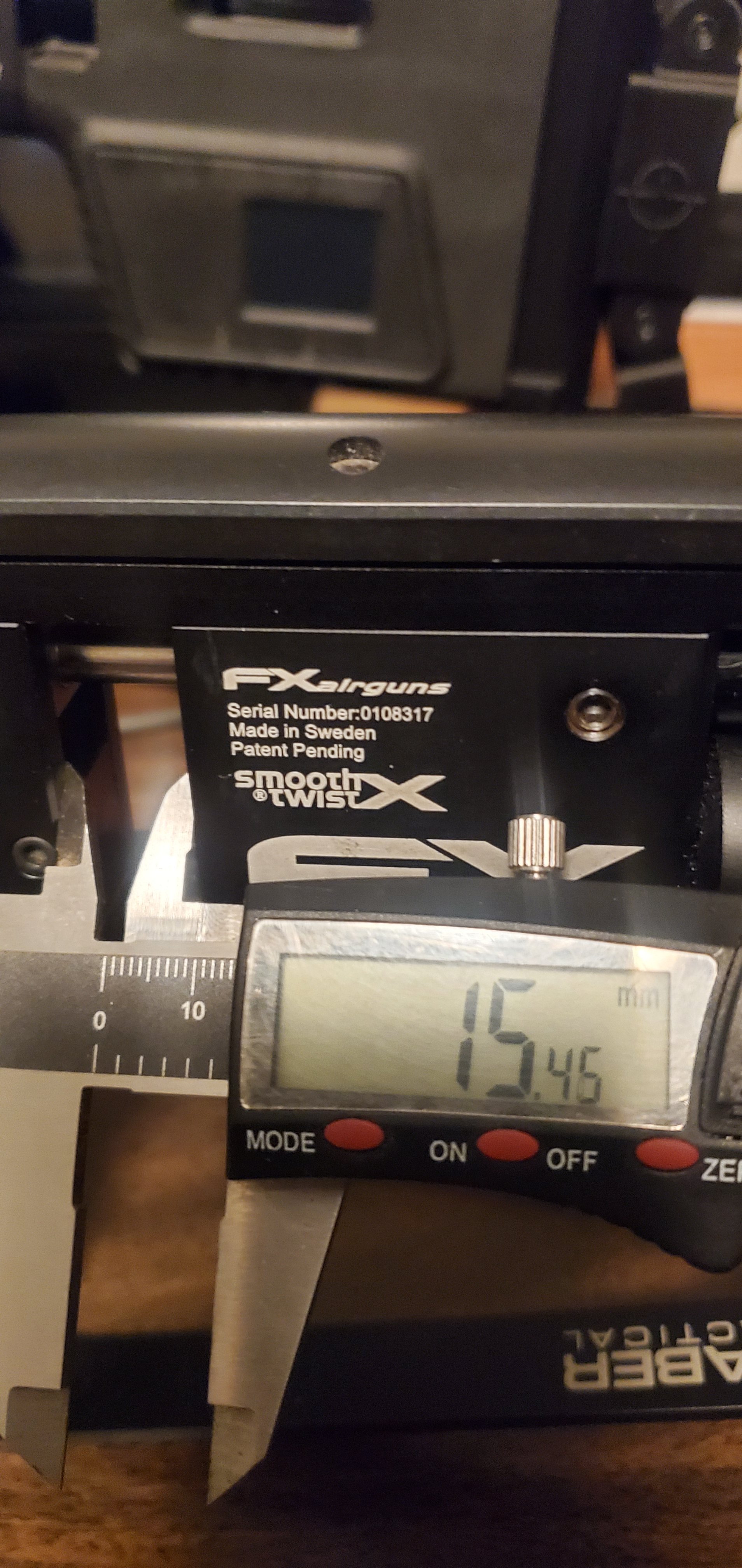

I just got home and I guess I was correct initially on the impact. It has a magazine opening of 15mm.
it's just that the ring on the transfer port that locates the magazine is almost a whole mm thick. Probably could notch that on the side if necessary.
So using a single shot loader I could probably get a 14mm slug in without notching the locating ring.
Allen
