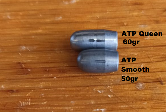

I would like to add some knowledge. comparing ATP 50gr slugs and ATP 60gr Qeen slugs according to the G1 ballistic coefficient is not quite the best.
We primarily present the BC G1 function because most airgun shooters didn't even know what the ballistic coefficient was until a few years ago, so we don't want them to have information about the G7 function as they would have even more confusion. But the truth is that our slugs, thanks to the boat tail (BT) end, correspond much better to the function of the G7 for the ballistic coefficient.
This is much better to see at distace 300 meters and more, where the G1 gives very unrealistic results compared to the G7 function. On the contrary, the G7 usually is +- corect even at +1000m and more.
In real shooting, when it is a bit windy, for example even at 250m, I can tell very well whether I am shooting with .22 ATP King 40gr or .25 ATP 50gr or ATP King 67gr or ATP Queen 60gr.
The second advantage of heavier bullets is greater accuracy, as they are better guided in the barrel. The length of the slug in the barrel for 60 or 67 gr is guided at the beginning at the BT and then along the groove at the end at the beginning of the slug head.
The difference is not small, ATP Smooth 50gr is guided in a groove of approximately 2.7mm, while ATP Queen 60gr is guided in a groove of 4.3mm, which is almost 40% longer guidance and the bullet is thus better stabilized.
Personally, I primarily shot .25 ATP King 67gr, but am now switching to ATP Queen 60gr as I get a little extra velocity and don't lose much BC
Wind is always the alpha and omega of my shooting. Moreover, at medium distances (300-600m), the effect of higher BC is cumulative, as the bullet does not lose that much speed, so the difference in wind deviation is then even greater than the pure % BC difference between slugs.
This does not mean that ATP Smooth 50gr are bad. The truth is that they are certainly the most versatile for many more rifles than the heavier .25 Queen or King. But if I have the opportunity to get enough power, then these 60gr have their place on the market and especially for barrels other than FX, which may not be ideally suited to the short lead of the slug in the barrel.
For .22 caliber it's simple, here I choose ATP King 40gr.
