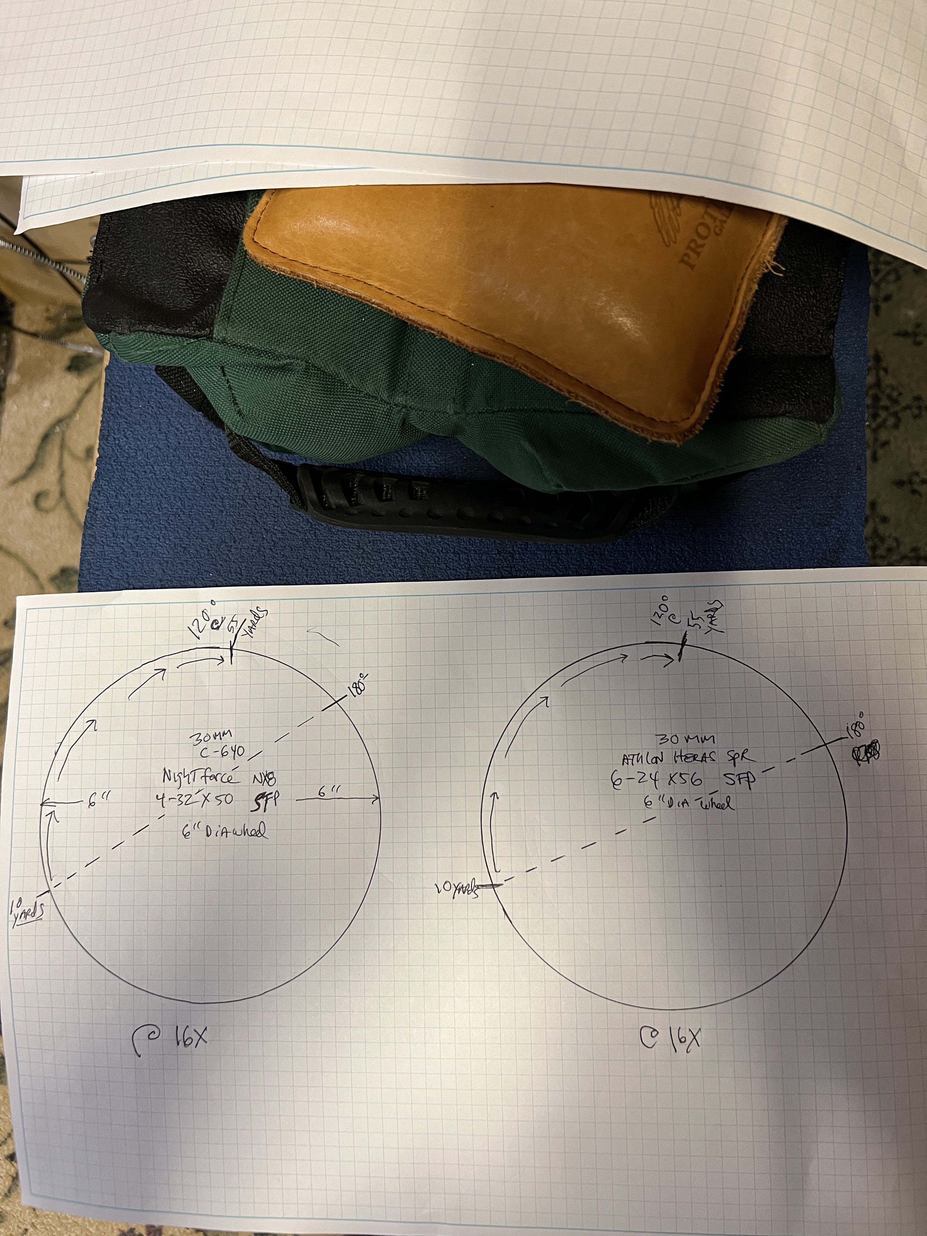

I have this Heras SPR 6-24x56 scope in both FFP and SFP and when set at 16x I can’t discern any difference in the reticle size.
For the SFP I Recommend a 6” round magnetic parallax wheel to get 120 degrees spread on the wheel while the FFP will only get 110 degrees
