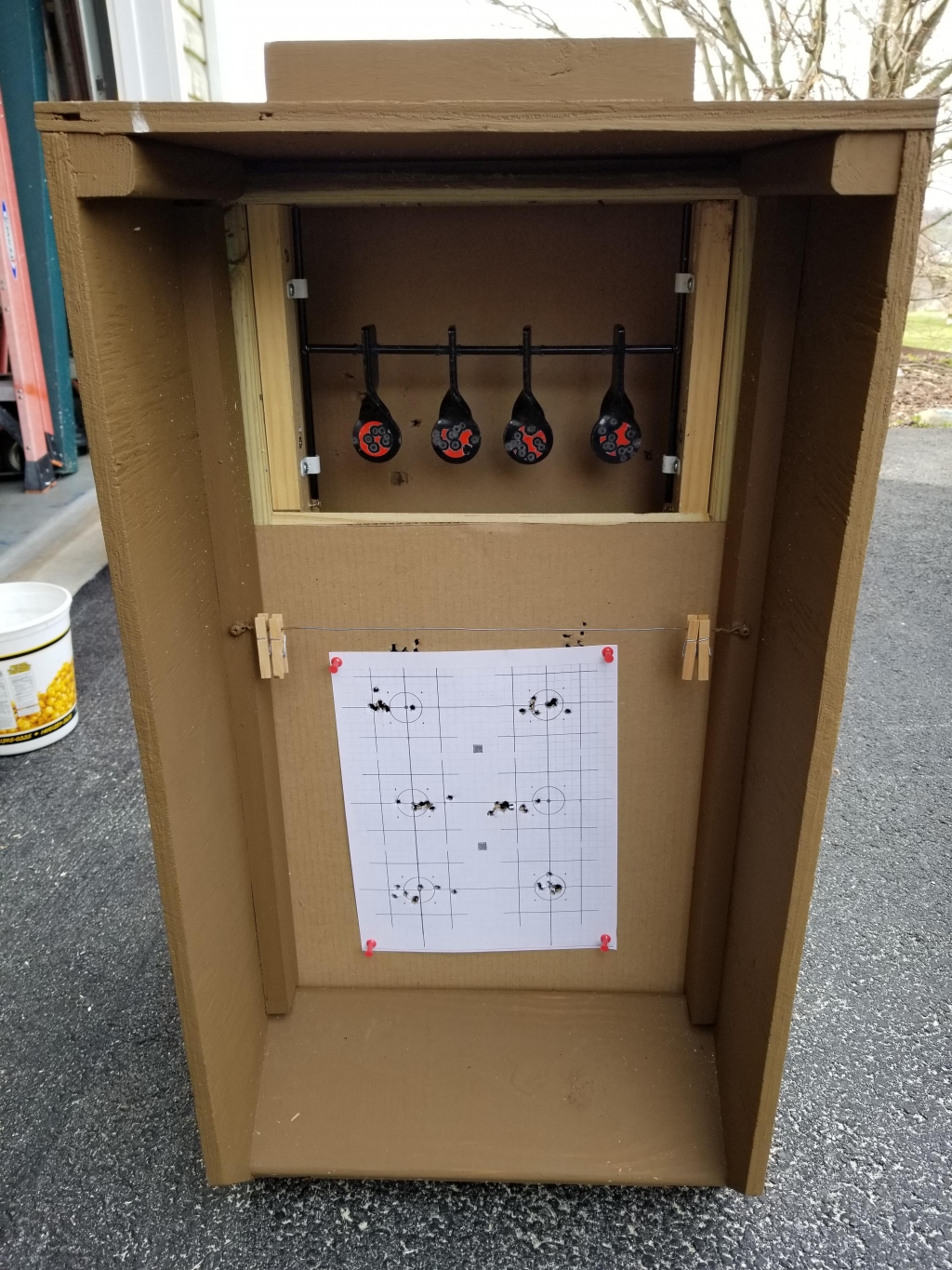

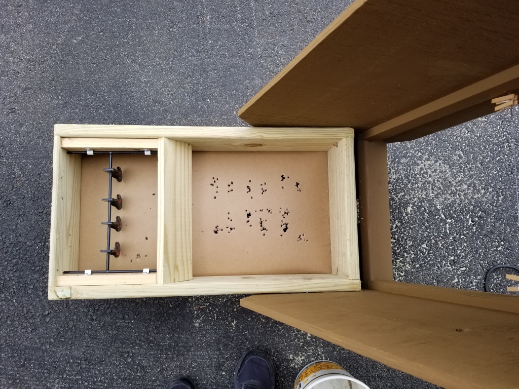

Finding myself with extra time on my hands I set out to "build a better mouse trap". I wanted the new trap to include 4 things: 1- metal spinners. 2- capture the lead from the spinners and any rubber that falls from the trap. 3- easy to change cardboard. 4- some protection of the cardboard target face from the weather.

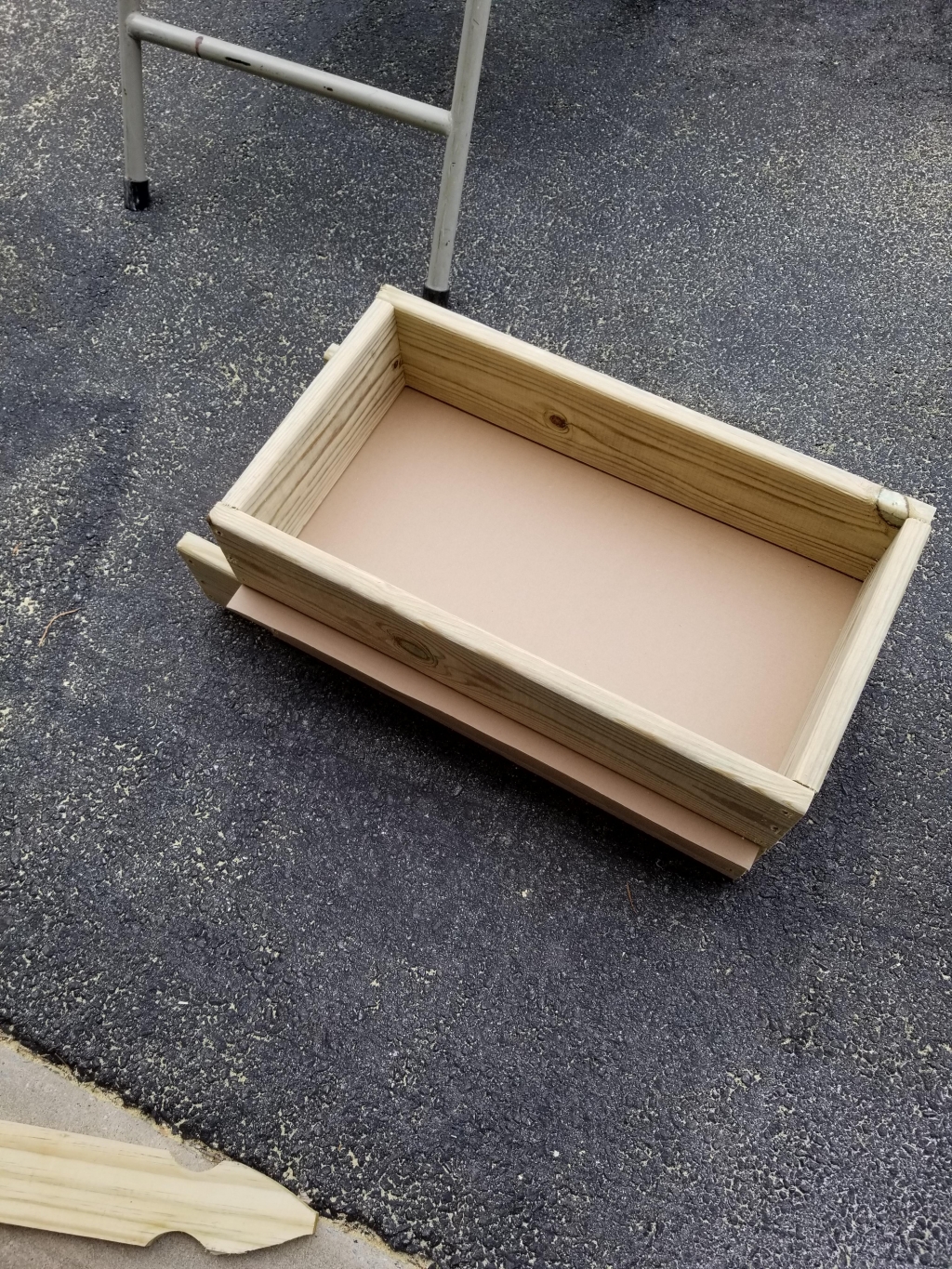

I did not need a lot of depth to the mulch since I was using mulch from my old trap that was heavily laden with spent lead. The mulch box is framed with 1x6 deck boards and backed with 3/4 plywood.
I then made a second box slightly larger than the first.

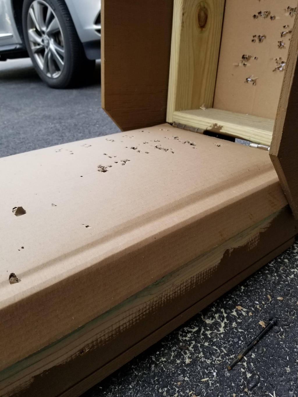

These two boxes are hinged together at this end (bottom). The bottom box is filled with mulch and covered with a piece of cardboard that is a few inches bigger than the box.

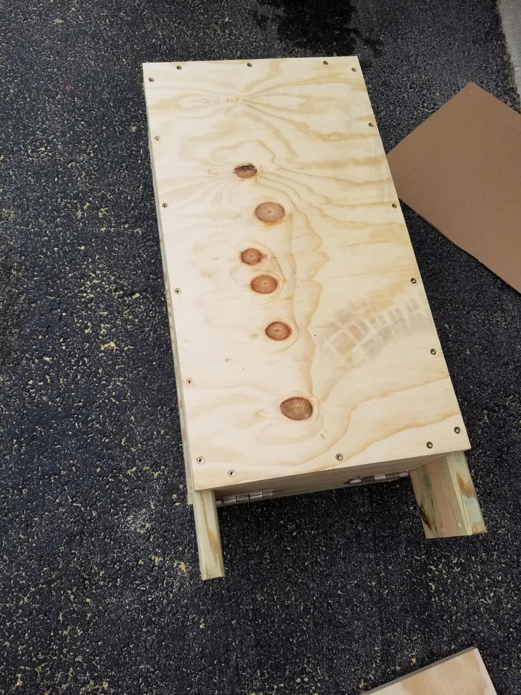

I then added a plywood shell that pivots off of the mulch box and covers and overhangs both boxes. This shell helps to keep the rain out and holds the two boxes together pinching the cardboard in place. When the shell is pivoted closed it wraps the excess cardboard around the sides of the mulch box.

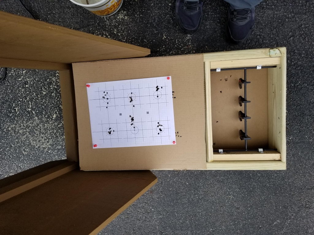

I then put a second piece of cardboard over the top "spacer" box. This piece is where the target paper goes and catches behind it the lead from the spinners overtop and any loose mulch pieces.
The outer target cardboard is held in place by trim pieces around the inside of the outer plywood shell.

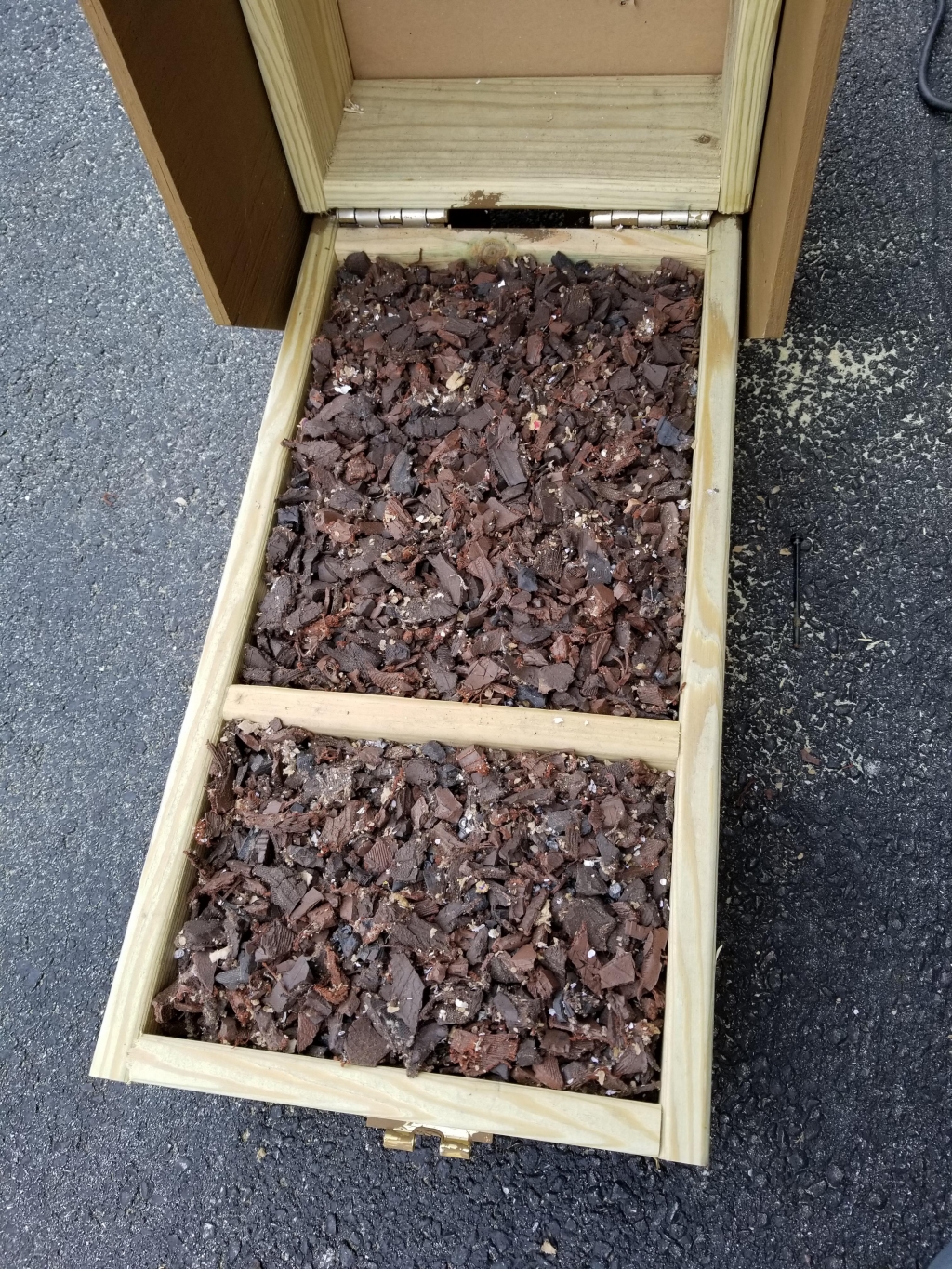

As you can see in the 8th photo, with such a large target face the mulch tends to bulge the cardboard as it settles (reason for over sizing that piece). This also left a bit of a mulch gap at the top where the spinners are. To correct this I added a divider between the upper and lower halves of the mulch box.
Yeah, I know this is a bit of overkill and a bucket will work just fine. Sometimes I get an idea and jump into the deep end. Lol. (I do have a bucket trap also) The last picture also shows 1/2 of the latch that holds it closed - a door hinge with a easy to remove nail instead of the pin. All built with scrap except needing one deck board ($8).

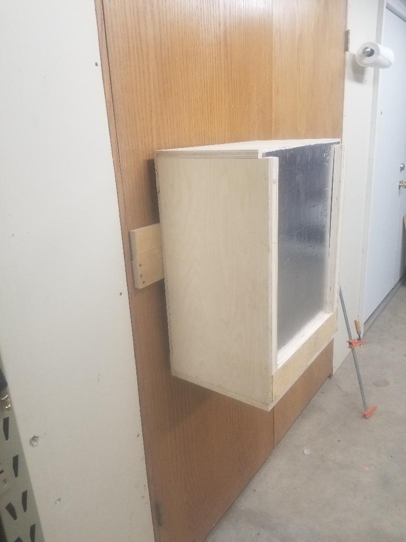

By the way, I used at an old corrugated plastic voting sign for the front of mine. I applied foil tape perpendicular to the corrugations, It really stiffens up the front and makes it last longer and easier to repair with small strips of tape. You can buy sign blanks online pretty cheap if rain is still a problem.
My trap hangs from a French cleat so I just lift the trap off the cleat and lay it on its back to slide the front out. It's probably going to be a two person job the next time I have to do it with the weight of the lead.
My trap is 24" tall and is full in this picture. You can see it's not bulging in this picture. It's bulging much worse now but is still holding the mulch.

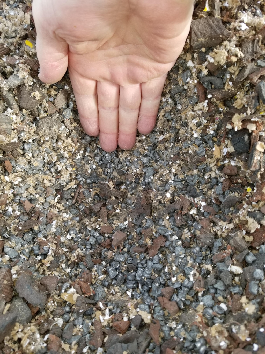

Thanks guys. Scouty, my first one is similar to yours. I also made my first one around 12 inches deep. After using it for some time I dug into the mulch and found that much depth was not necessary.

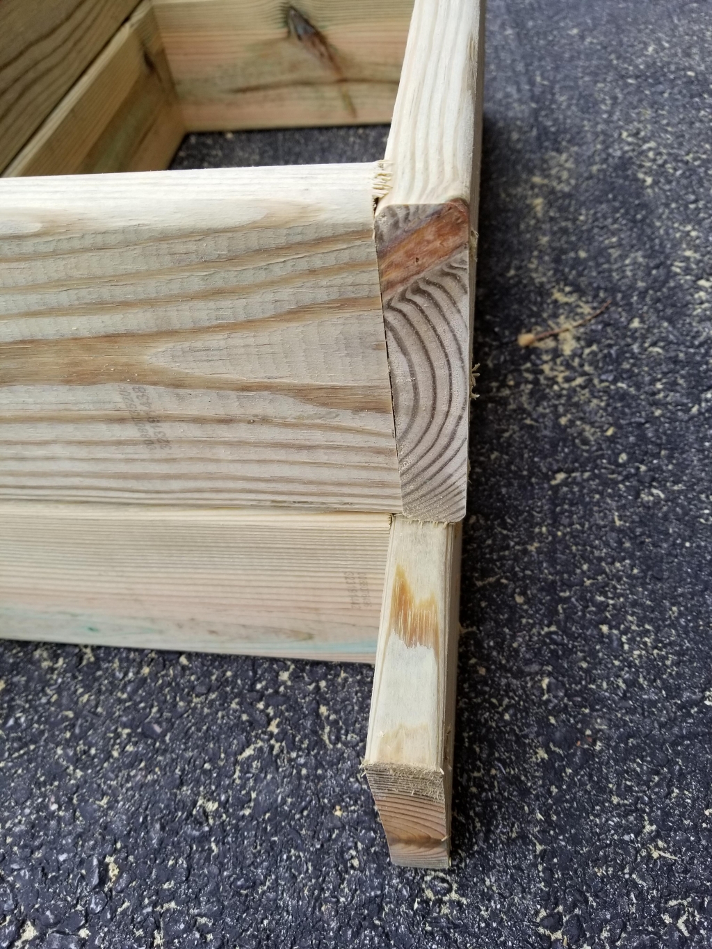

Cea1960, I move mine with a dolly also. In the fourth photo the longer piece of decking on the bottom box is one of the back legs of the trap. You could put an axle with wheels on these and add a handle = portability.

It is actually pretty laden with lead now. I decided to keep using the same mulch. I figured I could use less depth of mulch with the lead filled mulch.
The trap is weighted towards the back which makes it easier to lay it down for cardboard changes (I put a handle on top). I might add a long handle to the back sticking up. This would make it super easy to lay down and could also be a place to put a wind flag. When I swapped the mulch over from my old trap I used a wet dry vac to suck it up then just dumped it into the new one. Easy.
