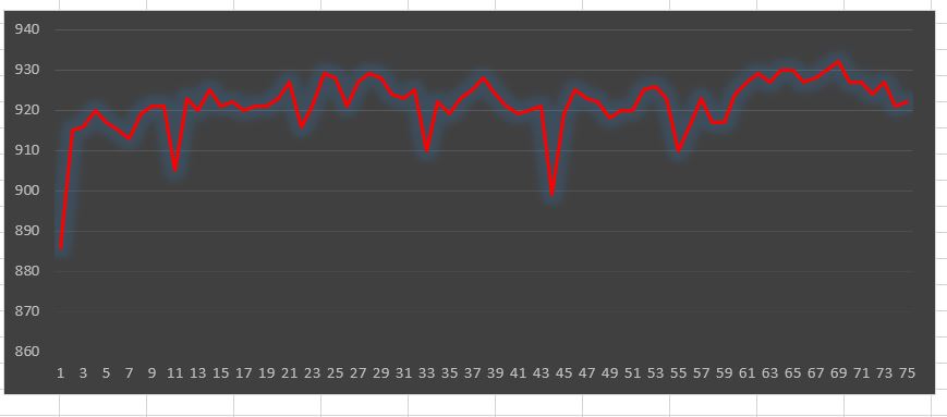

Something I did notice that seems odd. On the shot string of 88, every 11th shot is a few FPS lower than the other 10. I don't know if it falls as the first shot of the mag, or the last. But you can look at the entire shot string and see it plain as day.
Crusher
That graph looks -at least for me- like a hst maxed out or near to be. Too much hst will mess up your ES and decrease you average velocity, i don't think that will solve your POI shift problem tho but at least you can improove your consistency. Back out your hst adjuster and try again, remember a brand new reg may need quite some shots to settle down too.

"Menttaliist"That graph looks -at least for me- like a hst maxed out or near to be. Too much hst will mess up your ES and decrease you average velocity, i don't think that will solve your POI shift problem tho but at least you can improove your consistency. Back out your hst adjuster and try again, remember a brand new reg may need quite some shots to settle down too.

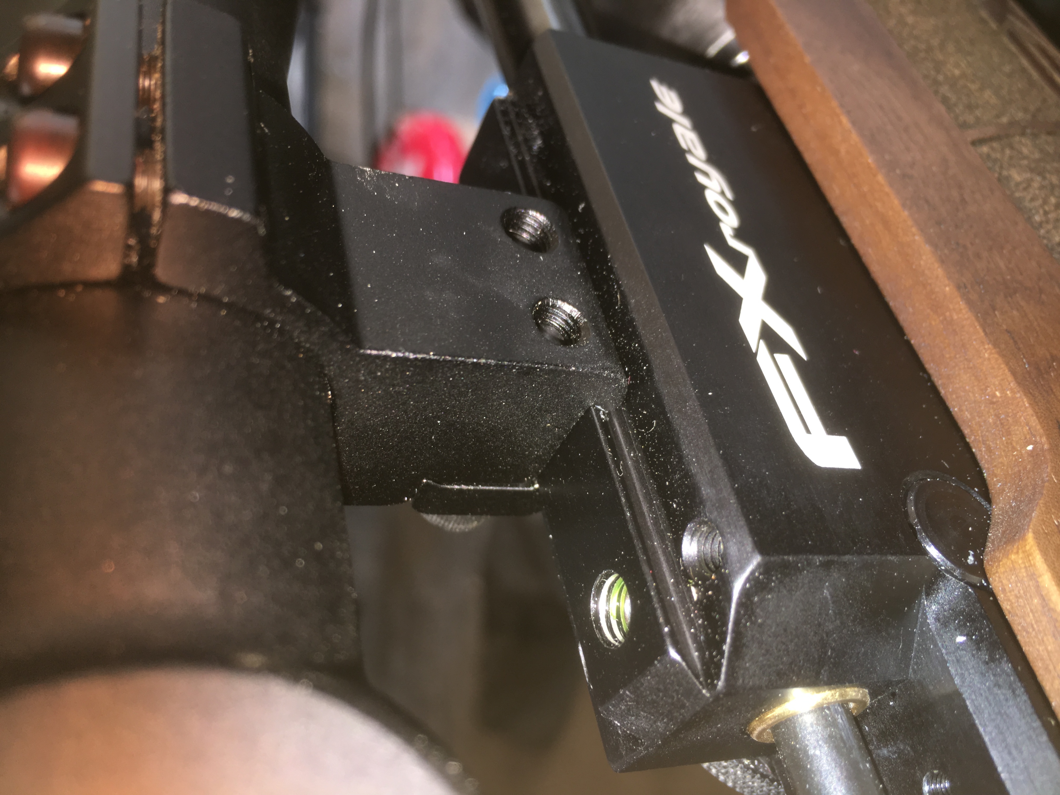

So while I was going to remove and replace the scope anyway, I just thought I would put a wrench in every bolt just to recheck and be sure. The two bolts that hold the barrel near the front of the block were tight. However, when I put the wrench in the back hole closest to the breech, it was LOOSE! I can't believe it. I thought I checked that when I got the gun. So I turned it about 5 turns down and it met up with the barrel and then I snugged it.
This hole here:
That made a MAJOR difference. So. Since that was tightened up last, I'm thinking, should I loosen all three, then snug the back one first, then tighten the other two front screws? My old hot rod building days are reminding me that tighten sequence can matter. So does it matter here?

I don't think the bolt tightening sequence will do any differences, what i normally do is tight the two in the front first and then the one on the back. The ones on the front can be a little bit more tight than the other one since that one is pushing the brass part on the barrel and you don't want to apply too much force in there.
Let us know if that was your issue, and keep in mind what i told you regarding your HST ;)

Your suggestion (and a couple others) to check those hex heads AGAIN is what made me think about just taking the scope off and give the front 2 a check. When I received the gun, AoA had installed the scope already and I didn't want to have to re-zero it. I remember that now and that is the reason I skipped checking these 3 screws... Duh....
