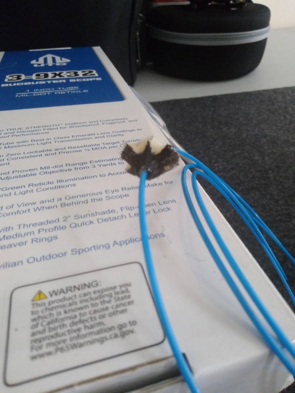

This was the first patch run through my new Hatsan Airtact the other day, right out of the box. A refurb from Hatsan, not a high-end gun obviously. But I was a little surprised at how dirty the barrel was. Took about a dozen patches to start getting some relatively clean ones.
