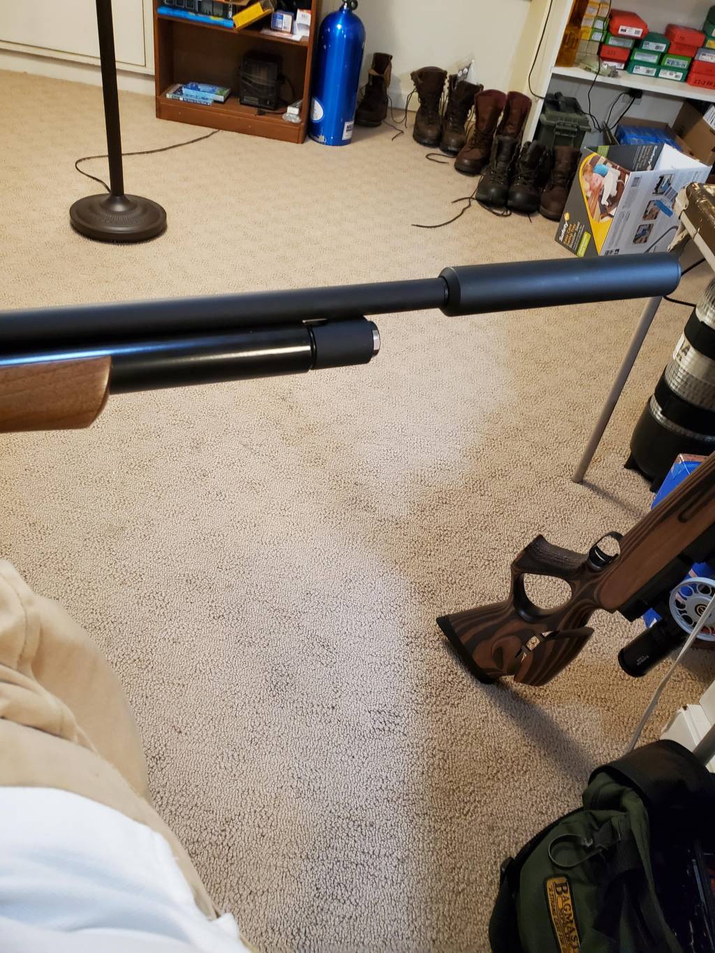

I am using a large O ring for that purpose. It doesn't look as professional as I imagine yours looks, and it doesn't totally cover the gap. The dust cover pushes down a little lower, and needs to be moved forward a little to access the probe port. But, it serves the purpose. I've shot about 50 pellets with the band removed, and it seems unaffected.
I received a response from the US reseller, who stated the barrel is designed to be free floated, and his suggestion, either shim the shroud under the band, or just remove the band. Each rifle is different, but in my case, I think the better option is to remove the band. As I see it, the problem is the shroud, because you can't really monitor the barrel, which is hidden under there. The shroud could be in a bind, and yet the barrel still freely floating. And conversely, the shroud could appear free of any pressure, yet the barrel may not be. If someone wanted to invest the time, I think the best option is to remove the shroud and the band, and attach a press-on adapter to the muzzle for the silencer (you don't want to thread it). But, useless as it may be, the shroud Is a marketing point for them, and marketing usually trumps engineering (maybe not in Germany).
This is my current fix, working well so far.

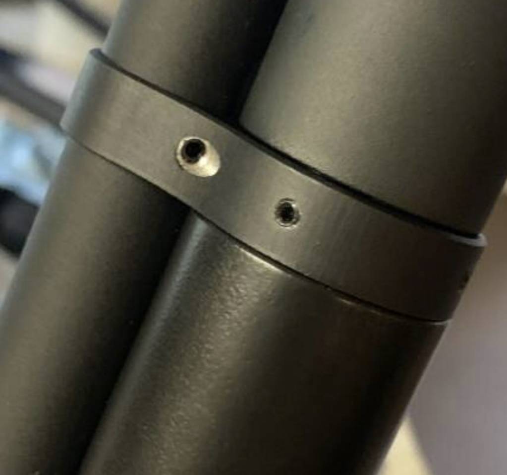

To @kenfoerst comment... overall I don't know if perhaps in these new/recent batches of Reveres, Daystate is using a different air tube than ones in the recent past, however this was one thing I found different between the Revere I return (due to this and other minor QC issues) vs my good one in this picture.

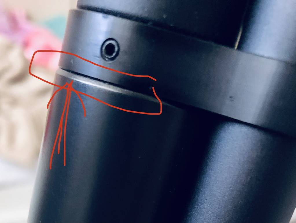

At the end of the tube (again my older, problem free Revere, in this pic) there is a slight bevel at where it then touches the band. On the one I returned, its ends at almost a 90degree angle. Again no idea if it is a contributing factor other than the difference I noticed.
