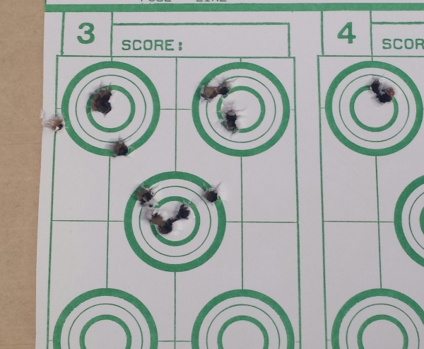

Update on the Red Wolf......it ain't fixed. Here are groups I shot this morning at 25 yards, seated with bipod. The three on the left are the Red Wolf. At that point I was beginning to question whether I can shoot! So, I shot the group on the right with my FX Crown. It appears this RW barrel has issues I can't fix. The folks at AOA are sending me a new barrel to try, so at least I can determine for sure that the barrel is the problem.

Those groups are appalling for 25 yards. Correct me if I'm wrong, but they're well over an inch yes? I had a garbage Benjamin nitro piston breakbarrel which shot better than that off-hand no matter how I held it. I'm not sure your barrel is likely responsible for that, unless it is physically loose in the gun, since being off by that much wouldn't be missed. Your barrel isn't likely to shed its crown or grow a burr or something. That looks bad enough to me to potentially be clipping in your moderator or something else dramatic. *shrug*
