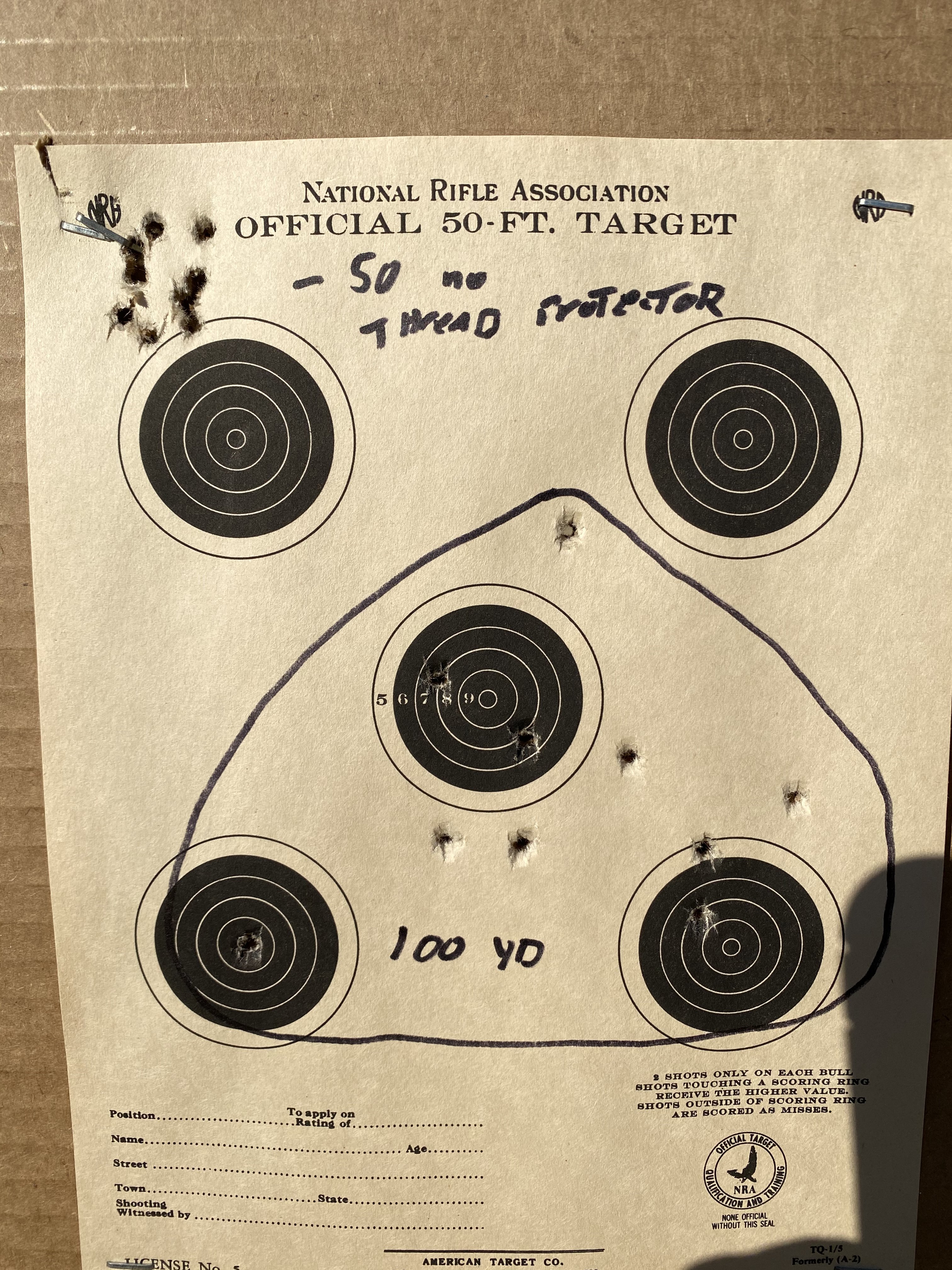

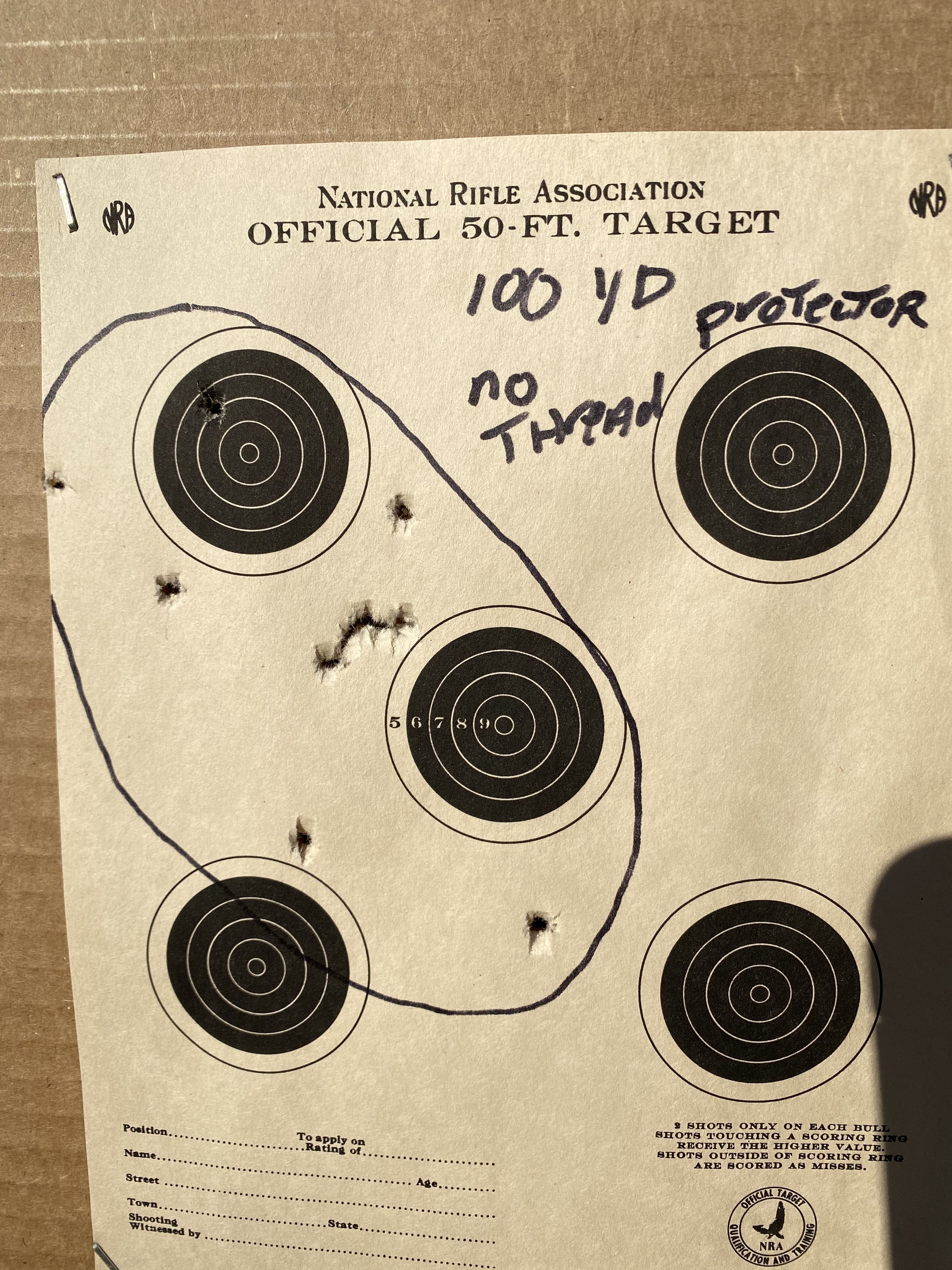

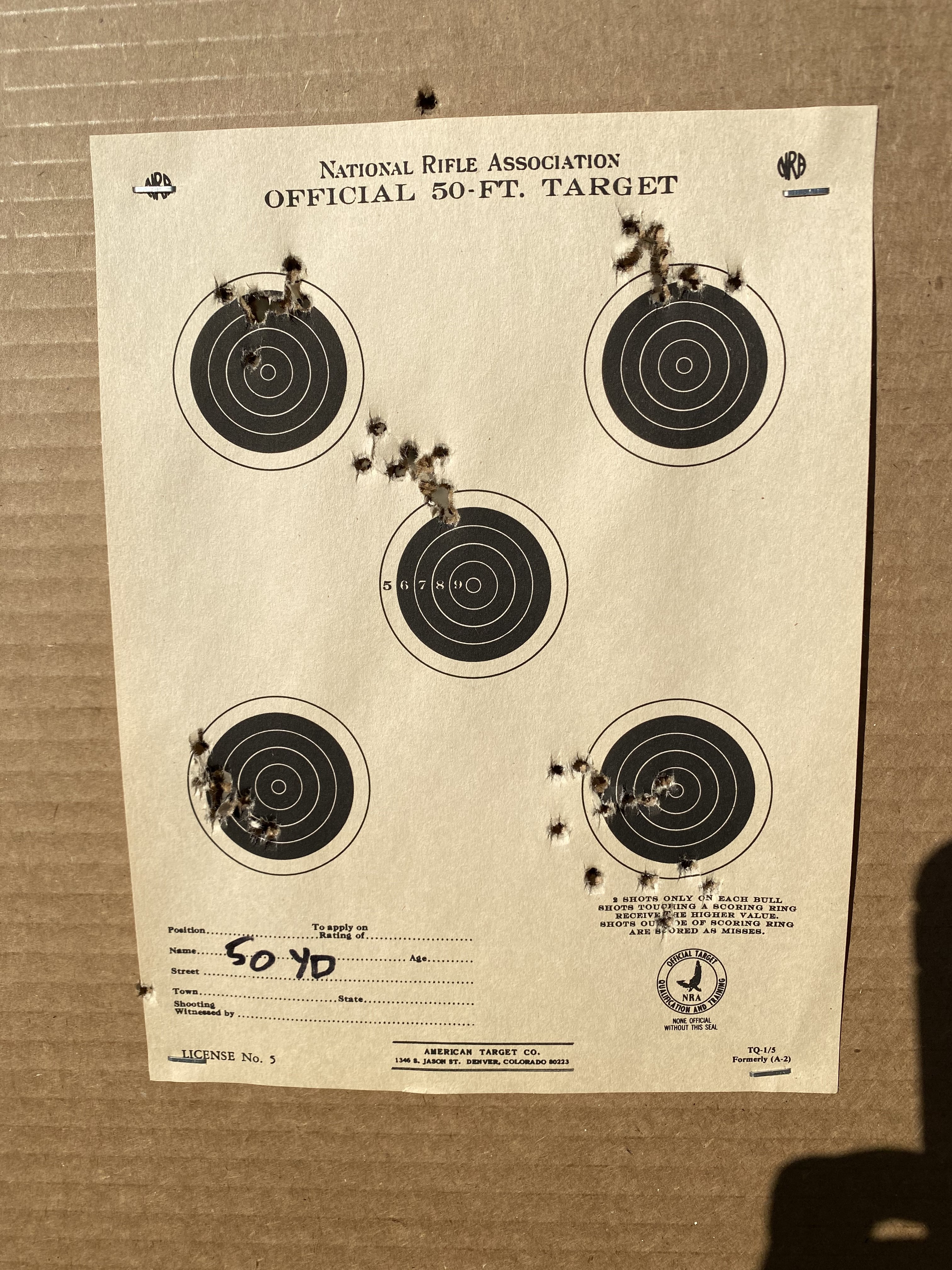

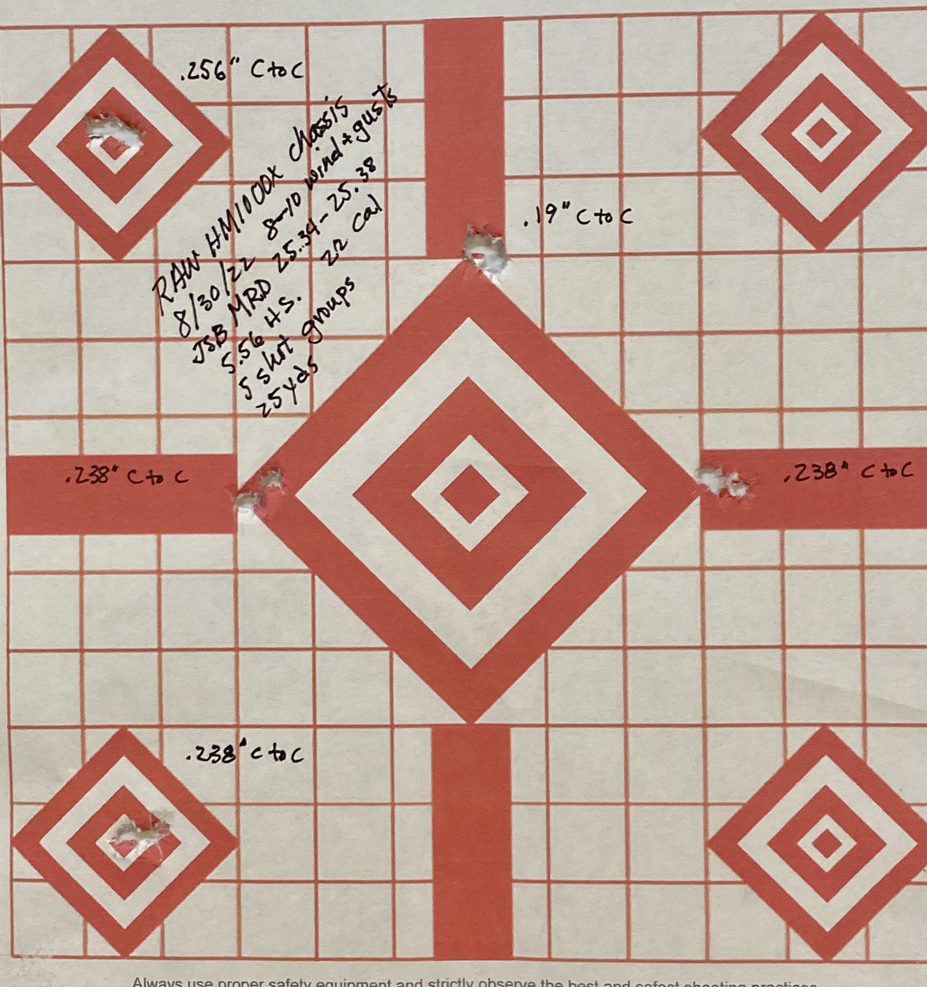

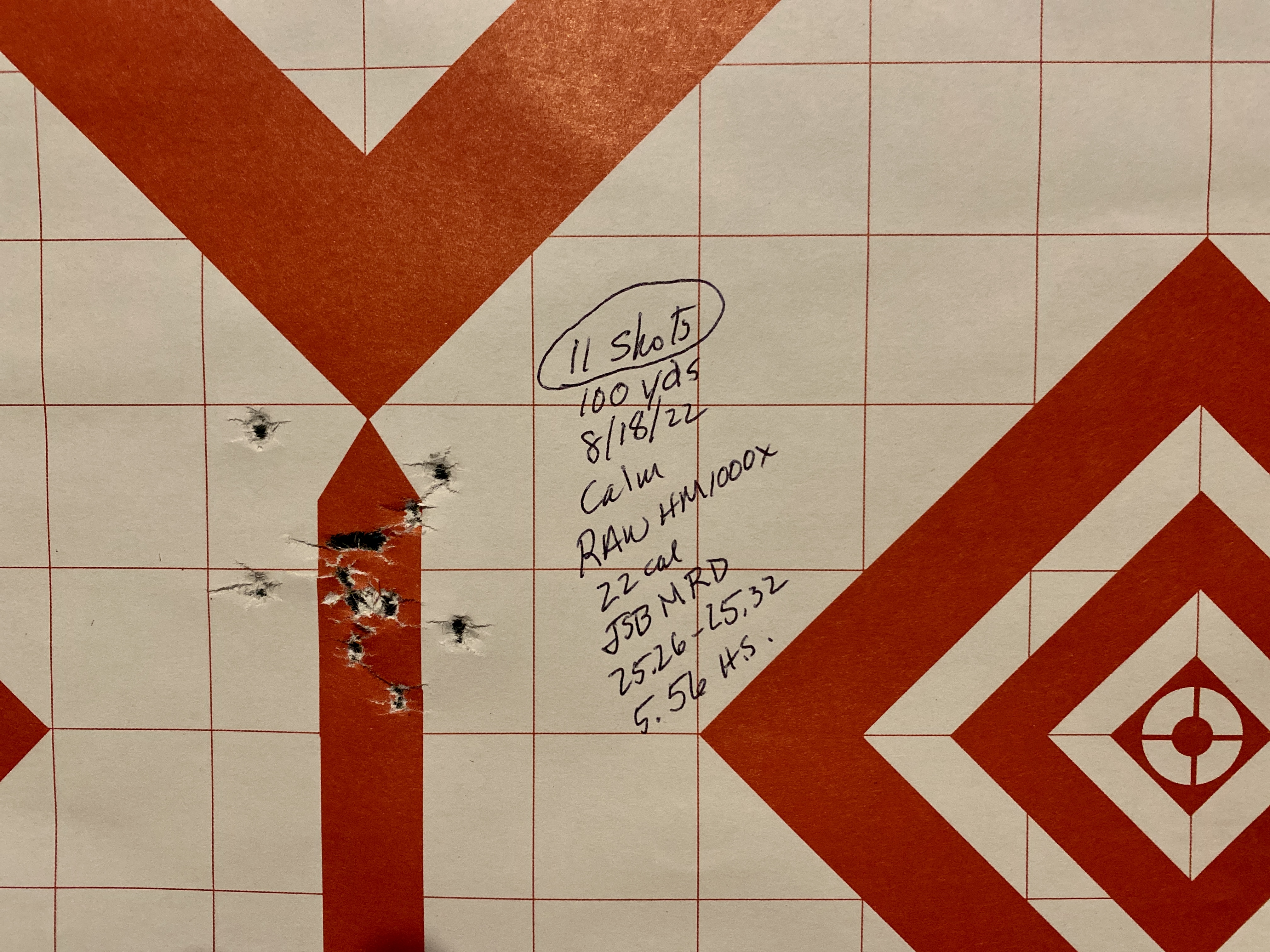

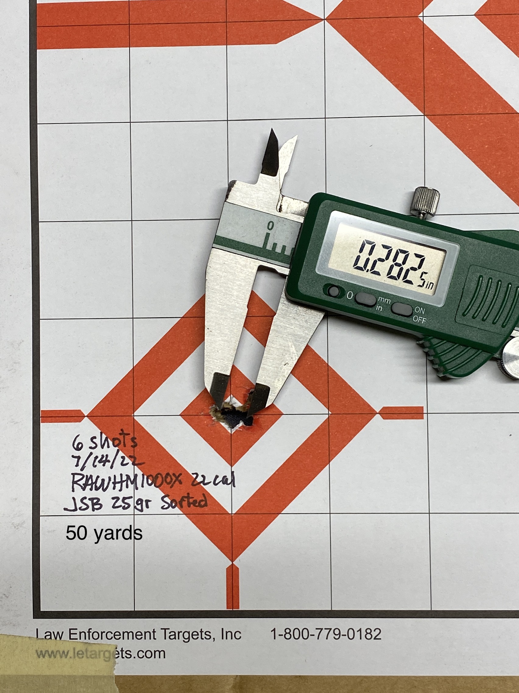

Just to jump in here again, I doubt there is anything going on with the barrel. I wouldn't go scrubbing the barrel if it were mine. I have proven to myself that the RAW needs a moderator if for no other reason than to strip the turbulent air off the pellet as it leaves barrel. That's what the original giant muffler on the older RAWs did. Having said all this, there may be another factor to consider — 22 cal is not at it's best at 100 yards. Start at 25-30 and see what it does with weight sorted and head sorted pellets. Then move to 50 and see what it does. Here are a couple targets to illustrate. First 25 yard with teeny groups then 50 with larger, but still sub moa groups. Lastly 100 yards. These were shot on different days, but all under ideal wind and weather conditions.
View attachment 307687View attachment 307689View attachment 307688
It’s not that I was expecting to shoot quarter sized groups at 100 with pellets, but I kinda was expecting to hit the paper.

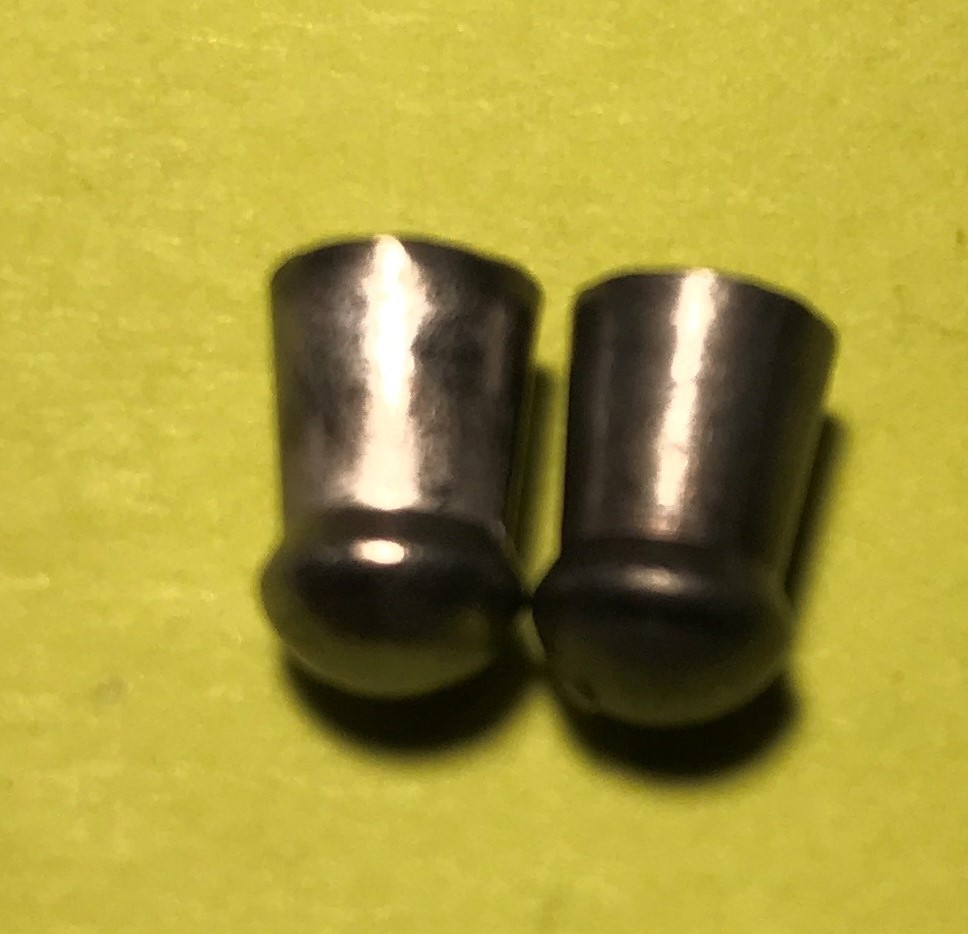

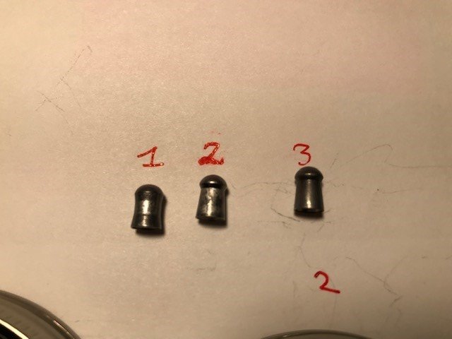

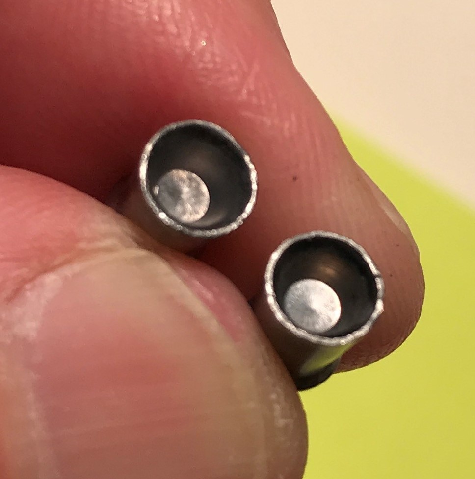

Not great pictures, but hope it helps somehow.

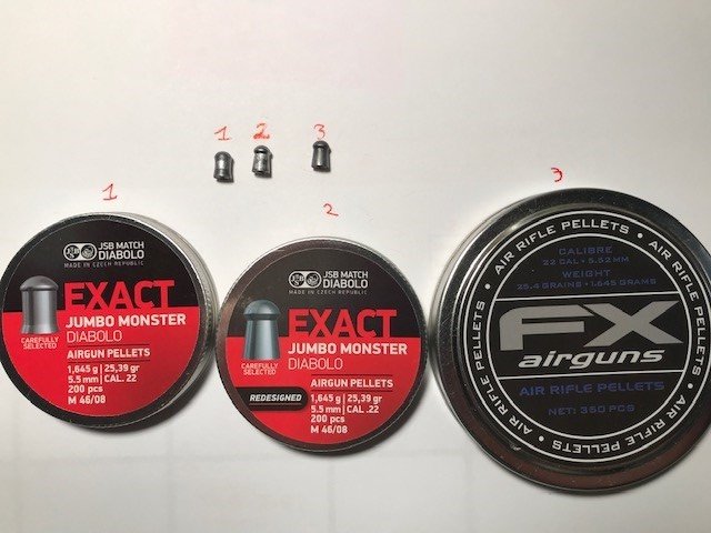

No. 1 is the Jumbo Monster Diabolo (NOT Redesigned) 25.39
No. 2 is the Jumbo Monster Redesigned 25.39
No. 3 is the FX 25.4 pellet
