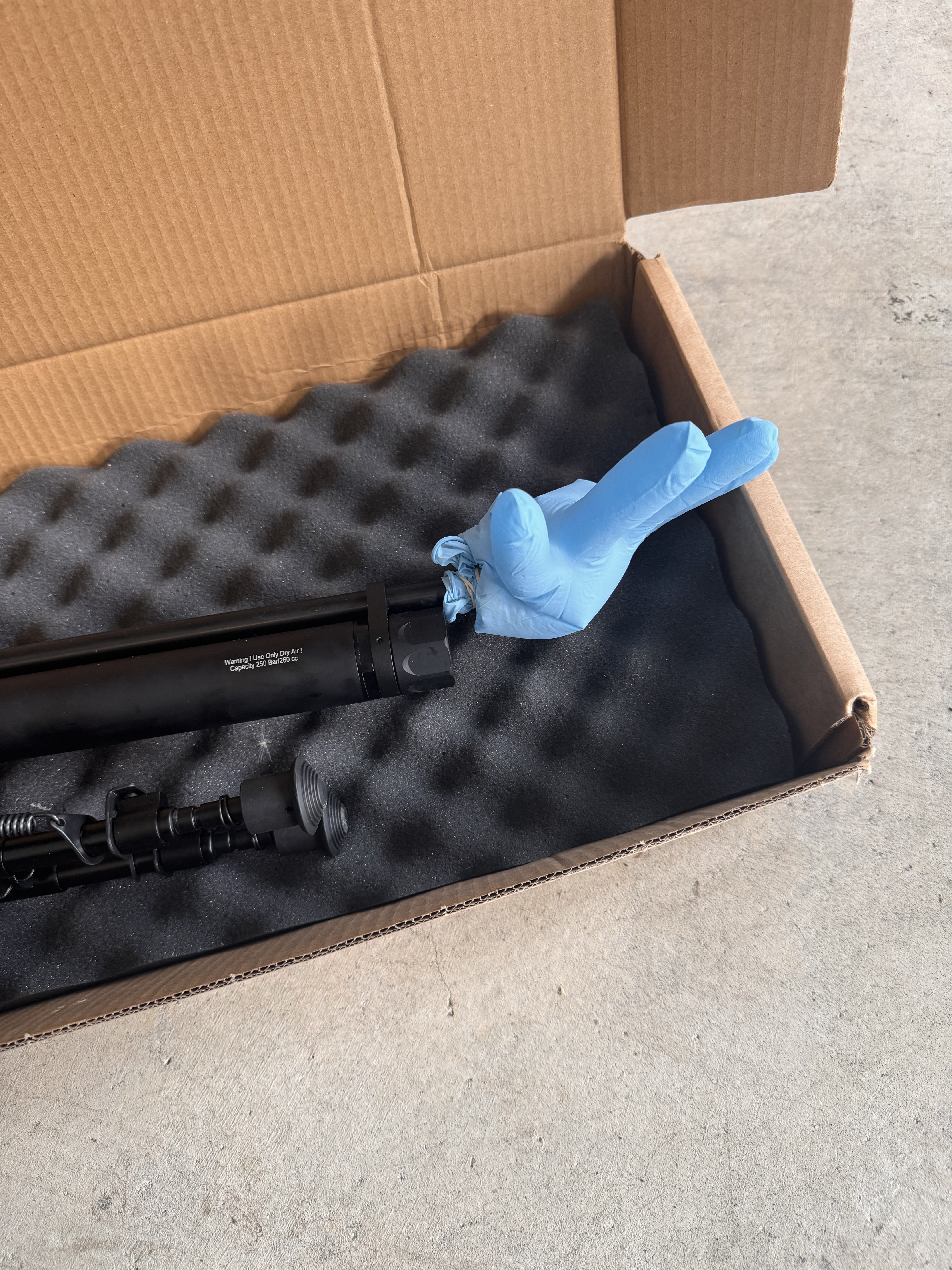

soapy water on anything that looks like it can leak and put a ballon on the barrel, if the soap doesn't show anything. You have a serious leak, it'll show up fast.

Balloon is a great idea.. I lost 50 BAR overnight after tightening the fill port, so maybe it slowed down. I will take valve off as well and see.
Thanks for the advice. If its not the fill port then must be something internal as the act of firing and filling made it leak as it sat on my bench for a week before mounting the scope without loosing a single BAR of air.
Mike
Looks like leaking out of barrell
Mike
IMHO, Most likely it is a valve seat causing the leak. Were it my gun, I would access the valve pin and attach a spinning device (electric drill). Hold pressure against the valve seat and spin the heck out of the pin to smooth out the seat.
